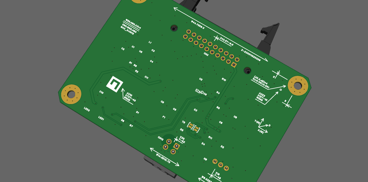

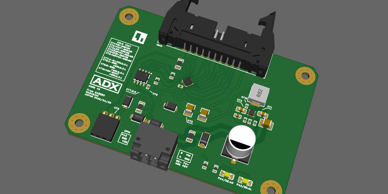

• ADX Core V0 Design Freeze and PCBA Order Placed
    Masahiro Furukawa04/30/2026 at 15:16 0 comments
    Progress Report: ADX Core V0 Design Freeze and PCBA Order Placed
    The design phase for the ADX Core V0 is officially complete. I have finalized the schematics and PCB layout, and the project has moved into the manufacturing stage. The PCBA (Printed Circuit Board Assembly) order has been placed with JLCPCB.
    Status Update
    • Schematics: Completed
    • PCB Layout: Completed
    • Manufacturing: In progress (Ordered via JLCPCB PCBA service)
    • Target Grade: Industrial / Robust Control
    Project Resources & Documentation
    All design files, fabrication data (Gerbers, BOM, CPL), and detailed development history are available on GitHub:
    Repository:
  • https://github.com/Masafuro/ADX/
    Note: The repository contains documentation and commit messages in a mix of English and Japanese.
    Hardware Specifications
    The ADX Core V0 is designed as an "Arduino-like" industrial control board. It introduces a new, standardized industrial form factor—inspired by the ATX philosophy—aimed at creating an ecosystem where enclosures and components are easily interchangeable and professional.
    1. Performance Specifications
    ItemSpecificationNotes
    MCUMicrochip ATtiny1616-MNR8-bit AVR® megaAVR 0-series
    Clock Speed20 MHz (16 MHz recommended)Internal clock
    Logic Voltage5 V
    MemoryFlash 16 KB / SRAM 2 KB / EEPROM 256 B
    Operating Temp-40°C to +105°CIndustrial grade components
    2. Power & Protection
    ItemSpecificationNotes
    Nominal InputDC 12 V / 24 V / 48 V systems
    Input RangeDC 7.0 V to 48.0 V
    ProtectionSMD Chip Fuse / Reverse Polarity
    Surge ProtectionTVS DiodesMounted on power input
    Connection2-pin Push-in TerminalPluggable with lock lever
    3. Communication & Interface
    ItemSpecificationNotes
    ProtocolRS-485 x 1 channel
    ProtectionTVS DiodesA / B line protection
    ProgrammingUPDI3-pin socket (UPDI, VDD, GND)
    4. GPIO Pin Assignment
    Connector: 2×10 pin Locked IDC Box Header (Right Angle)
    The layout utilizes multiple GND and VDD pins to ensure signal integrity and stable wiring in industrial environments.
    PinSignalNotesPinSignalNotes
    1VDD5V Out2GNDGround
    3PC3GPIO4PC2GPIO
    5PC1GPIO6PC0GPIO
    7GNDGround8PB0GPIO
    9PB1GPIO10PB2GPIO
    11PB3GPIO12GNDGround
    13PB4GPIO14PB5GPIO
    15GNDGround16PA7GPIO
    17PA6GPIO18PA5GPIO
    19GNDGround20VDD5V Out
    5. Mechanical Specifications
    • Dimensions: 85.0 mm × 60.0 mm
    • Mounting: 4 x M3 screw holes (corners)
    • Features: 8.0 mm washer clearance, C3 chamfered edges.
    Next Steps
    Once the boards arrive from the fab, I will proceed with:
    1. Power rail verification: Testing stability with 24V and 48V inputs.
    2. Firmware upload: Initializing the ATtiny1616 via UPDI.
    3. Stress testing: RS-485 communication reliability in high-noise environments.
