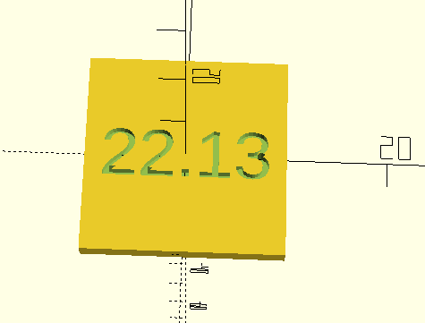

    An Openscad program can read a file using either the include or use functionality. The program can then use the information read to dynamically modify the model. In my case I read a file containing a string representation of the present time and then include this as a engraved timestamp of my model. This example is a cube with an hour and minute time stamp.

     The use function reads the content of the scadtime.scad file. In this case the content is a function hourmin() returning a time string. As an example:
    function hourmin()=str(22.21);
     where the number is the time.  The rest of the program generate a cube and subtracts the text hm. A script program generates the scadtime file

    After I start the above script the script will update the scadtime file every minute until killed.  Thus the file will hold the present time with one minute resolution. The problem with this is that OpenScad sets  notification on the file and will thus detect file changes and  generate a new view of the model  (like pressing F5). This is very inconvenient if you are at editing the model.
    It is therefore better to increase the sleep time to e.g. 3600 seconds. A timestamp with one hour resolution will be fine if you do not reprint the model too often.
