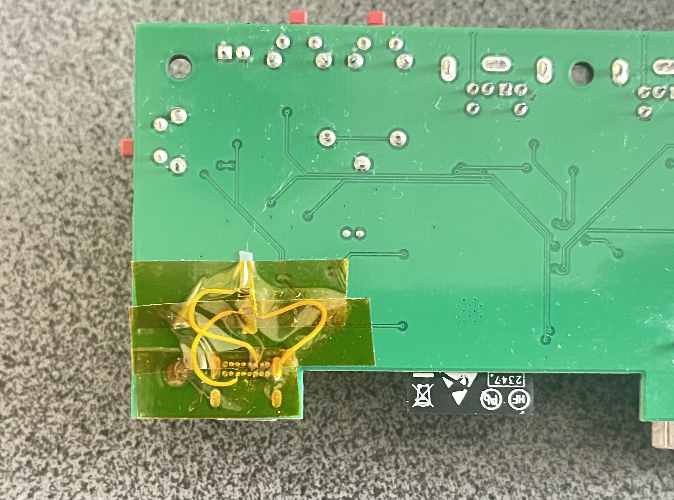

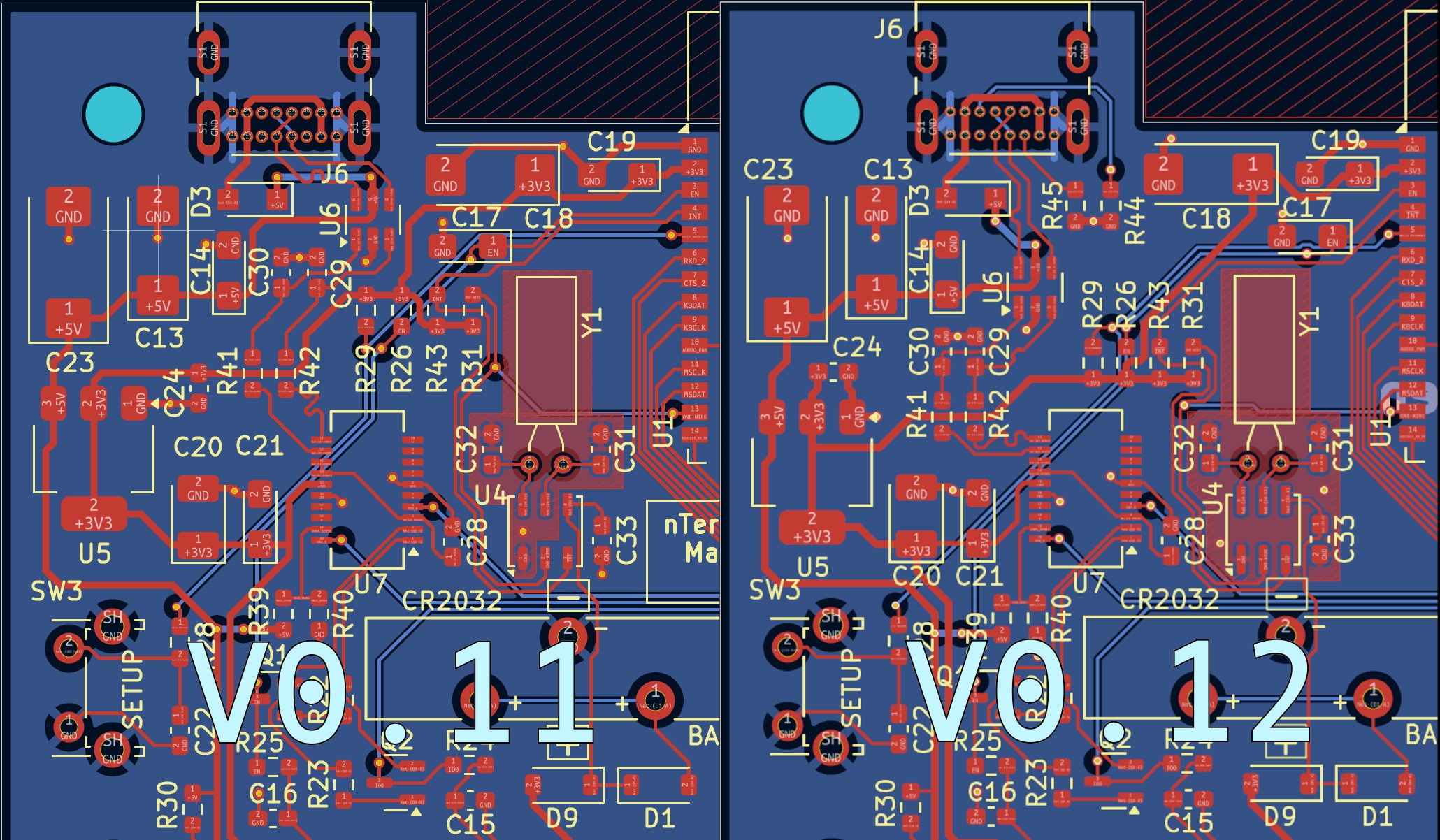

    The n00b mistake that I had made reared its ugly head when I plugged in my nTerm2-S v0.11 into my macbook directly, using a USB-C to USB-C cable. Up til then, I had always connected through an old USB 2.0 hub, figuring that if I made a mistake, it was better to let the USB hub go up in smoke than a USB-C port on my expensive MacBook. This is good practice that anyone should follow.
    But it has a caveat...
    USB 2.0 happily always provides the device with 500mA of power, regardless of anything. So if you use a USB 2.0 hub, with a USB 2.0 to USB-C cable, and plug in your USB device, it works great.
    However, USB-C wants to negotiate first about how much power it will give you. And if your device doesn't negotiate, USB-C just doesn't give it power. Simple as that.
    The power negotiation of USB-C (USB-C PD) is a bit involved, but at the minimum the device needs to negotiate its power role. In the case of the nTerm2-S, its role is a power sink (it needs power, doesn't deliver it), and that role is negotiated by putting two 5K1 pulldown resistors on the CC1 and CC2 connections of the USB-C connector. And guess what I forgot...?
    Hacking a few resistors onto the V0.11 board confirmed that it was indeed the problem.
    It's especially unfortunate because the space around the USB-C port was already quite cramped, and I just couldn't find the space for the resistors. Of course I could have actually placed them almost anywhere on the board, because they are passive. But that goes against aesthetics. So I took the time to refactor almost the whole USB and power area. And to be honest, I was quite happy with it because it now looks more neat.
    Spot the differences.
    And there we are. It's now 2 months later, and I have still not found any reason for any new updates to the hardware. And that means that I am done with the hardware.

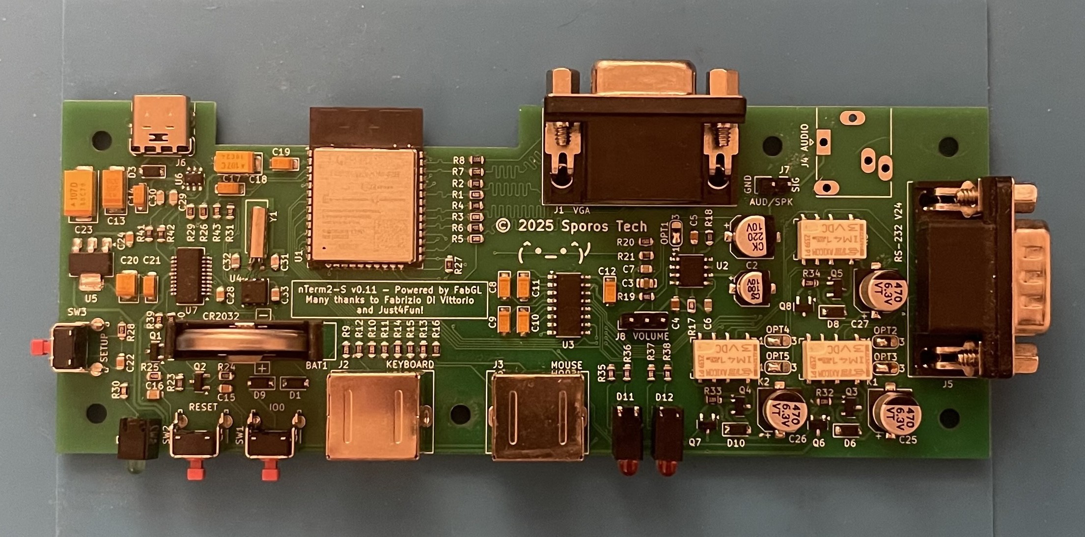

    v0.08 had everything working to such extent that I could continue developing the software. Many, many hours have gone into the software, even though it was based on a library that already existed. So I postponed making a new version until I got much further into the software.
    But in the mean time, I was updating the design. v0.09 was already there, fixing some missing thermal reliefs. v0.10 came and went, which fixed a few small details, including the mentioned capacitor. v0.11 added a pin header for connecting a volume pot, and had some improvements in the routing.
    I ordered PCBs, which arrived after some time. I actually made videos of how I soldered it together, but due to lack of time and lack of experience with video editing, I have not processed them into a nice video yet.
    But here is the end-result!
    Of course, the story does not end here. Because I am a n00b, and I expect that a few of the people who have had a look at any of the versions I made, other than V0.12, will have spotted my mistake. :)

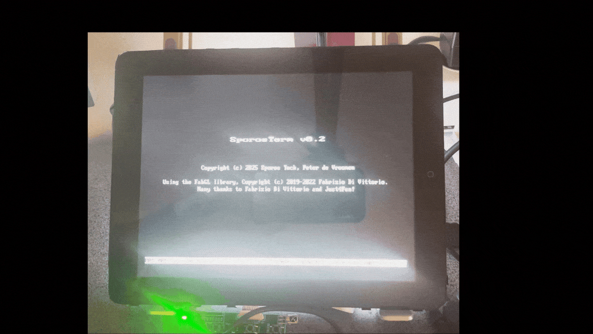

    While testing v0.5, another thing had started to annoy me. I had started to write the software, and at some point got the status bar to work. And I was showing the date and time on the status bar. But every time I cycled the power, I had to set the clock again. Not ideal, so I started looking for an RTC chip. Now, I had all of the GPIOs in use, except one. So if I would want to add an RTC without making changes to the GPIO or surrounding circuitry, I had to find something that used one wire. 1-wire! I shopped around on Dallas's website and found the DS417. Not really an RTC, but a 64-bit counter that increases the count with 1 every second. Sounds like Unix time_t to me, so perfect. Cobbled a prototype together on my v0.5 board, and it worked first time.

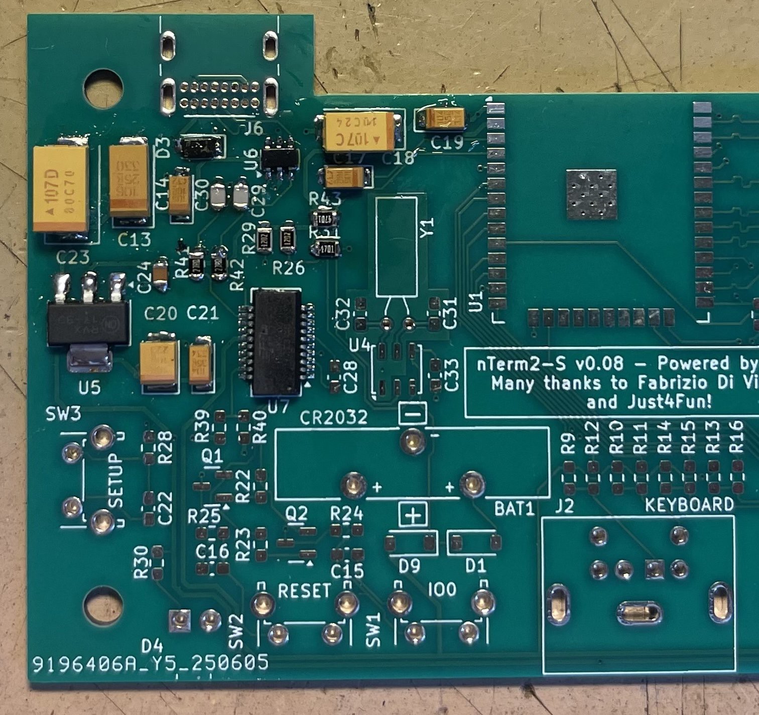

    Now, I want to point your attention to capacitor C19, at the top right. See how its orientation is different from all the other capacitors? That's a recipe for disaster, because for sure there will be people (including myself) who will solder it the wrong way around. This is a major showstopper, unacceptable and cannot be released this way.
    But other than that, this release was great, it worked flawlessly, the clock worked, all the footprints were finally right. Just that pesky capacitor that I should have rotated. Great success!

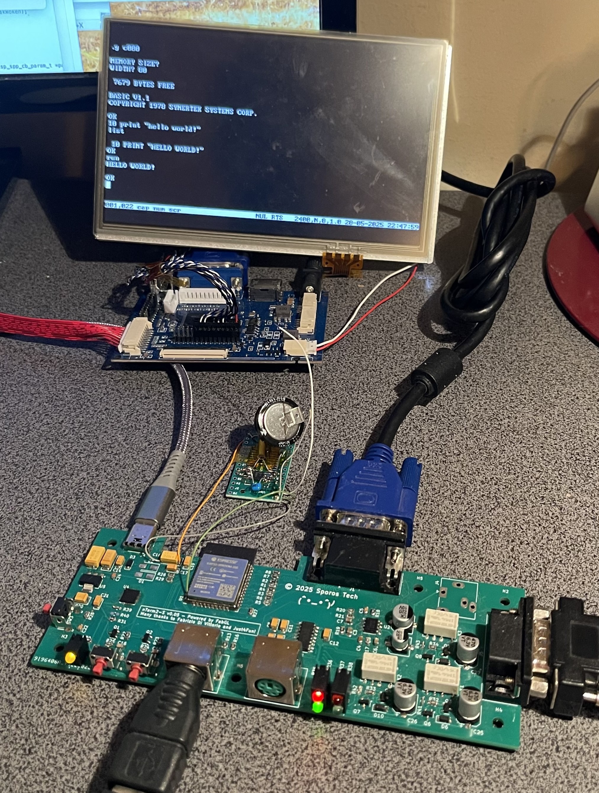

    Everything began with the first prototype I made. In the previous post I mentioned that many of my projects stranded in the phase where everything was held together with strings. Well, this prototype is one of those. As far as 'being held together with strings', while still doing its work, is something to be proud of, I am extremely proud of this one! Let me show you. ;)
    The parts.
    The result. Working!
    That it was actually speaking with my SYM-1 was motivating enough to dive headlong into the project.
