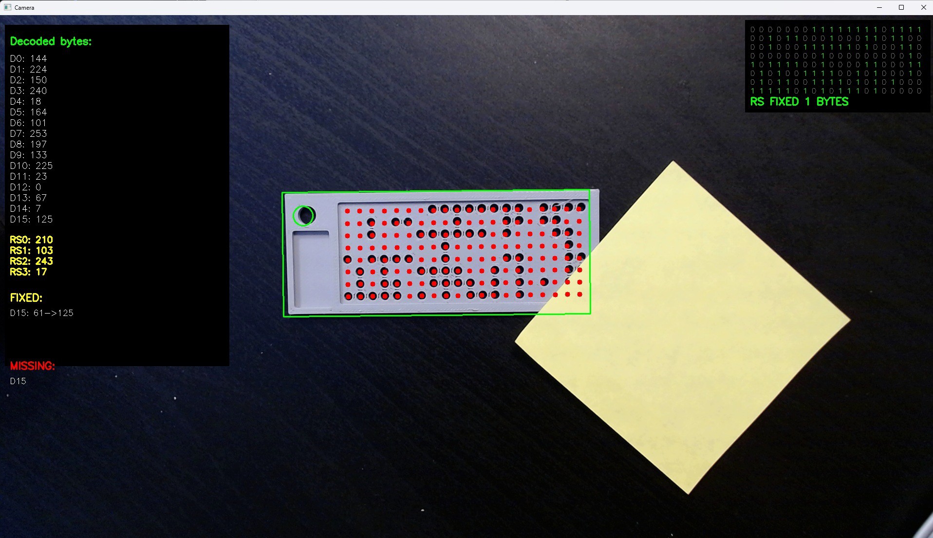

Its pretty simple, the card has 16 bytes of information and 4 bytes of Reed-Solomon error correction coding. Every 5th byte is an RS byte. This way upp to 4 lost bytes or 2 damaged bytes can be repaired. RS coding is used in a lot of applications, most 2d barcodes and a lot of space probes use them with the radio link to earth.
Before deciding on Reed-SlomonI did some tests with having one parity bit on the end of every byte, and to have a checksum byte in the end of the card, but it had some problems where the card was read with errors that wasn't detected.

Easy, a web camera strapped to a desk lamp looking down onto a dark desk from 20 cm height. I use a Logitech C920 that works well.
Reading the card with the Python code is pretty straight forward, the program puts a matrix on the image that the user guides to cover the card. After this the program reads the color in each point on the matrix, if there is a hole the dark desk is seen, and this is detected as "1". No hole = gray color, = "0".
The setup can be a bit sensitive to light, i had dom make some adjustments before it started working every time.

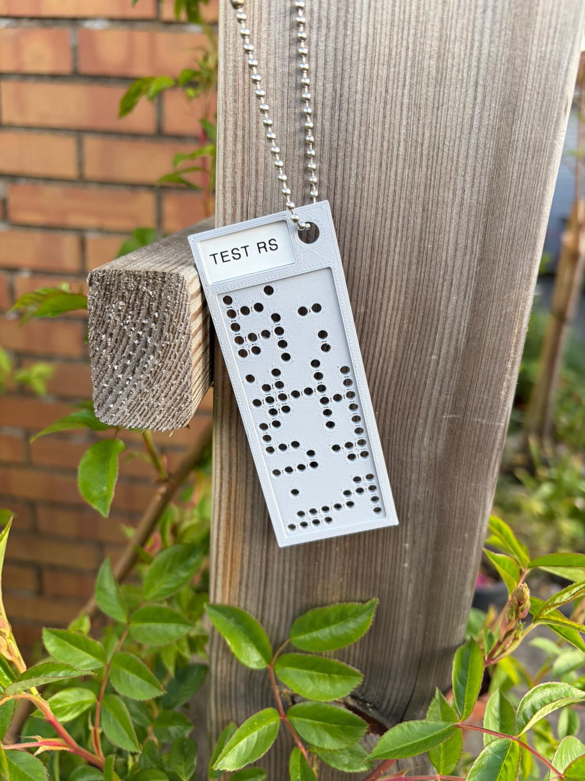

Punch cards made from plastic or stainless steel has very good longevity and data retention. One can only speculate, but most SSD and USB memory sticks might only be viable for 30-40 years, and archaeologists some times find metal from the roman empire two thousand years ago. A steel card could probably survive a house fire also. A steel print of the STL can easily be ordered from places like PCBway.

Stainless steel memory card
This punch card is made from SAE 316L stainless steel, with reed-solomon coding. Its a very hardy stainless steel that will provide very high memory retention, even in acidic and highly corrosive environments.
