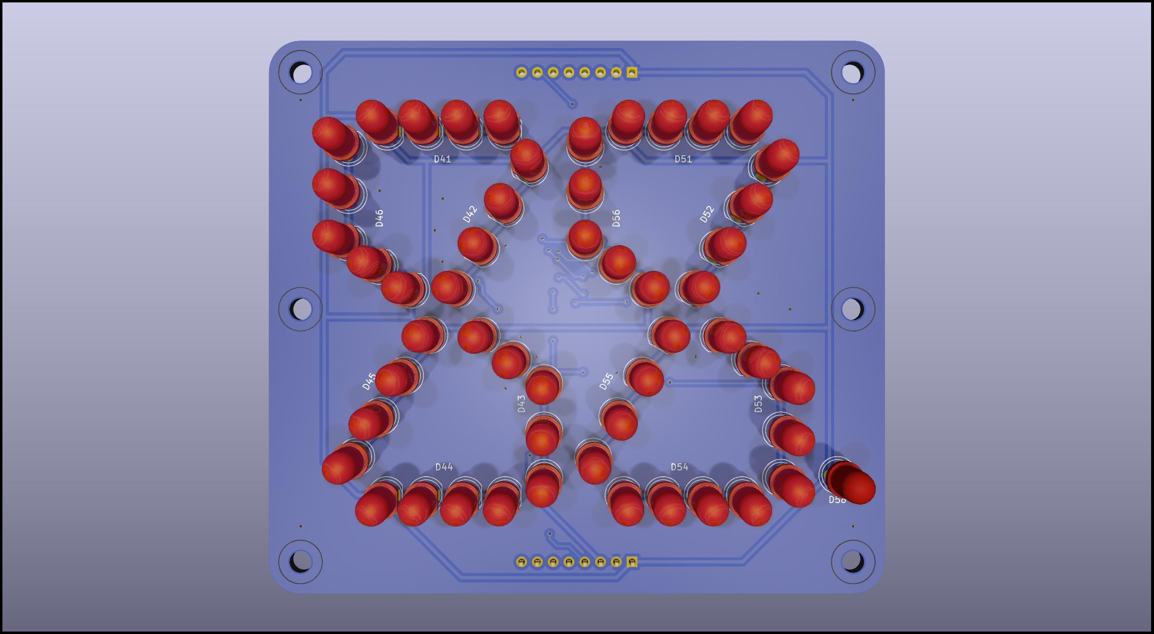

First prototype

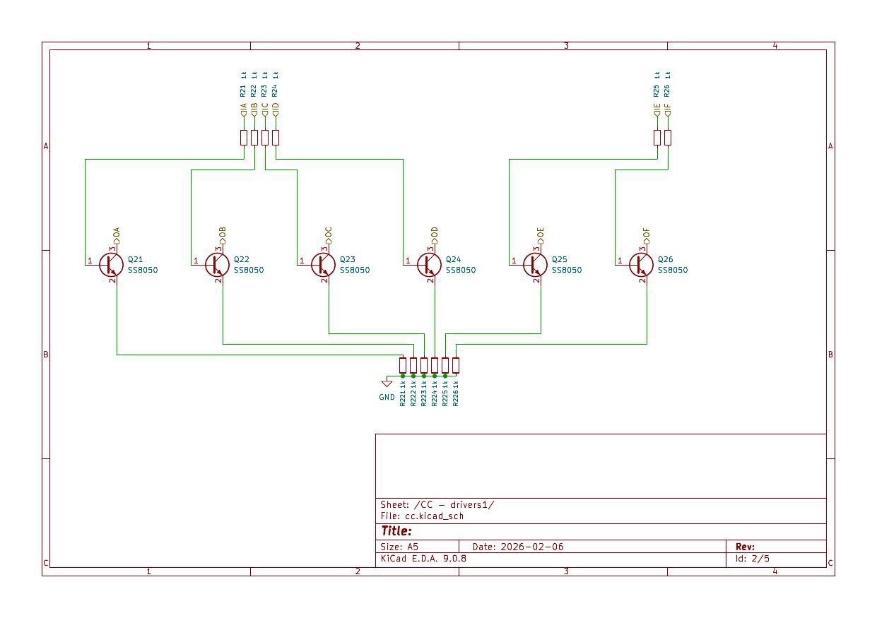

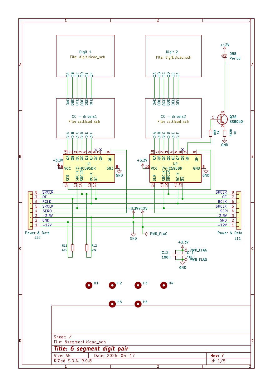

I made a prototype with the vertical design and it looked like this. Straight away I realised that the proportion was wrong, the digit pairs were too far apart vertically, as I don't have an artist's eyes looking at the board layout. But I'll post picture of the root schematic sheet and constant current driver sheet to show how the constant current circuit works.
figure>
The outputs of the 74HC595 shift register are 0 V or 3.3 V. At 0 V, the transistor is turned off and no LED current flows. At 3.3 V the transistor is turned on with a tiny drop in the base resistor due to the microamps of current. The emitter is pulled up to about (3.3 - 0.6) V resulting in about 2.7 mA flow through the 1 kΩ resistor. This is practically independent of the collector voltage thus constant current drive. The collector voltage will rise until the LED current is 2.7 mA. This assumes there is sufficient headroom, i.e. LED supply rail - drop across 4 or 5 LEDs > (3.3 + 0.1) V where 0.1 is a typical collector-base saturation voltage. Any headroom is dissipated by the transistor as heat but for the milliamp currents, it's negligible and necessary for constant current drive.
If you're wondering about the strange formatting of the drivers page, in a previous iteration I used resistor packs for the base and emittor resistors. But SMD resistors are small enough and besides the ground pad can be connected to a nearby point on the ground plane.

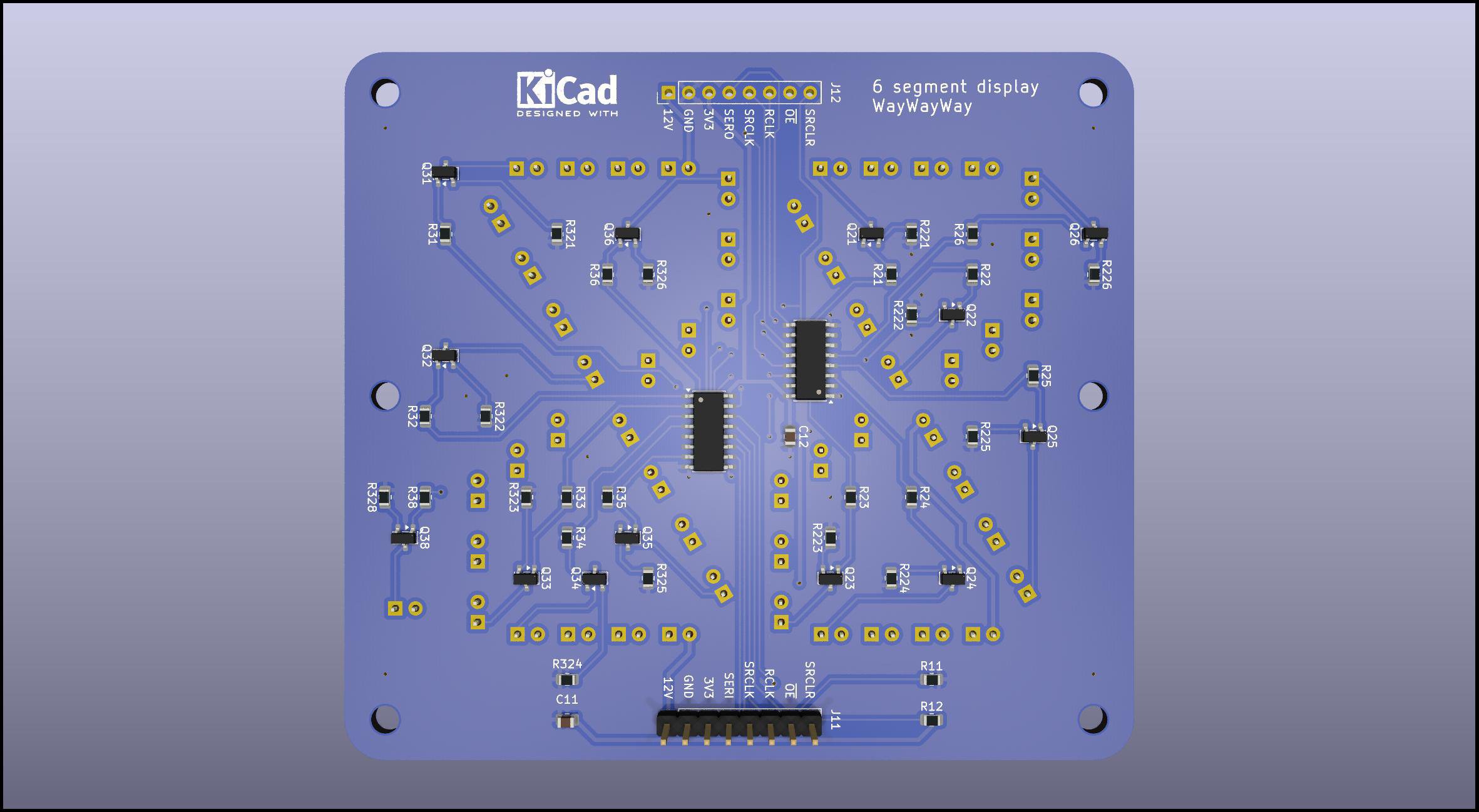

Second version, sponsored by PCBWay
At this point PCBWay contacted me and asked if I had any interesting projects that could draw attention to their PCB and PCBA services. They offered to sponsor this design. Here are the 3D renditions of the new, shorter board.
What's with the WayWayWay on the back silkscreen? This is a placeholder which PCBWay will replace with the order number that identifies your job. If it's not present, then PCBWay will put it in an inconspicuous place.
