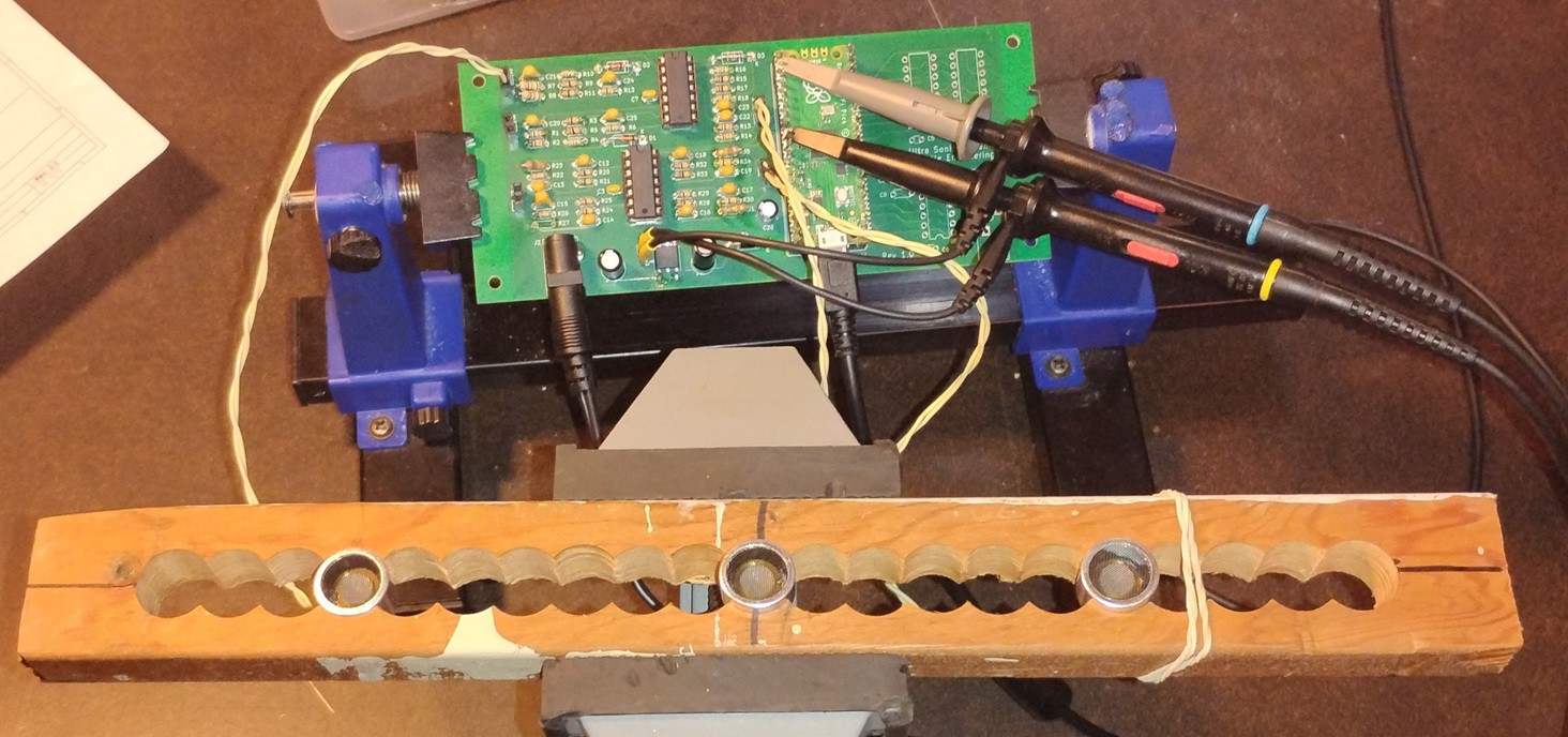

To sense the location of the players hands I use ultrasonic transmitters and receivers. The following diagram shows the arrangement.
        L       R
    X   A   Y   B   Z
There are two ultrasonic transmitters, A and B, three ultrasonic receivers, X, Y and Z, and two players hands, L and R. First transmitter A transmits a series of pulses which reflect off hand L and is received by receivers X and Y. The controller measures the time of flight for ALX and ALY. Next transmitter B transmits a series of pulses which reflect off hand R and is received by receivers Y and Z. The controller measures the time of flight for BRY and BRZ. From these times I calculate the four desired values, left pitch, right pitch, left volume, and right volume.

  • Progress on receiver circuits
    Mike Christle • 06/22/2026 at 16:12 • 0 comments
    My apologies for the delay in reporting. Last week my AC died and I had to get a whole new system $$$. Having no AC in Florida in June is not good for my productivity.
    I finally finished up with the receiver circuit. First I experimented with the spacing between transiter and receiver. See picture below. I decided to reduce the distance from 4 inches to 3.5 inches.
    Then I found that the output of the receiver circuit was too low in the default state. This meant that the PICO always saw a logic one. I fixed this by adjusting the resistor values so the output defaults to about 0.5V.
