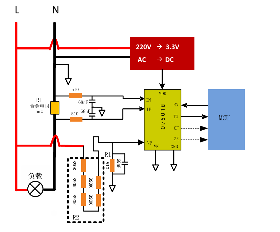

Circuit Diagram
I had followed the datasheet, and used the circuit as per the configuration in the documentation. The current sensing path uses a 1 milliohm shunt resistor connected between the IP1 and IN1 pins. At the maximum rated current, the voltage drop across this shunt stays well within the +/-200 mV. The 2.2 uF anti-aliasing capacitor are added across the IP/IN inputs to filter out high-frequency noise from the mains. This is important because the sigma-delta ADC inside the BL0940 can alias at high-frequency harmonics.
Four 300K ohm resistors in series (1.2 MOhm total) form the high side, and a 510 ohm resistor forms the low side. This gives a division ratio of approximately 2354:1, which scales 220V mains down to about 93 mV at the VP pin safely within the ADC input range. For power supply, the BL0940 runs on 3.3V. I have placed a 100 nF ceramic capacitor right next to the VDD pin for high-frequency decoupling, the power is given through the onboard LDO AMS1117 3.3V.
The CF pin outputs energy pulses and can be used for kWh counting or alarm output, while the ZX pin provides a zero-crossing signal synchronized to the mains frequency. Which are not used in this version of the tutorial. All readings are sent to the Serial Monitor,...
