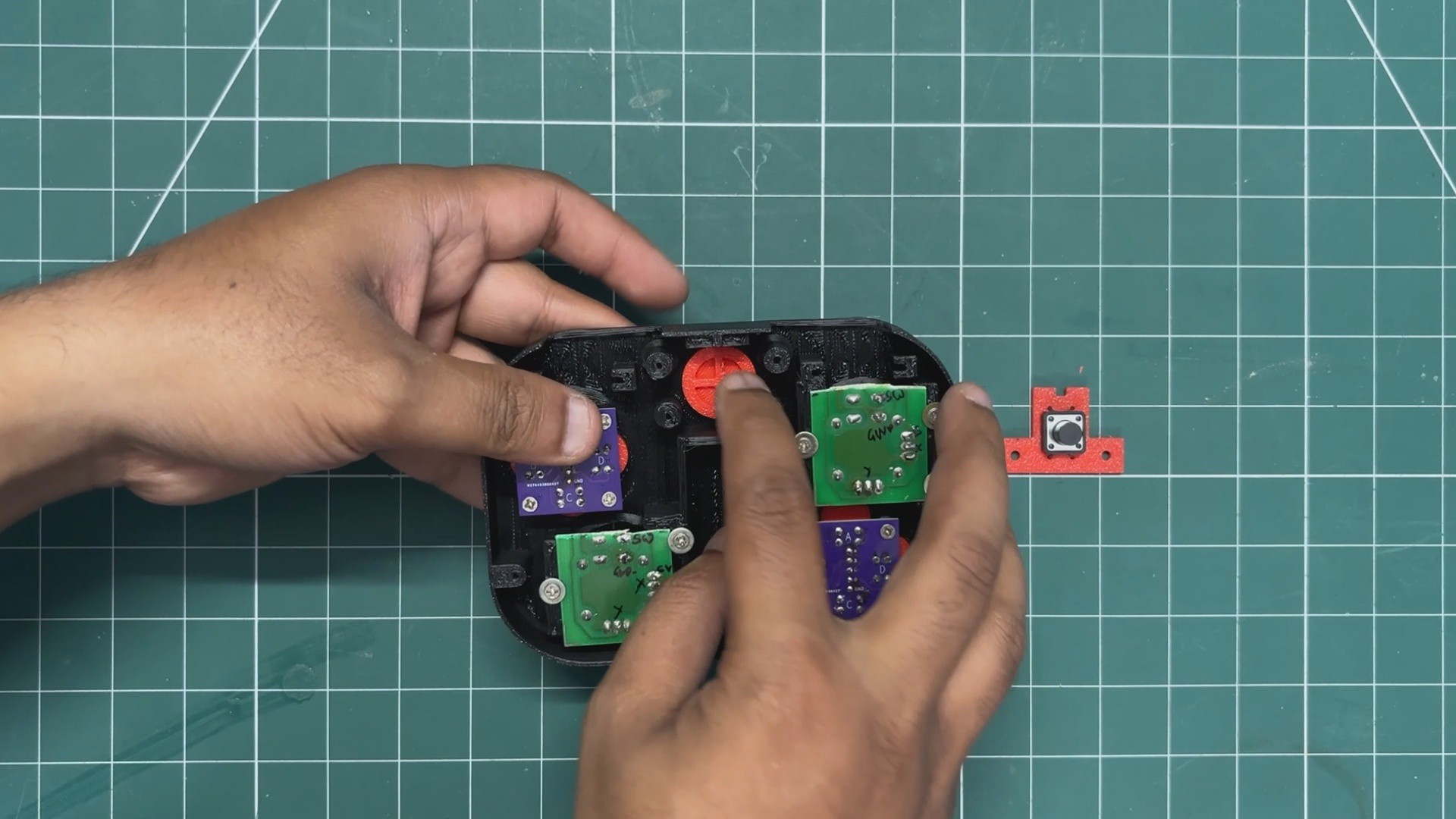

3FRONT BODY ASSEMBLY

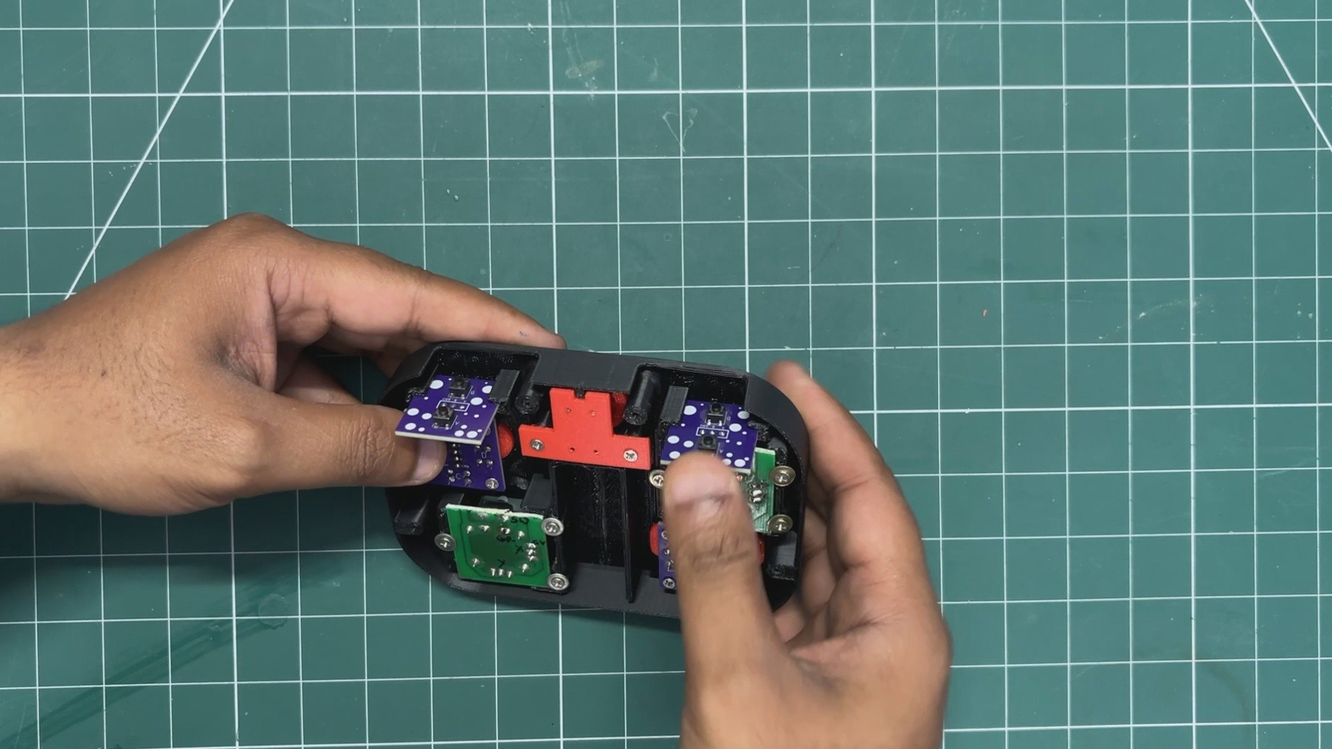

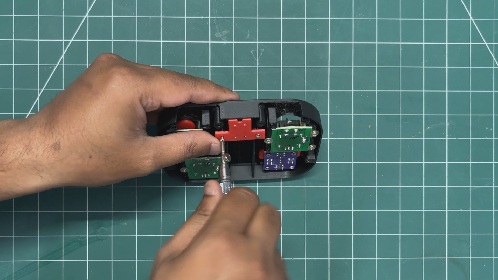

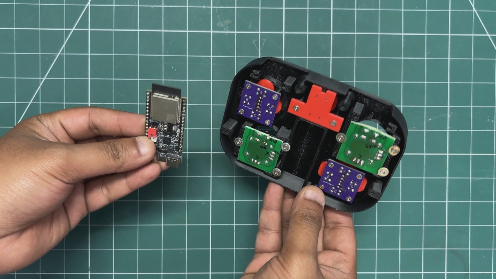

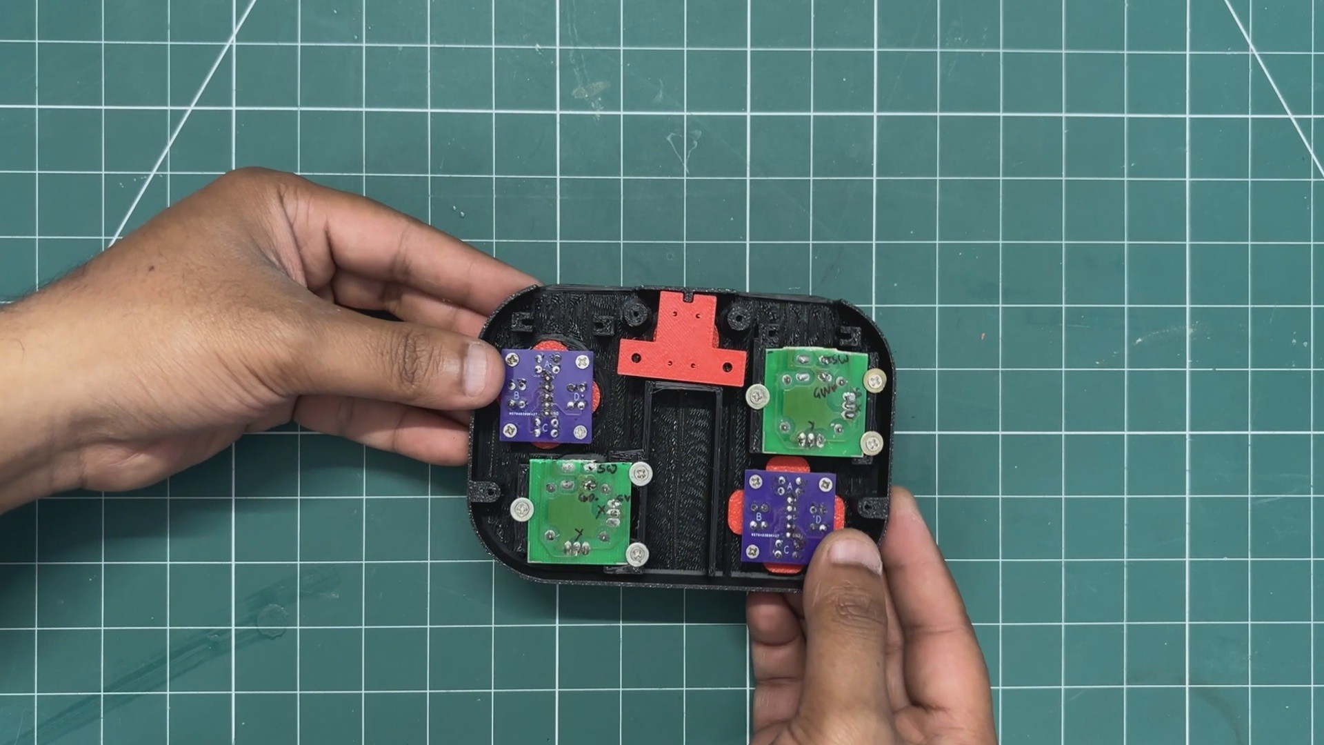

We began the assembly process by placing the D-pad button and XYAB buttons into their positions from the inside of the front body.
Next, the button boards were placed over the D-pad and XYAB buttons and aligned with the screw bosses. We then used four M2 screws for each PCB to secure them in place.
Similarly, the analog joystick modules were positioned over their mounting locations and secured using M2 screws. We used washer-head screws here to keep the joystick modules firmly in place.

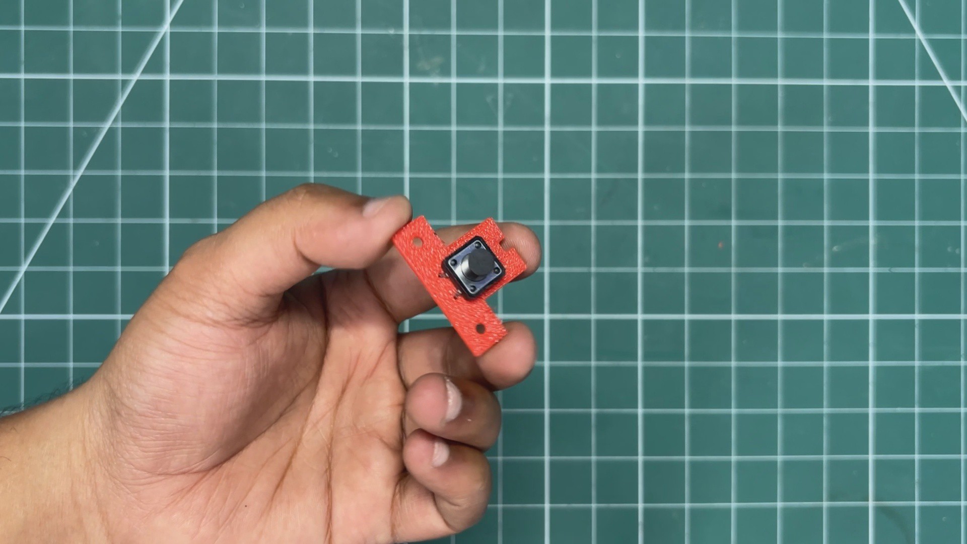

4XBOX BUTTON SUDO PCB ASSEMBLY
The Xbox button was positioned in place, and over that, we placed the 3D-printed switch PCB. After aligning it with the two mounting screw bosses, we used two M2 screws to secure it in place.

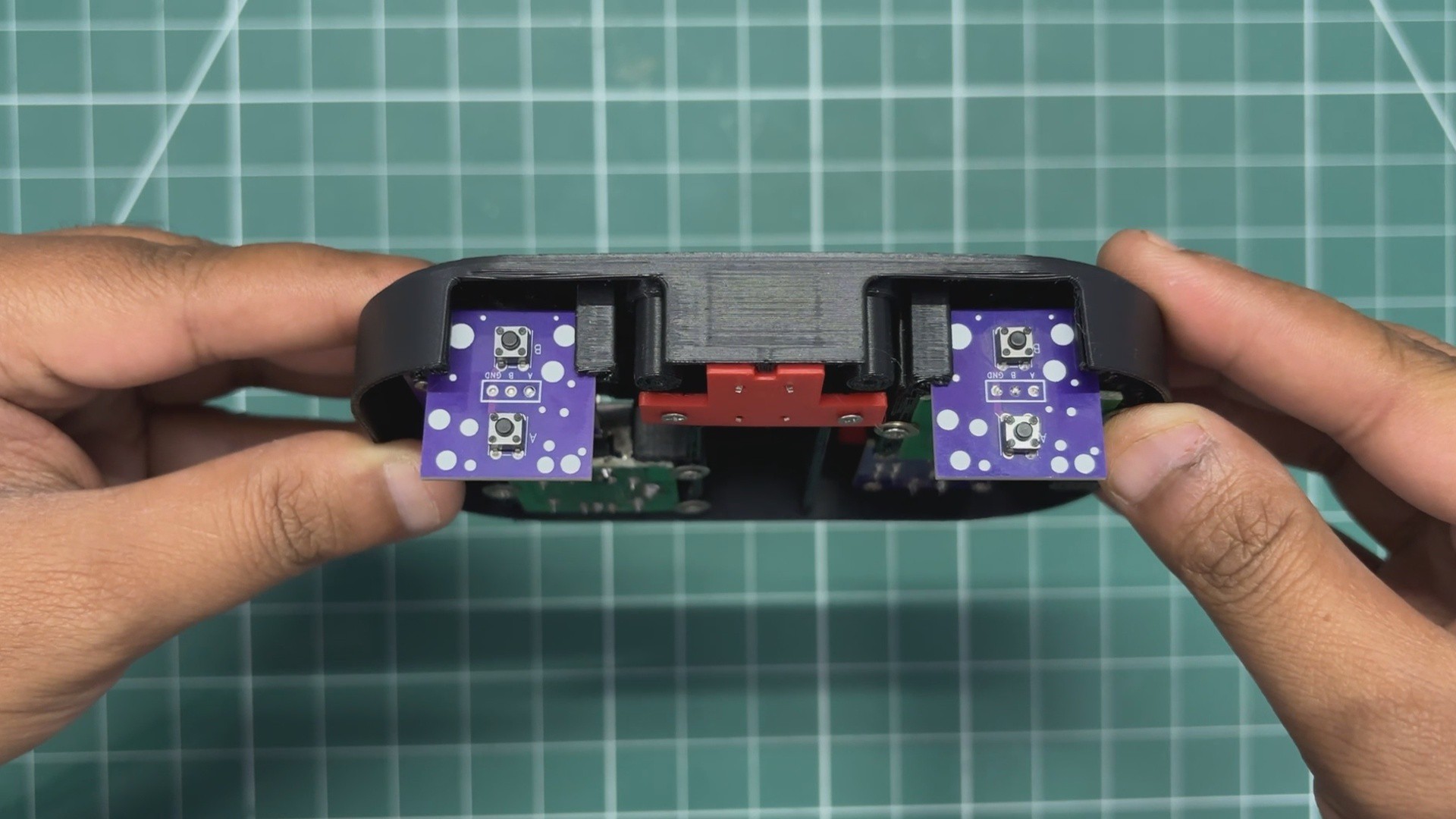

5SHOULDER & TRIGGER BUTTON PCB
The button boards for the trigger and shoulder buttons were positioned in place.
We modeled two retaining ribs into the top body, allowing the PCBs to easily slide into them and stay securely pressure-fitted in place.

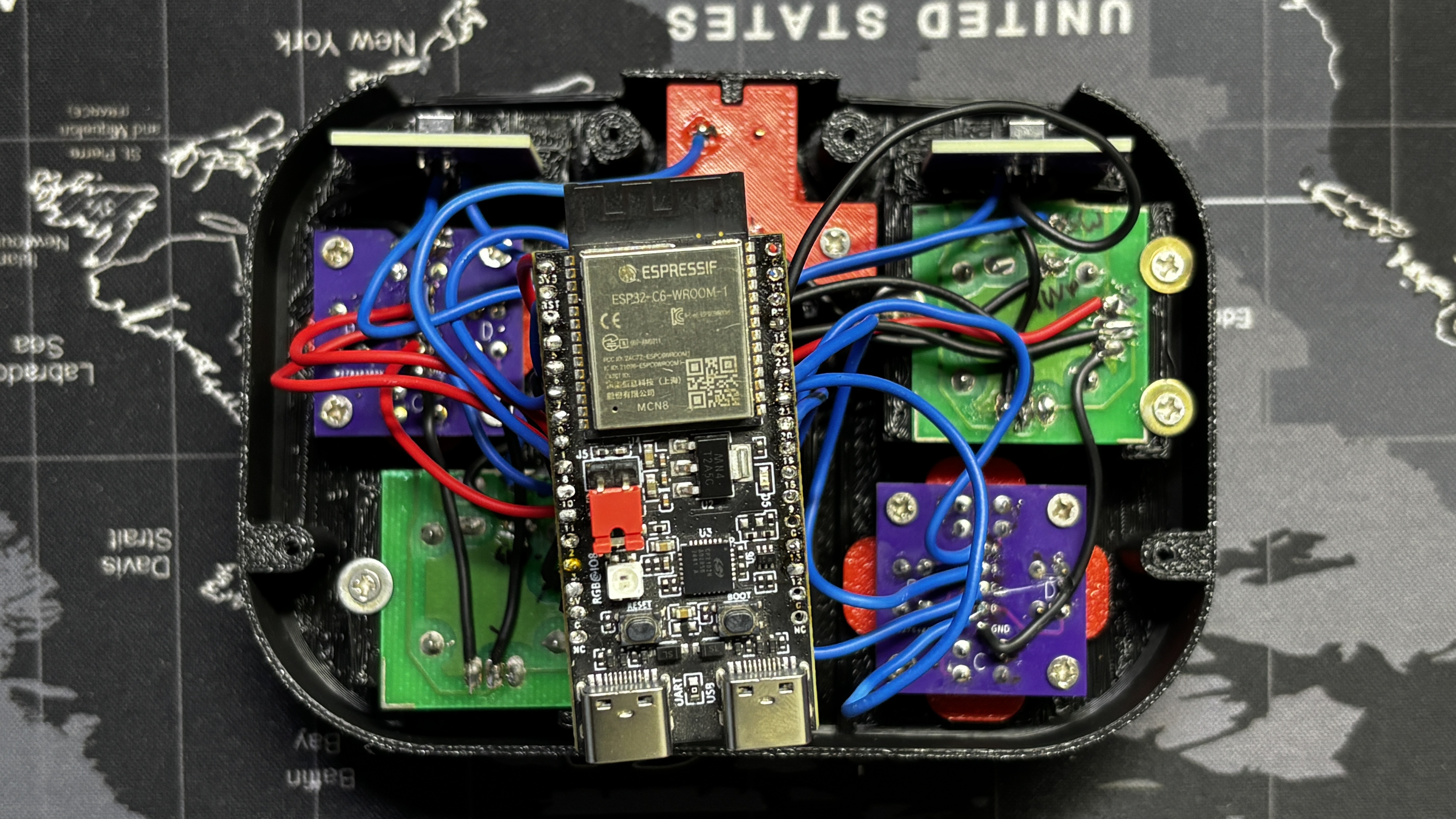

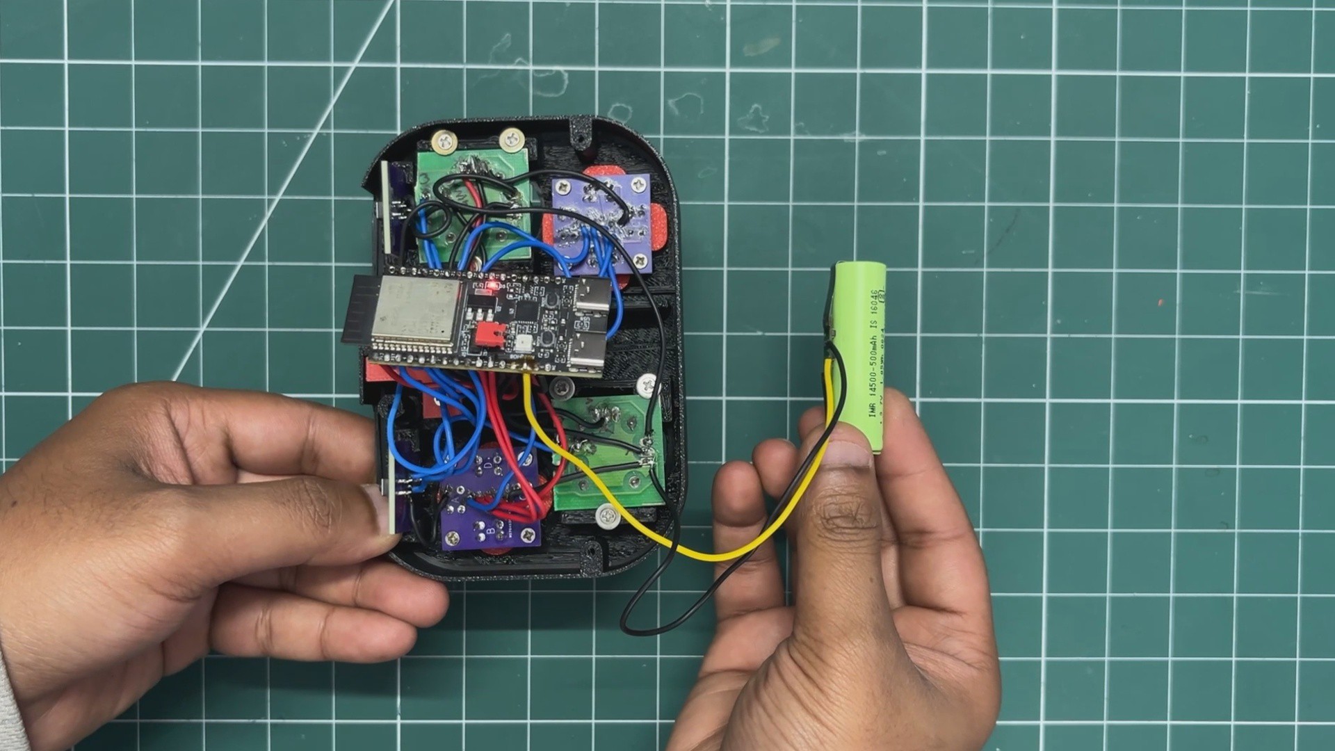

6WIRING
The wiring process for this setup was quite easy and straightforward. For wiring, we needed a lot of jumper wires. I used single-core silver-coated copper wire because it connects well with solder pads, and since it is single-core, we don’t run into issues where a single strand fails to solder properly and accidentally shorts the connector next to it.
We began by connecting the GND of all the button boards and both analog sticks to the GND pin of the ESP32-C6 DevKit.
Next, the 3V3 pin of the ESP32 was connected to the VCC pins of both analog joysticks.
Connections
- Left Analog Stick X to GPIO0
- Left Analog Stick Y to GPIO1
- Right Analog Stick X to GPIO2
- Right Analog Stick Y to GPIO3
Button Connections
- GPIO10 to A Button
- GPIO11 to B Button
- GPIO13 to X Button
- GPIO18 to Y Button
- GPIO15 to LB Button
- GPIO23 to RB Button
- GPIO6 to Left Stick Click (LS Click)
- GPIO7 to Right Stick Click (RS Click)
- GPIO8 to Xbox Guide / Home Button

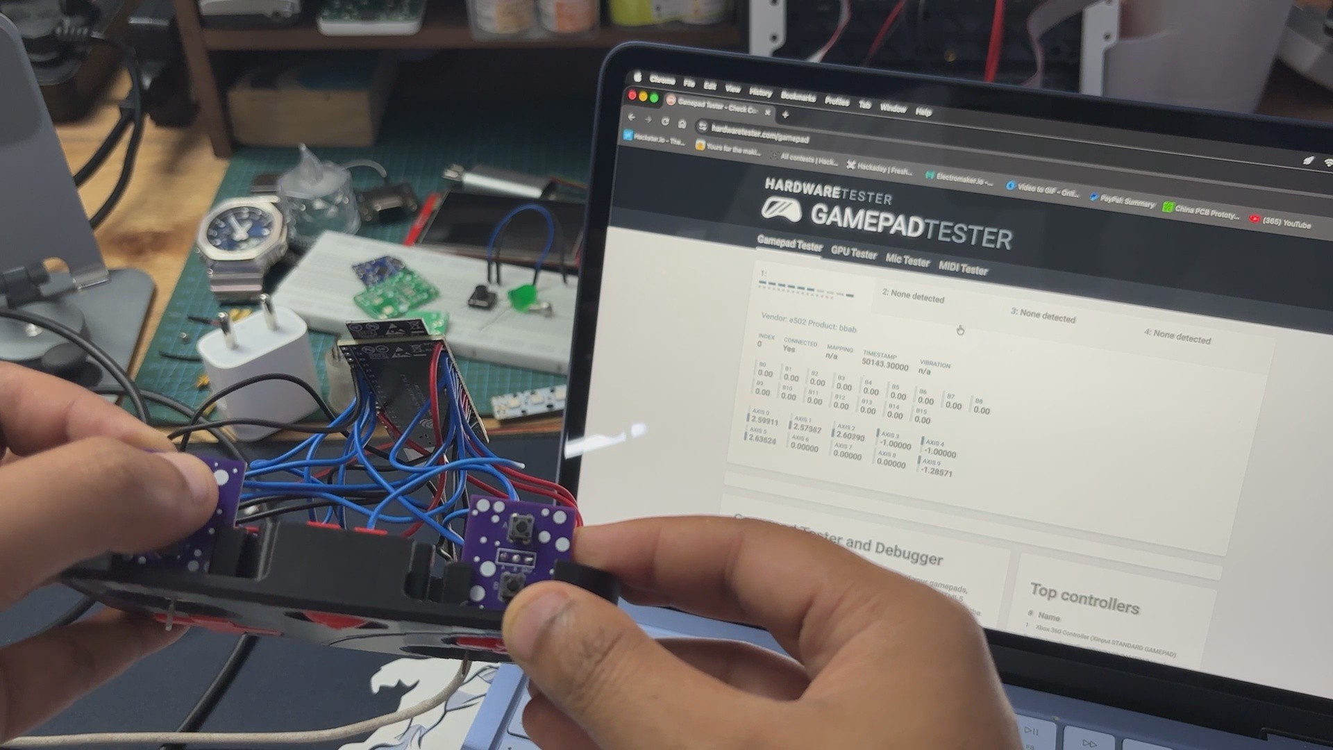

7CODE & TEST RUN
Here's the code I prepared for this project, and it's a simple one.
#include <BleGamepad.h> // Initialize BLE Gamepad as Xbox Controller BleGamepad bleGamepad("Xbox Wireless Controller", "Microsoft", 100); // ESP32-C6 Analog Pin Mapping (Joysticks Only) #define LEFT_STICK_X 0 #define LEFT_STICK_Y 1 #define RIGHT_STICK_X 2 #define RIGHT_STICK_Y 3 // Digital Buttons Configuration (Pin, BLE ID) struct ButtonMapping { uint8_t pin; uint16_t gamepadButton; }; // Your precise working layout ButtonMapping actionButtons[] = { {10, BUTTON_1}, // A {11, BUTTON_2}, // B {13, BUTTON_3}, // X {18, BUTTON_4}, // Y {15, BUTTON_5}, // LB {23, BUTTON_6}, // RB {6, BUTTON_9}, // LS Click {7, BUTTON_10}, // RS Click {8, BUTTON_13} // Xbox Guide / Home Button }; const int numButtons = sizeof(actionButtons) / sizeof(ButtonMapping); // Trigger Buttons #define LEFT_TRIGGER_BTN 4 #define RIGHT_TRIGGER_BTN 5 // D-Pad Pin Assignments #define DPAD_U 19 #define DPAD_D 20 #define DPAD_L 21 #define DPAD_R 22 void setup() { Serial.begin(115200); pinMode(LEFT_STICK_X, INPUT); pinMode(LEFT_STICK_Y, INPUT); pinMode(RIGHT_STICK_X, INPUT); pinMode(RIGHT_STICK_Y, INPUT); for (int i = 0; i < numButtons; i++) { pinMode(actionButtons[i].pin, INPUT_PULLUP); } pinMode(LEFT_TRIGGER_BTN, INPUT_PULLUP); pinMode(RIGHT_TRIGGER_BTN, INPUT_PULLUP); pinMode(DPAD_U, INPUT_PULLUP); pinMode(DPAD_D, INPUT_PULLUP); pinMode(DPAD_L, INPUT_PULLUP); pinMode(DPAD_R, INPUT_PULLUP); // Configure BLE Gamepad reports BleGamepadConfiguration bleGamepadConfig; bleGamepadConfig.setAutoReport(false); bleGamepadConfig.setWhichAxes(true, true, true, true, true, true, false, false); bleGamepad.begin(&bleGamepadConfig); Serial.println("ESP32-C6 Joystick Precision Patch Loaded!"); } void loop() { if (bleGamepad.isConnected()) { // 1. Process Action & Xbox Guide buttons for (int i = 0; i < numButtons; i++) { if (digitalRead(actionButtons[i].pin) == LOW) { bleGamepad.press(actionButtons[i].gamepadButton); } else { bleGamepad.release(actionButtons[i].gamepadButton); } } // 2. Process Digital Triggers if (digitalRead(LEFT_TRIGGER_BTN) == LOW) { bleGamepad.setLeftTrigger(65535); } else { bleGamepad.setLeftTrigger(0); } if (digitalRead(RIGHT_TRIGGER_BTN) == LOW) { bleGamepad.setRightTrigger(65535); } else { bleGamepad.setRightTrigger(0); } // 3. Process D-Pad Vectors bool up = (digitalRead(DPAD_U) == LOW); bool down = (digitalRead(DPAD_D) == LOW); bool left = (digitalRead(DPAD_L) == LOW); bool right = (digitalRead(DPAD_R) == LOW); if (up && right) bleGamepad.setHat1(DPAD_UP_RIGHT); else if (down && right) bleGamepad.setHat1(DPAD_DOWN_RIGHT); else if (down && left) bleGamepad.setHat1(DPAD_DOWN_LEFT); else if (up && left) bleGamepad.setHat1(DPAD_UP_LEFT); else if (up) bleGamepad.setHat1(DPAD_UP); else if (down) bleGamepad.setHat1(DPAD_DOWN); else if (left) bleGamepad.setHat1(DPAD_LEFT); else if (right) bleGamepad.setHat1(DPAD_RIGHT); else bleGamepad.setHat1(HAT_CENTERED); // 4. Process Joysticks // OPTIMIZED: Re-scaled to standard signed integer limits to eliminate the floating center issue. // Note: If an axis moves opposite to your hand, swap the last two numbers (e.g., -32767, 32767 to 32767, -32767) int lsX = map(analogRead(LEFT_STICK_Y), 0, 4095, -32767, 32767); int lsY = map(analogRead(LEFT_STICK_X), 0, 4095, -32767, 32767); int rsX = map(analogRead(RIGHT_STICK_X), 0, 4095, -32767, 32767); int rsY = map(analogRead(RIGHT_STICK_Y), 0, 4095, -32767, 32767); bleGamepad.setLeftThumb(lsX, lsY); bleGamepad.setRightThumb(rsX, rsY); // Send unified controller state data bleGamepad.sendReport(); delay(8); } }What our sketch does is transform the ESP32-C6 DevKit into a fully functional wireless game controller. For this, we used the BleGamepad library, which emulates a standard plug-and-play Xbox-style wireless controller over HID via Bluetooth.
We uploaded the code to our ESP32-C6 DevKit, and after uploading, the device appeared as a Bluetooth game controller when searched for on a computer. We connected to it and then opened the Gamepad Tester website, which is a great tool for testing wired and wireless controllers.
Whenever we pressed a button or moved a joystick, we could see it being displayed as a button input or axis movement, confirming that the setup was working correctly.
8FINAL ASSEMBLY

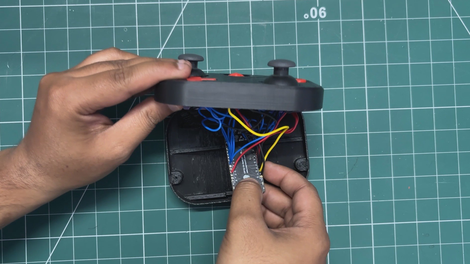

We began the final assembly process by connecting the lithium cell’s positive and negative terminals to the ESP32-C6’s 5V and GND pins.
The ESP32-C6 board was then placed into its designated position inside the back body and secured in place using a hot glue gun.

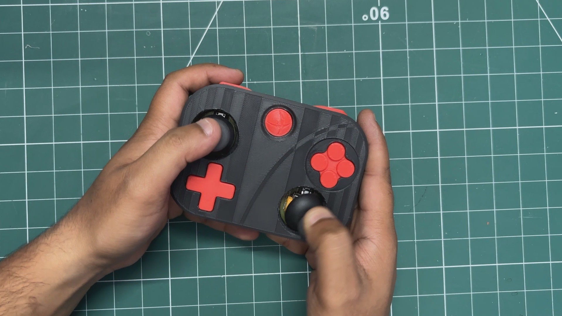

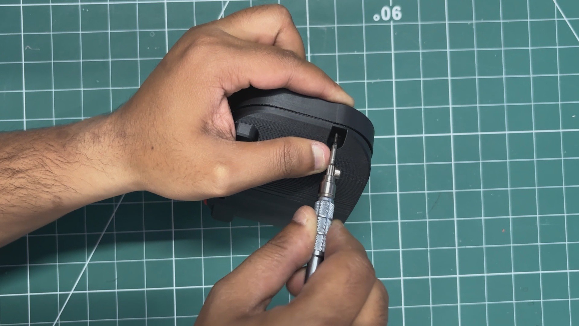

Next, the shoulder and trigger buttons were installed into both the front and back body sections. After that, both halves of the body were fitted together, and four M2 screws were used to secure everything in place, completing the assembly process.
Our controller was now complete.

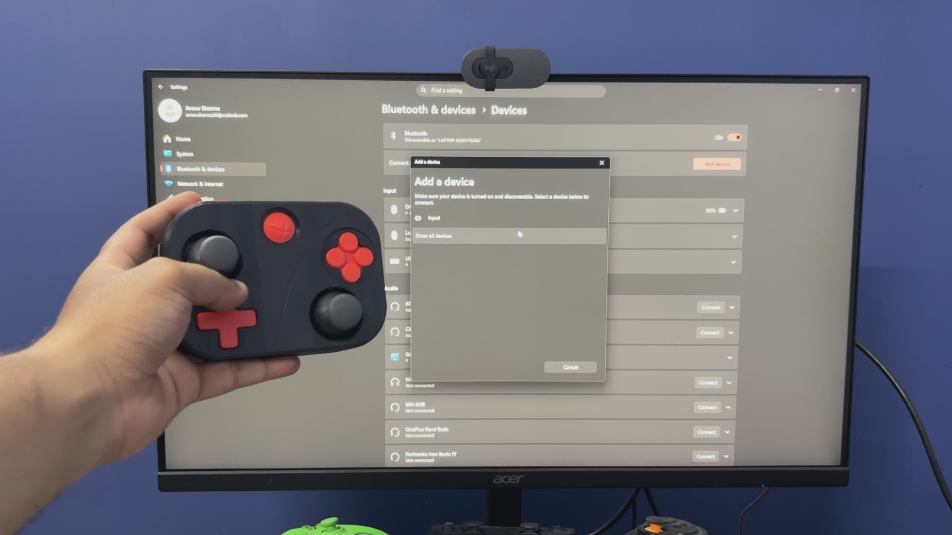

9RESULT
Here’s the end result of our build: an Xbox controller that works with both Windows and Mac. It should even work with Linux, although I haven’t tested that yet.
To pair the controller, we go into the Bluetooth settings, where our device shows up as a “Wireless Controller.” We pair the device and open Gamepad Tester, which is a really good web-based gamepad testing tool. By moving the analog sticks and pressing buttons, we can see all the inputs being registered, which confirms that the setup is working perfectly.
Next, we open Steam. Since this controller does not use XInput directly out of the box and instead works as a wireless HID controller, we first need to map the buttons manually. We go into the controller settings in Steam and assign each button one by one, skipping the ones we don’t have, which in our case were only two buttons.
Once the mapping is done, anytime we pair the controller with Steam, it just works. Double-pressing the Steam button on the controller even makes Steam enter Big Picture Mode.

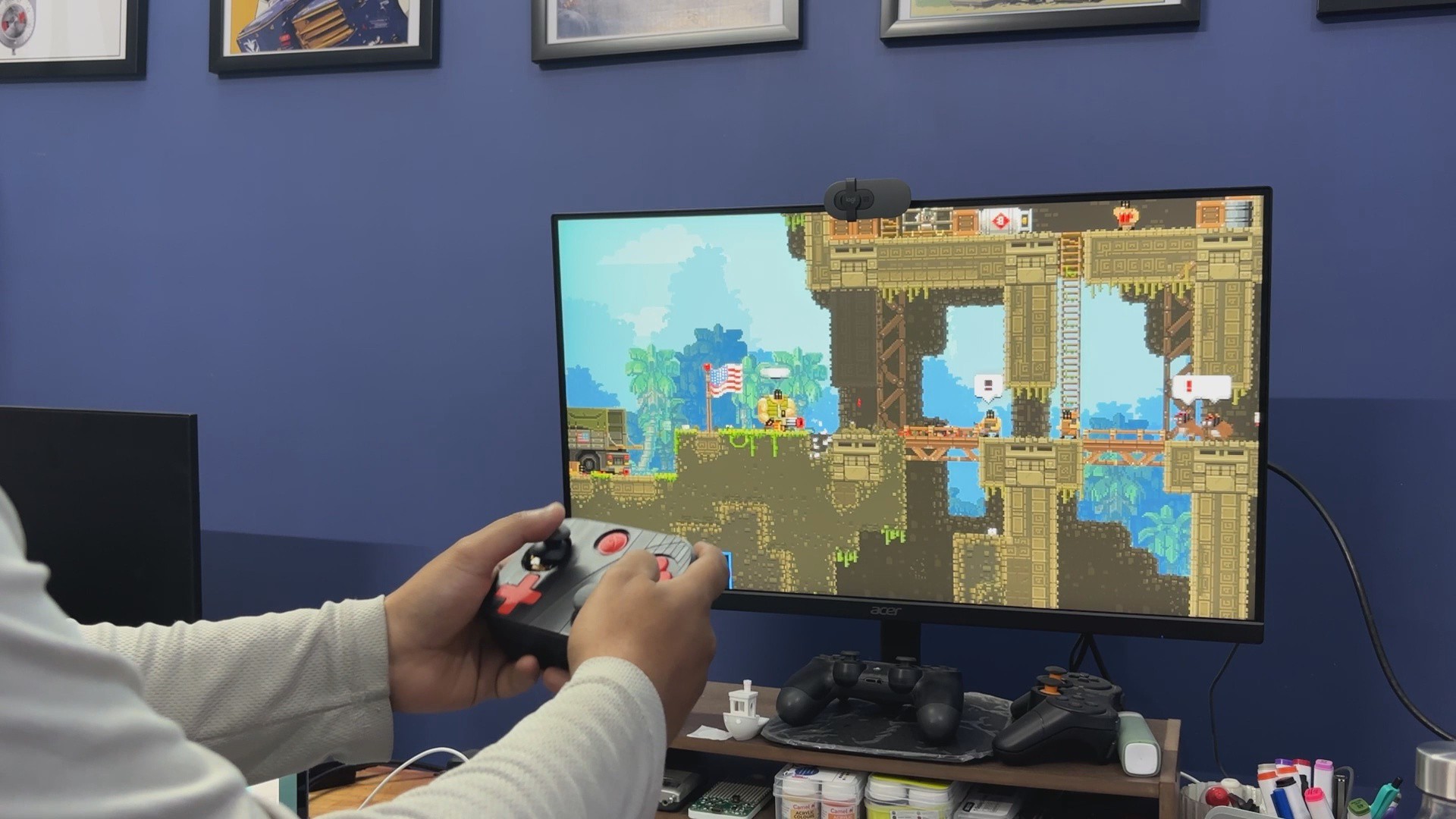

Using this controller, we tested two games: Broforce and Fallout: New Vegas. I did notice some input lag in the left and right analog sticks, but aside from that, everything seemed to function properly.
