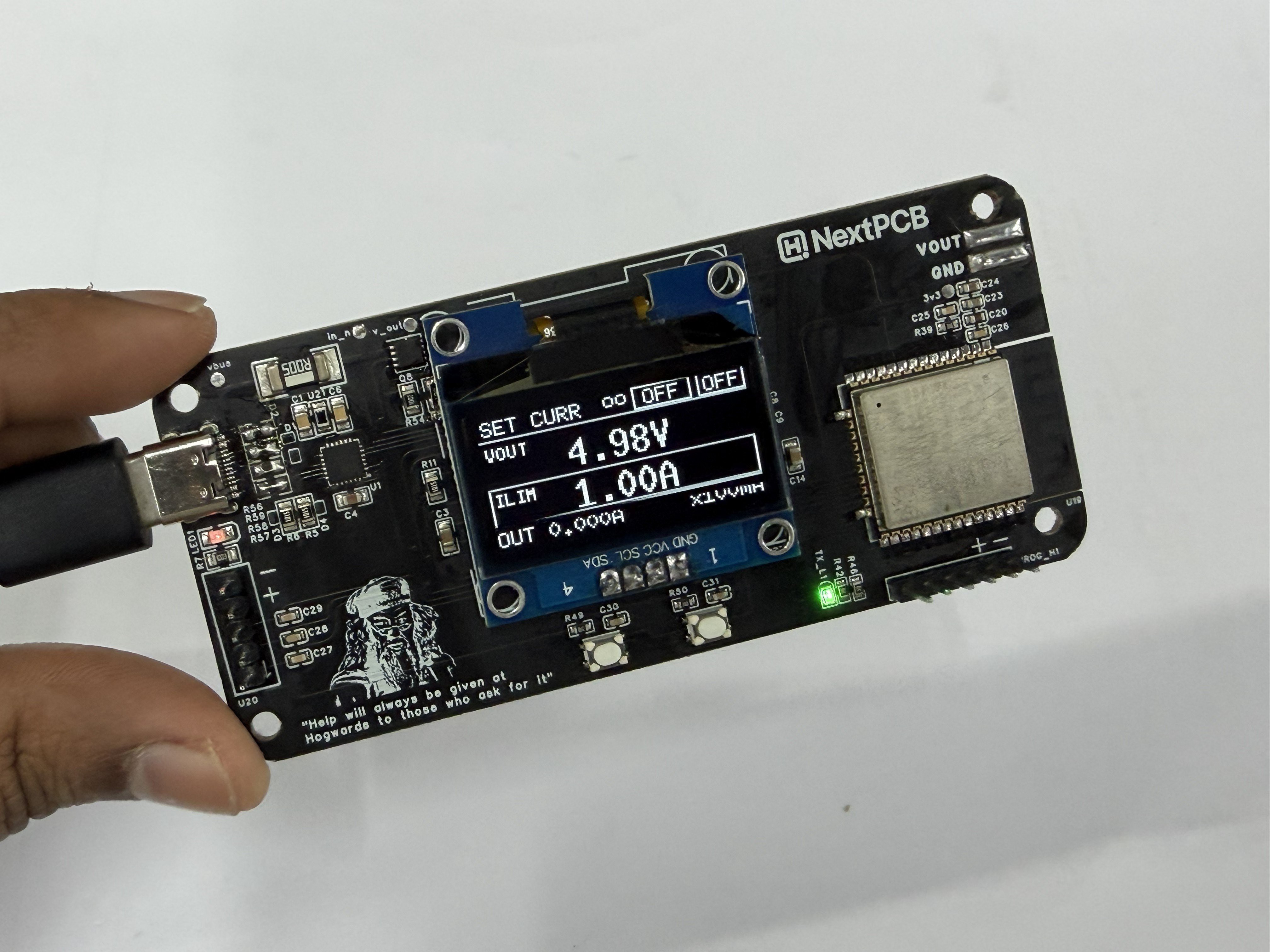

The project is built with the AP33772S USB-C PD sink controller, an ESP32 microcontroller, and an INA226 power monitor. Together, these components allow PowerPD to negotiate PD/PPS voltages, measure voltage and current in real time, and provide a simple user interface through an OLED display and rotary encoder.

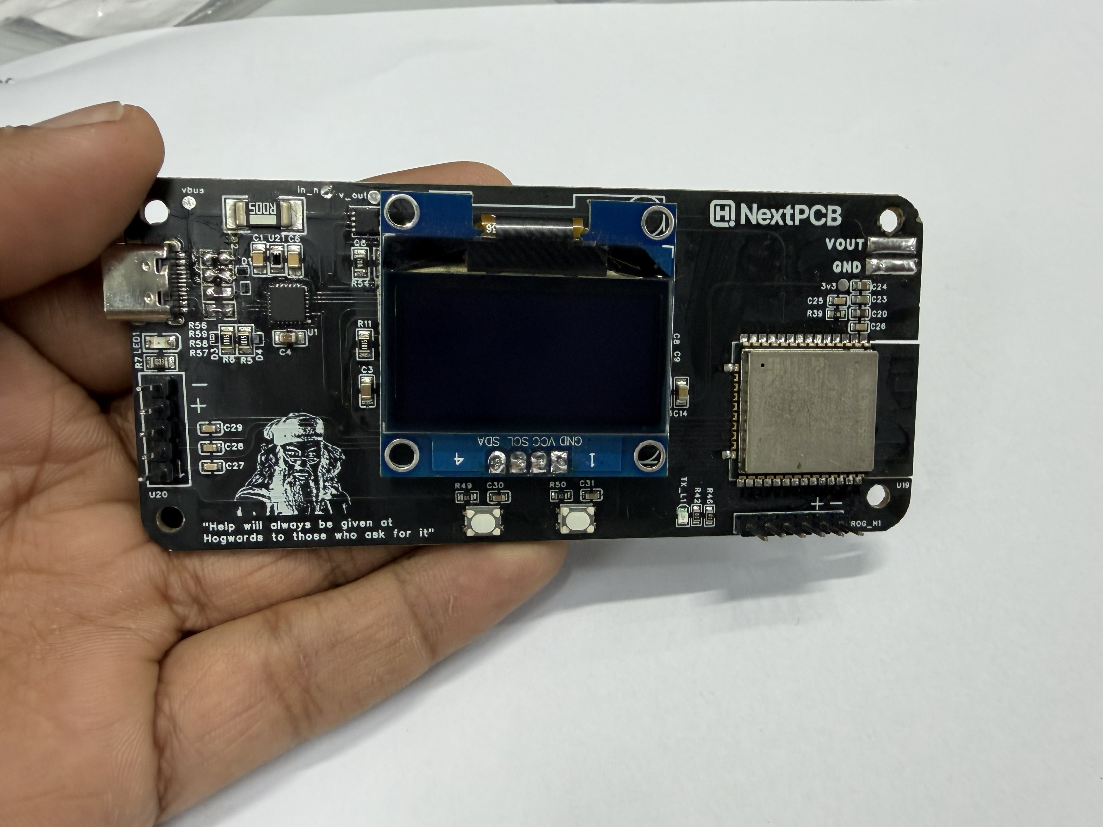

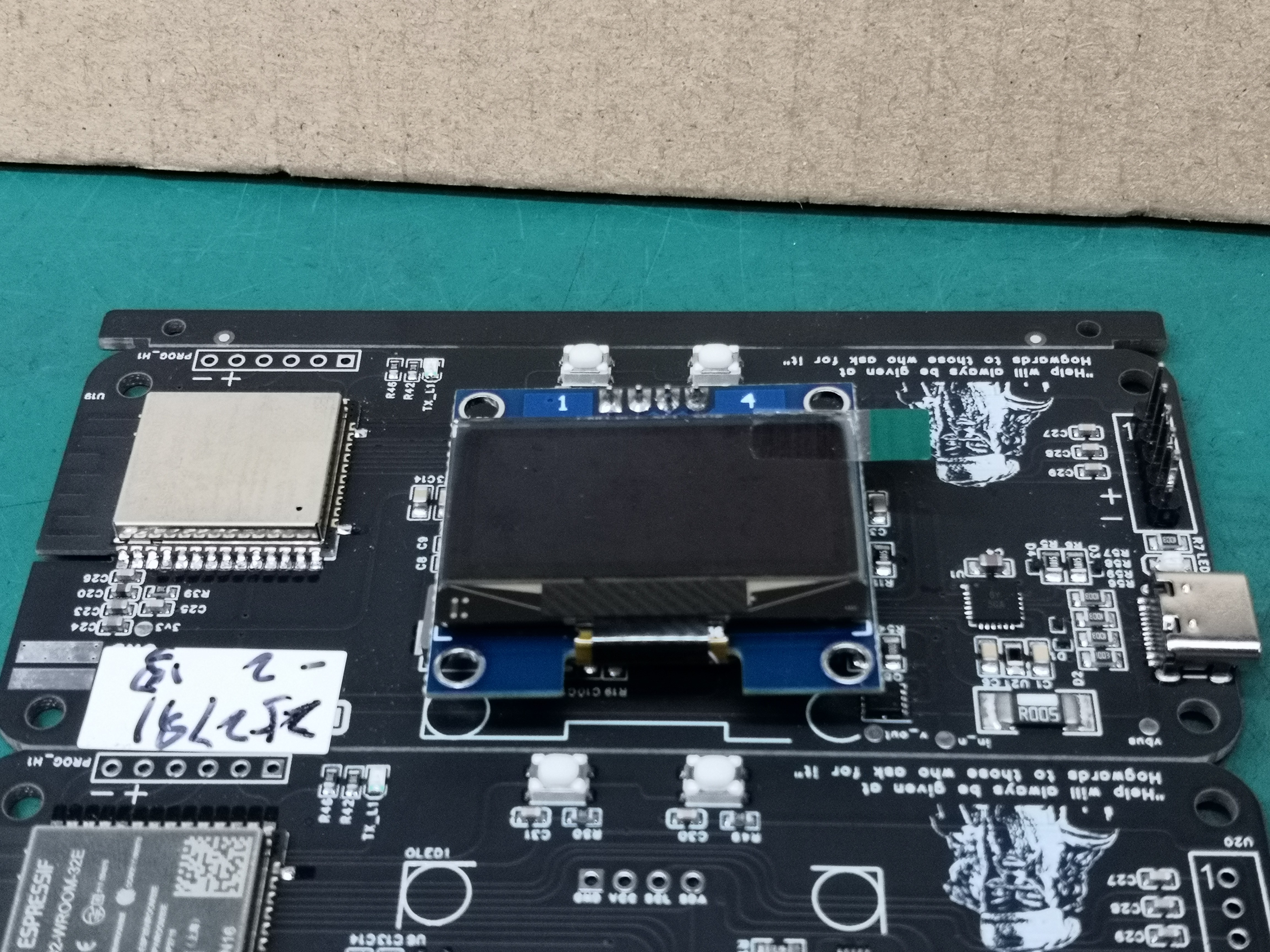

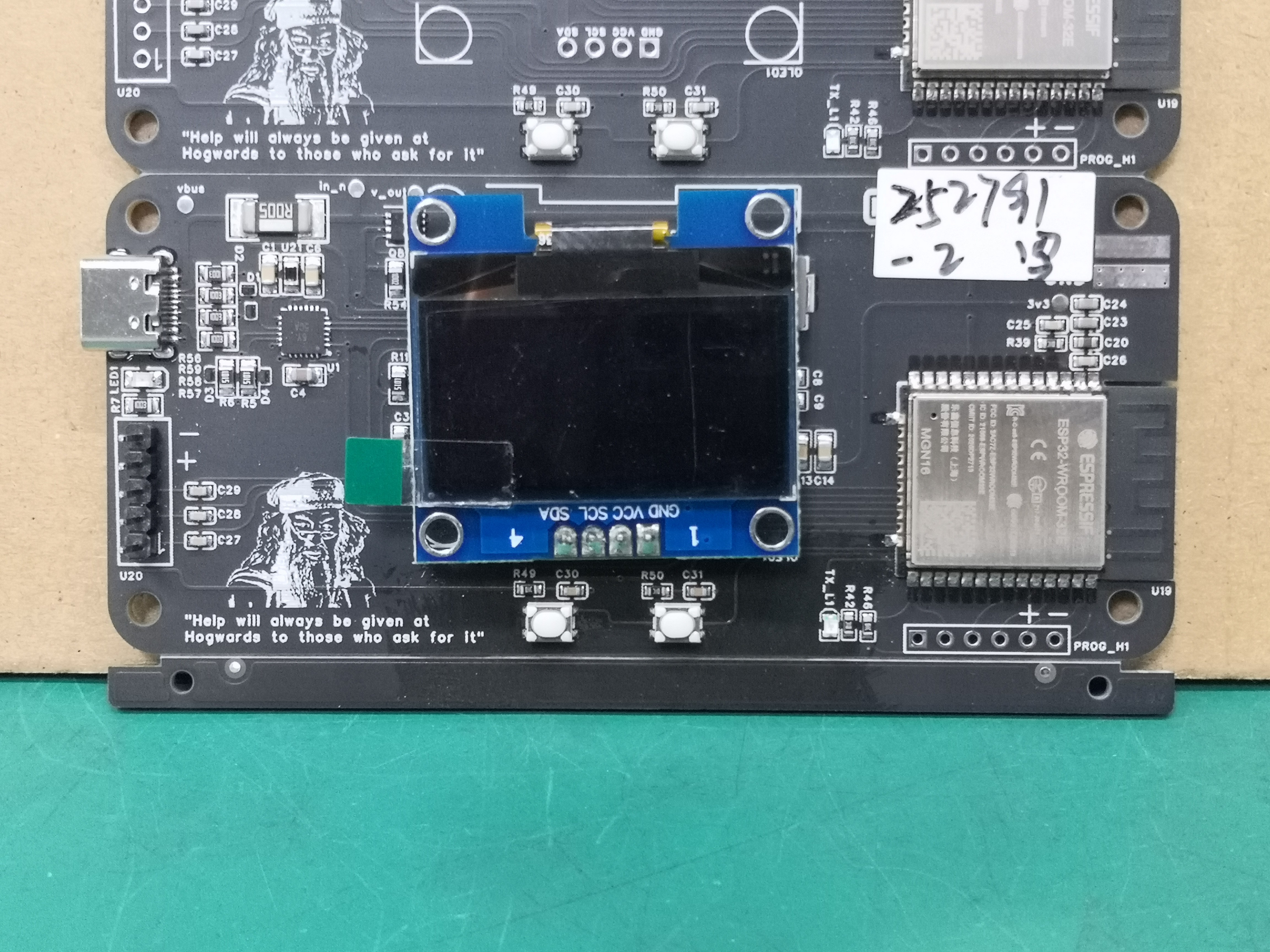

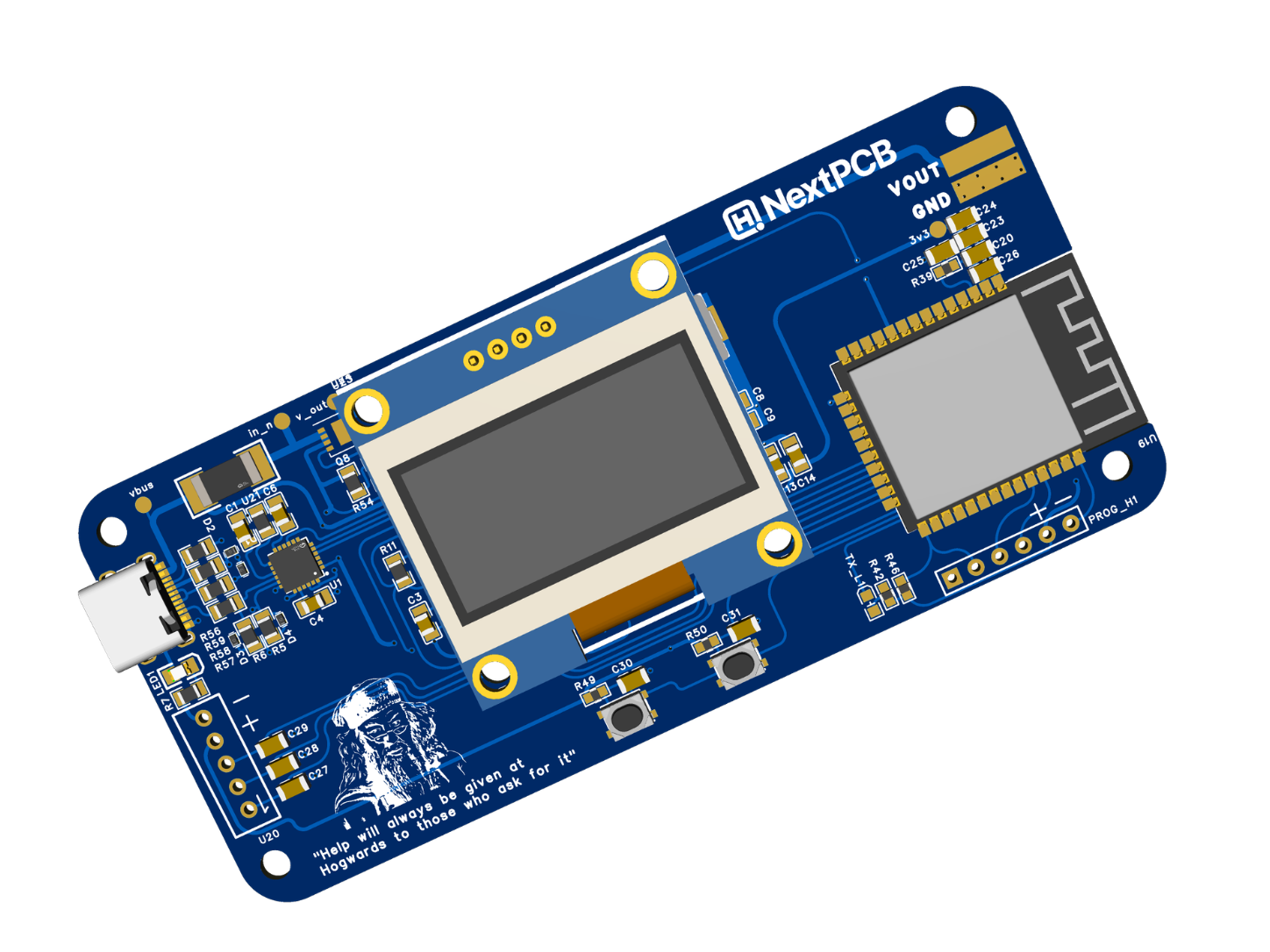

PCB DESIGN
My friend Rabindra designed the PowerPD PCB in EasyEDA.
The AP33772S USB-C PD controller is placed close to the USB Type-C connector to keep the CC traces short and clean. The INA226 is positioned right next to the 5 mΩ shunt resistor so it can use proper Kelvin sensing for accurate current measurement.
The AP33772S was placed close to the USB-C connector to keep the CC traces short and clean. The INA226 was positioned directly beside the current shunt resistor to improve measurement accuracy.
Since the design uses several fine-pitch components, including the USB-C connector and PD controller, I decided to have the boards professionally assembled rather than hand soldering everything.
The finished PCB contains the ESP32 module, AP33772S PD controller, INA226 monitor, buck converter, 3.3V regulator, MOSFET output stage, OLED interface, and programming header.
PCB ASSEMBLY
For fabrication and assembly, I used NextPCB.
After generating the Gerber files, BOM, and pick-and-place data, the files were uploaded for assembly. Before shipping, assembly photos were provided so the component placement could be verified.

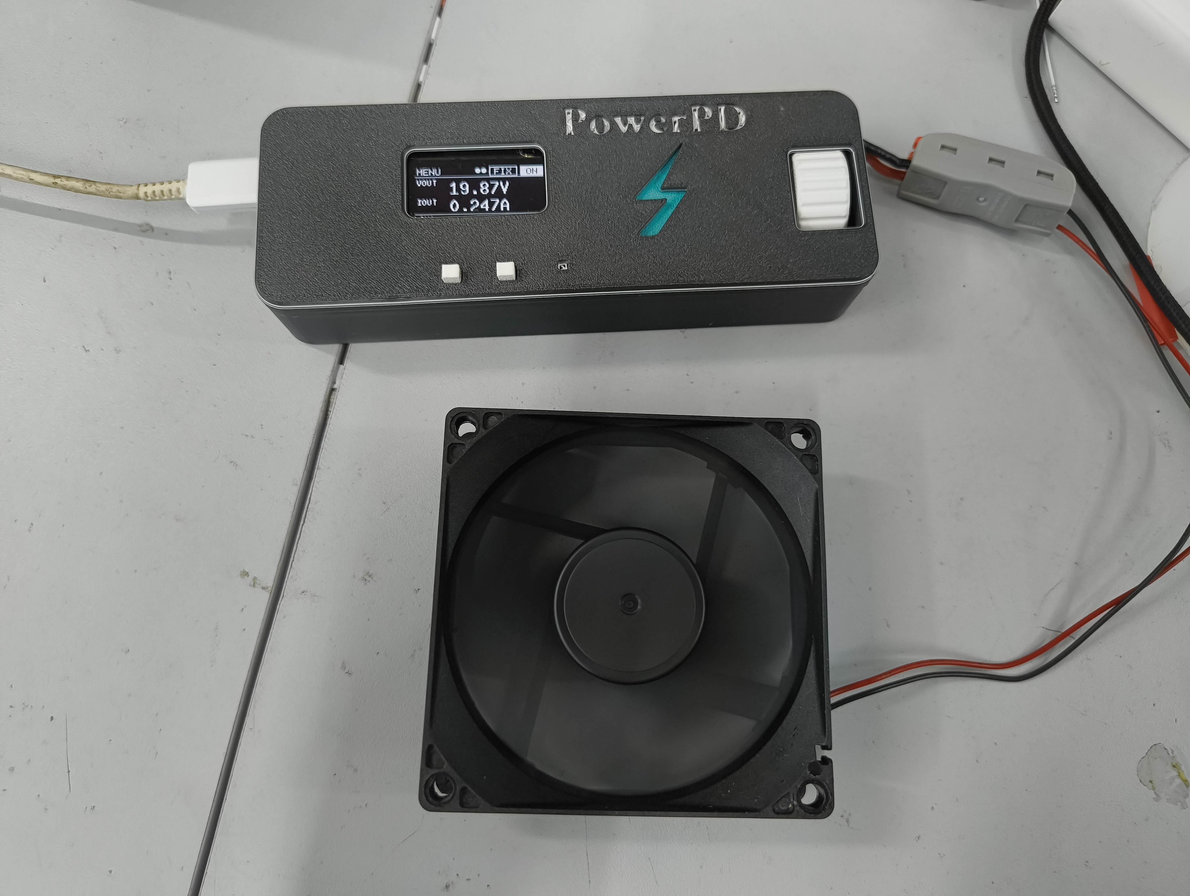

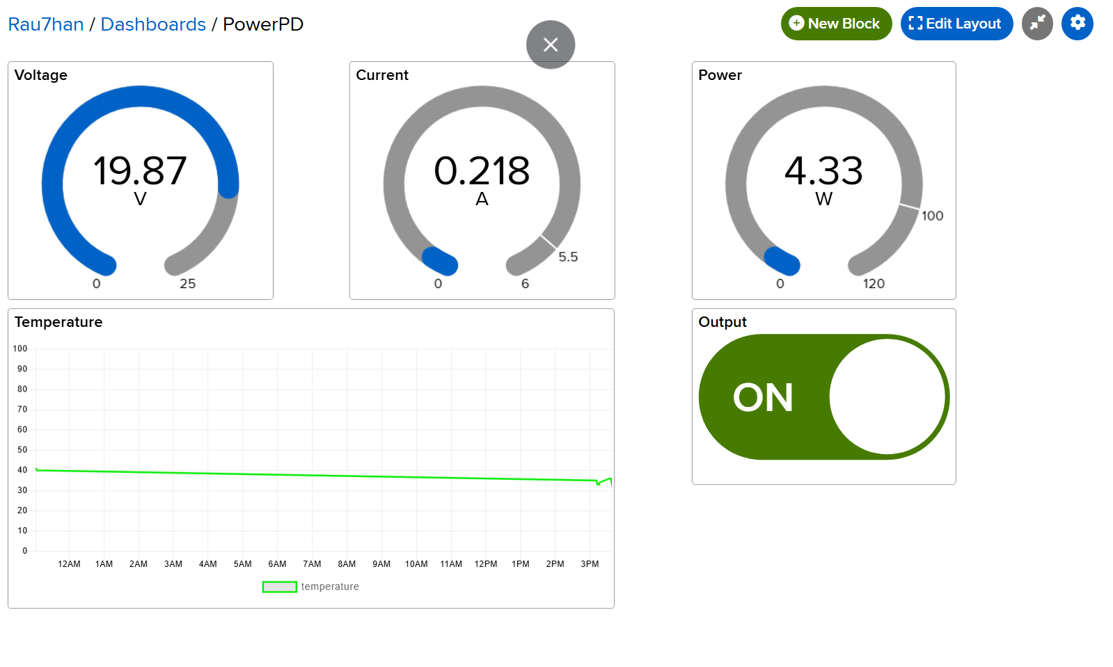

- Adafruit IO communication
- System monitoring
On startup, the ESP32 reads the available PD profiles from the connected charger and presents them through the user interface.

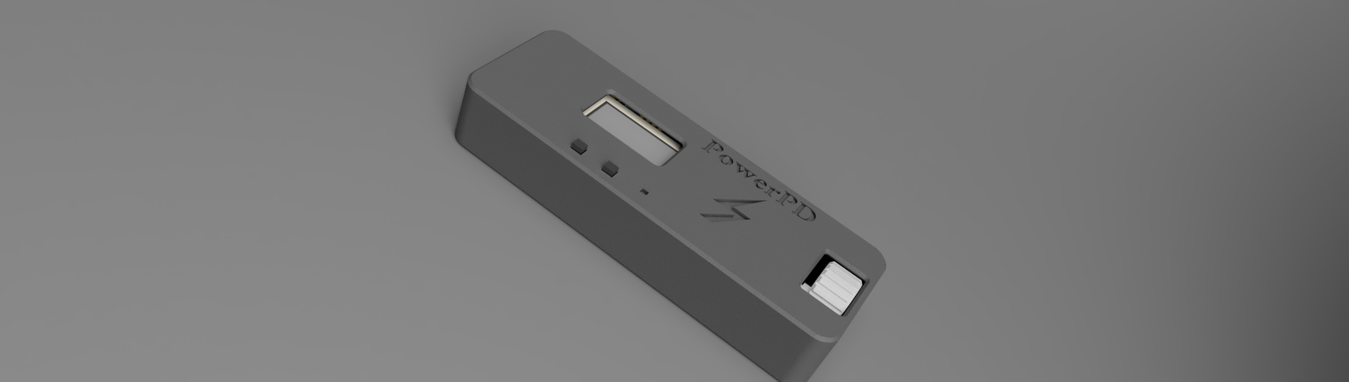

ENCLOSURE
The enclosure was designed in Autodesk Fusion 360 and consists of three main parts:
- Front panel
- Main housing
- Rotary encoder knob
The design was kept compact while still providing access to the OLED display, USB-C connector, output terminals, and controls.
All enclosure parts can be printed using standard PLA on a desktop 3D printer.

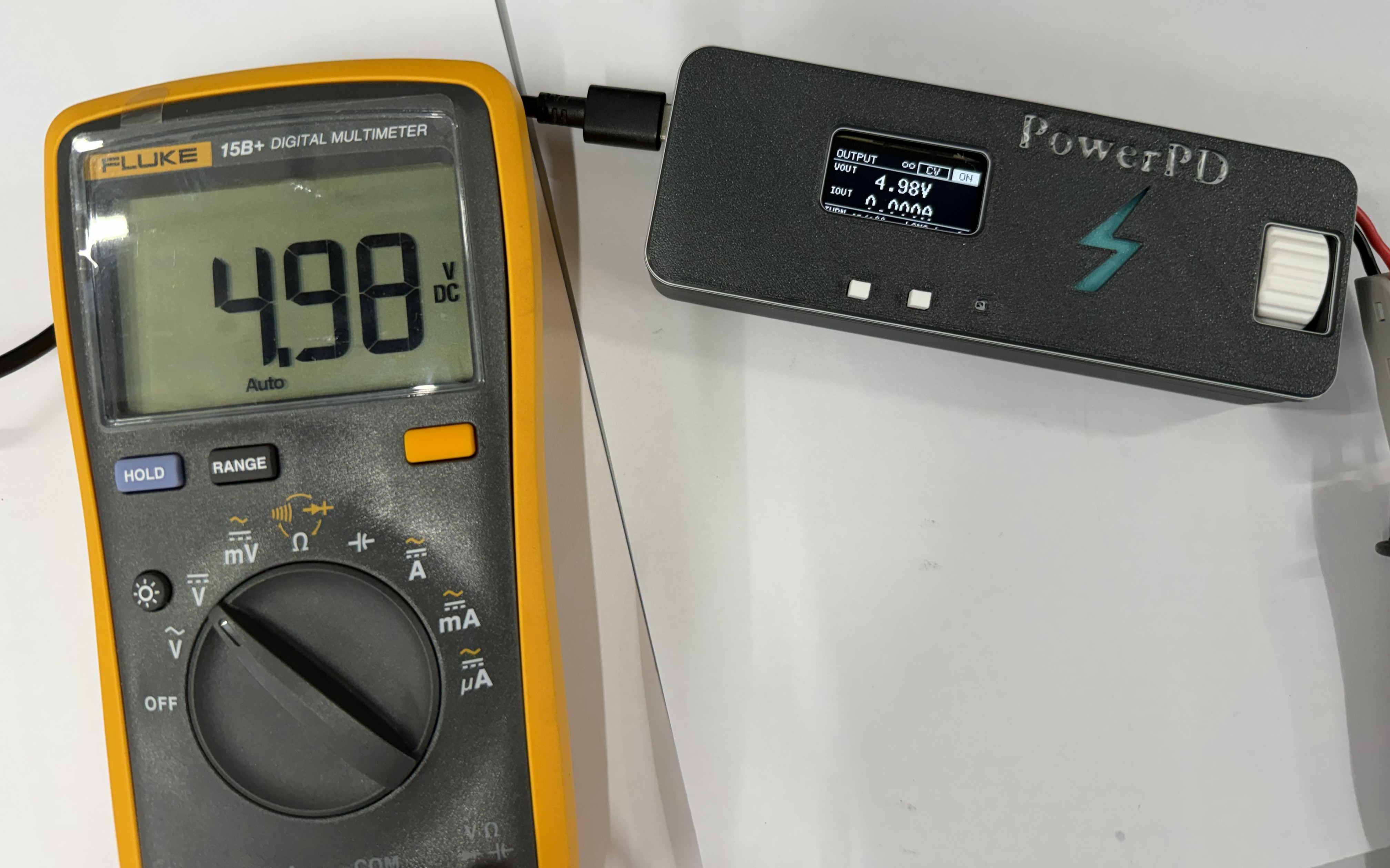

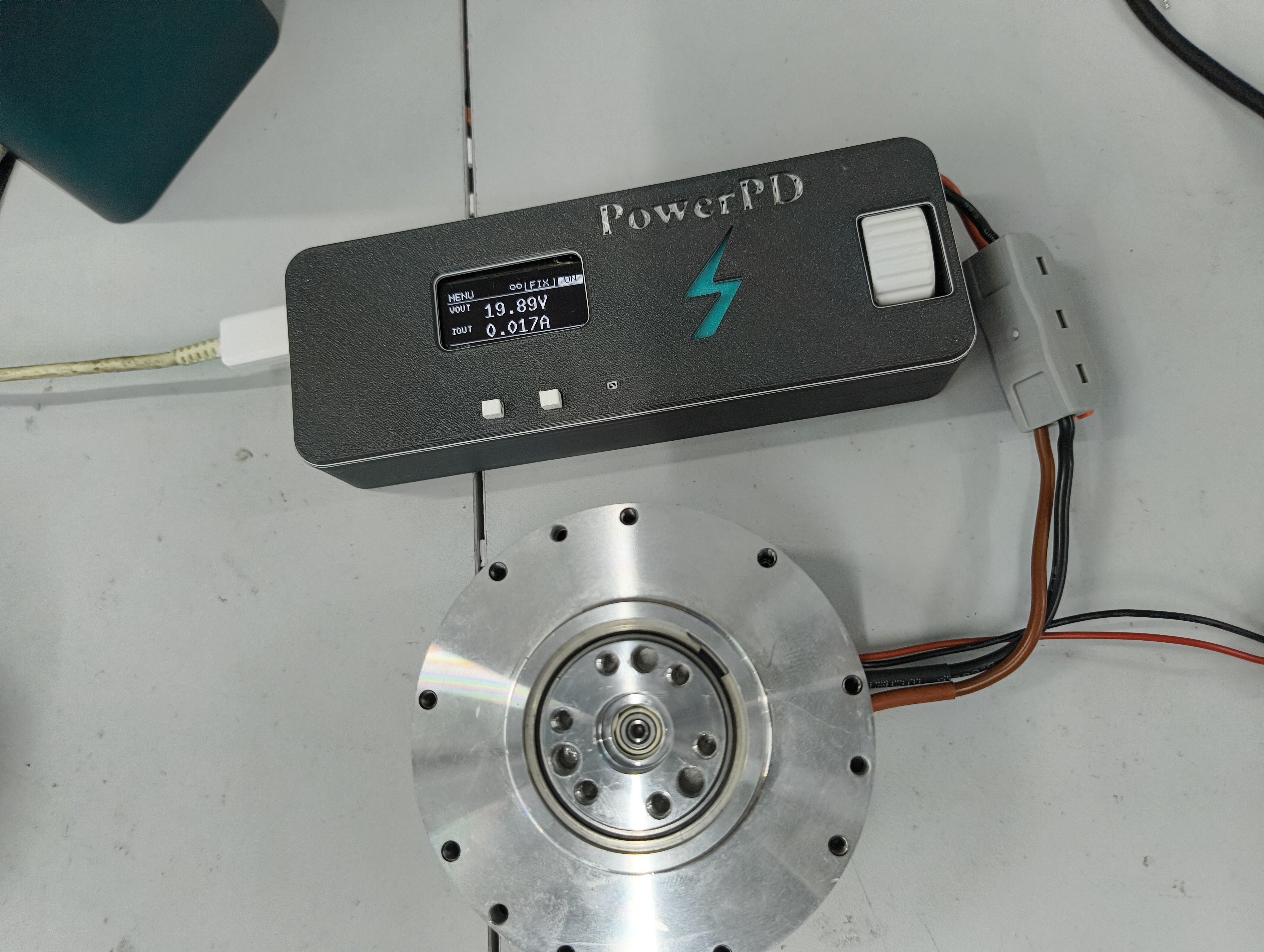

TESTING

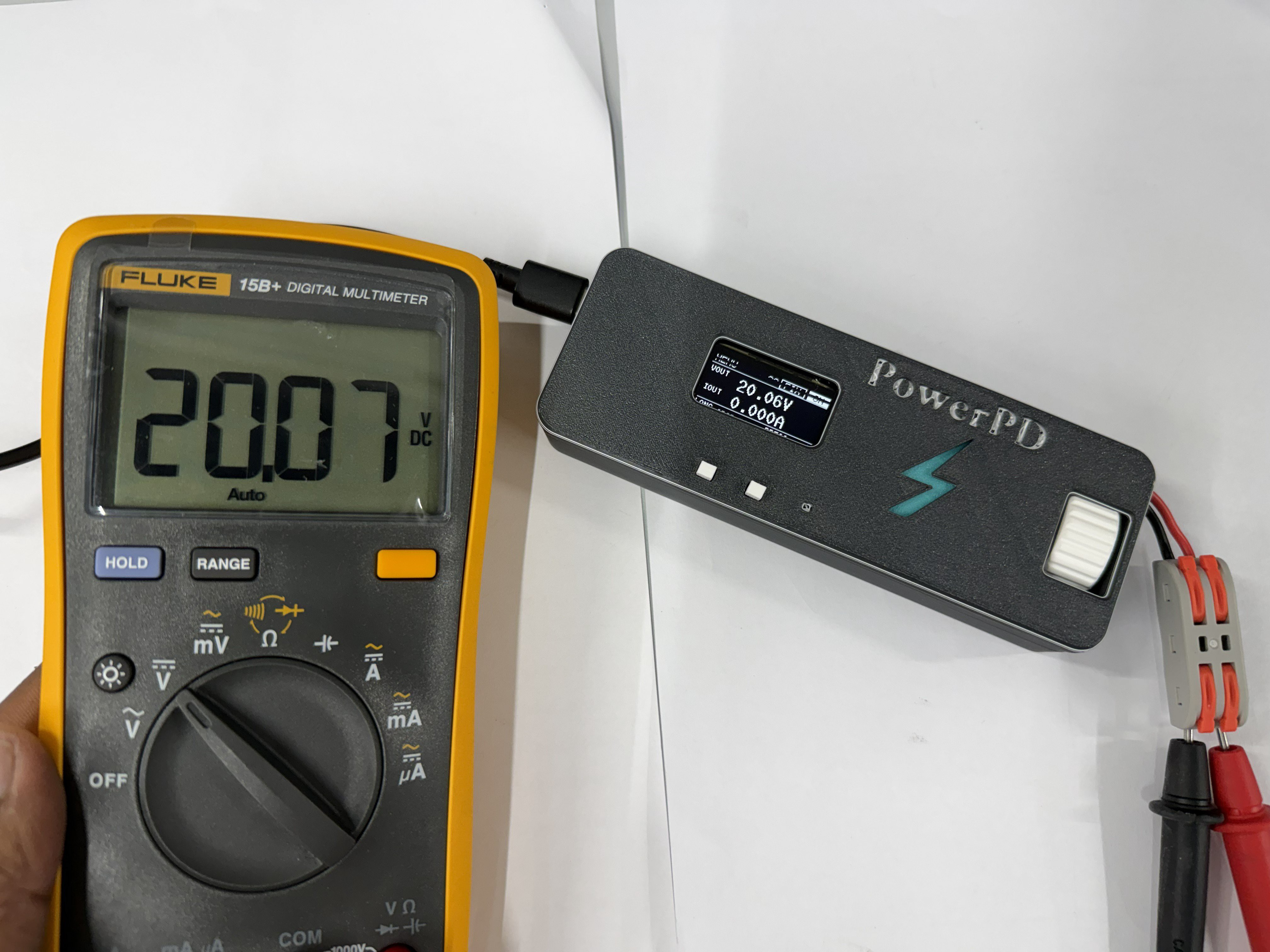

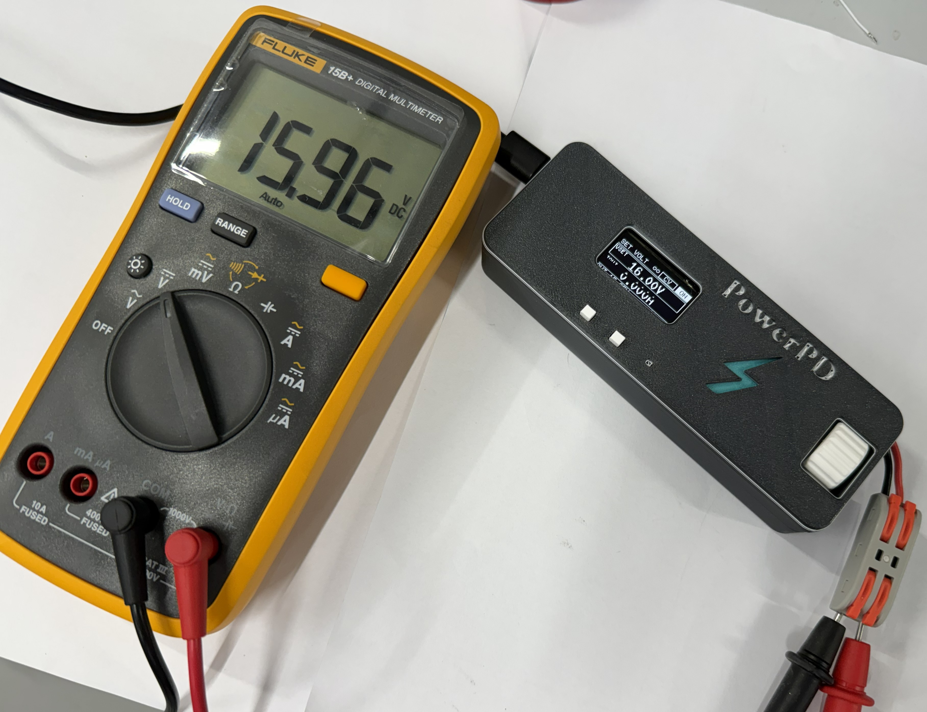

Testing was performed using several USB-C PD chargers supporting different power profiles.
After powering the board, I verified the negotiated output voltages using a multimeter. The measured values closely matched the values reported by the INA226 and displayed on the OLED.
I also tested PPS operation by selecting intermediate voltages through the rotary encoder and confirming the resulting output voltage....
