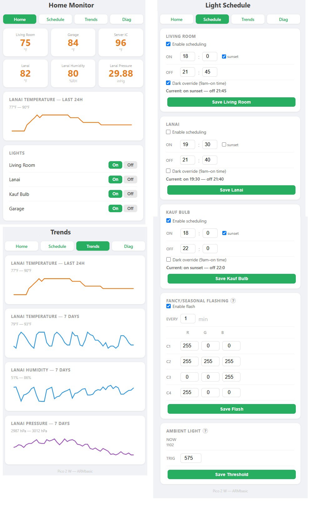

    Finally have a weeks worth of data for my home monitor system. Been changing so much.
    So what is included
    • Pico2W handling the webserver and controls
    • the second CPU in the Pico 2W handling an LCD display
    • 2 temperature sensors (living room and garage)
    • 1 temp/humidity/pressure sensor in lanai
    • 2 Shelly plugs controlling lights
    • 1 Kauf bulb over the entry way with flashy red/white/blue every couple minutes
    • 1 PIR sensor on PicoW which controls a Kasa plug lights in a dark garage (my wife thinks this is the best part)
    • Ambient light sensor will turn on a selected light when dark during daytime storms
    • Control of lights based on sunset or time
    • Cloudflare tunnel to access from anywhere
    Here are 3 of the 5 pages served by the RPi Pico 2W,  The other 2 pages are diagnostic info.  Of note that diag keeps track of active vs wait time, and the 2W is idle 97% of the time
