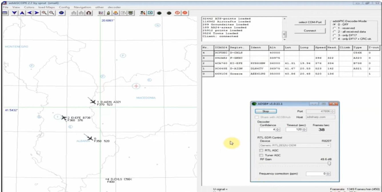

ADS-B, which stands for Automatic Dependent Surveillance-Broadcast, is the modern standard for tracking aircraft. It has largely replaced traditional radar as the primary method for air traffic control (ATC) across the globe. In one of my previous videos, I described a way to receive and decode ADS-B signals via an RTLSDR dongle using a special antenna and software.

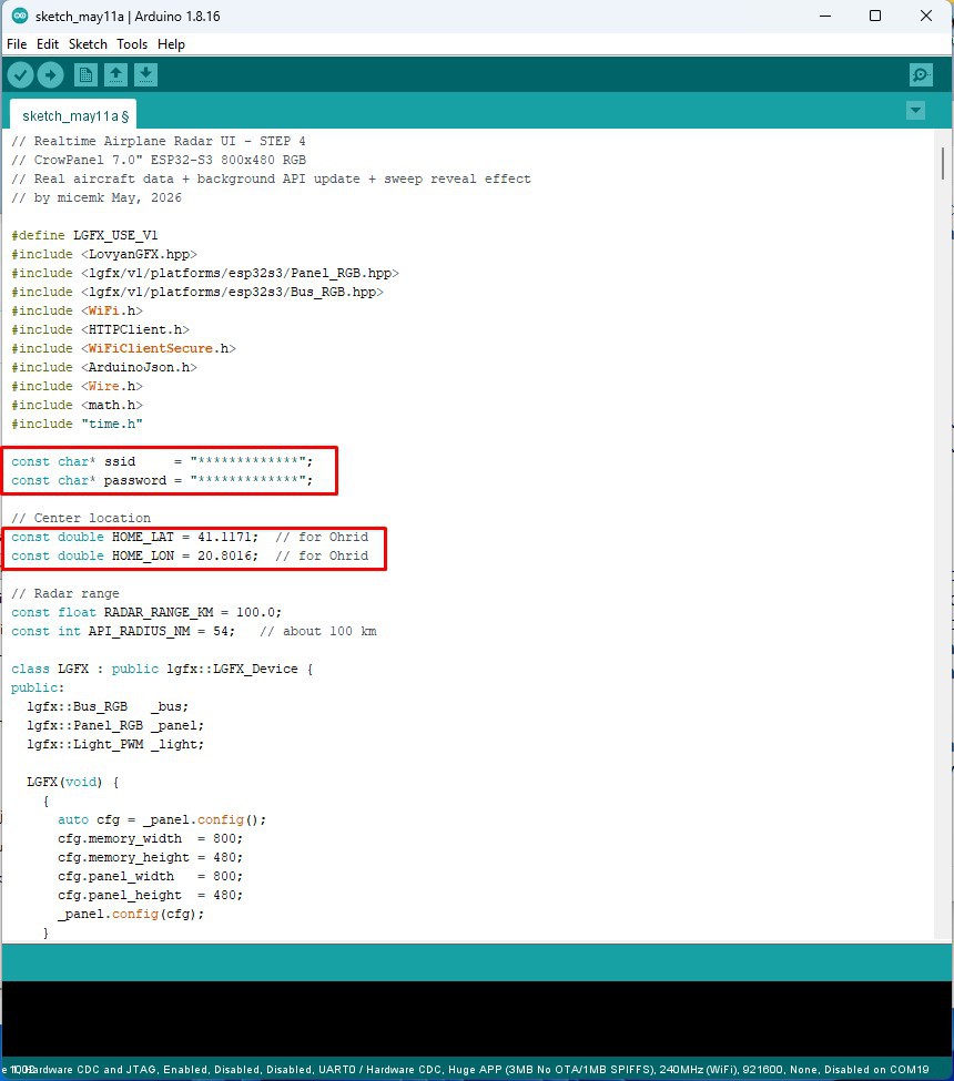

First let me describe how to install the software, because that's the only thing we need to do well to turn this display module into a professional looking aircraft tyracking radar. According to the manufacturer's instructions, we need to install ESP32 Core version 2.0.14 or 2.0.15. Then, in the Board Manager, we need to select Board: ESP32S3 Dev Module. Now we need to make a few settings for this board:
- USB CDC On Boot: Enabled
- Flash Mode: QIO 80MHz
- Flash Size: 4mb
- Partition Scheme: HUGE APP
- and PSRAM: OPI PSRAM
  As for the code, we first need to enter the Wi-Fi credentials and the coordinates of the home position (latitude and longitude). We can also change a few parameters, such as colors and shades, then sweep speed, maximum number of detected aircraft, and more.
