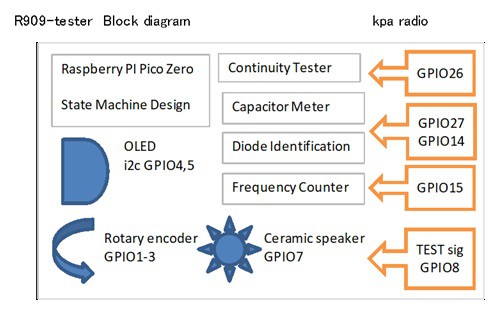

Hardware Concept
The hardware is intentionally simple:
The design philosophy is to keep the hardware accessible to hobbyists while implementing measurement functions primarily in software.

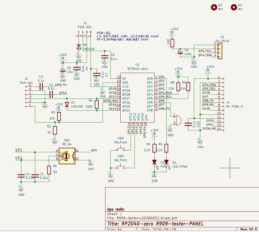

The circuit diagram of R909-tester

  • R909-tester PCB is ready, but found a bug during assembly!
    nobcha07/25/2026 at 10:11 0 comments
    To speed up my experiments and add more features, I decided to design and build a custom PCB. However, during PCB layout, I accidentally flipped the orientation of the I2C pin header for the OLED display and routed it on the wrong side! Fortunately, it doesn't affect debugging at all—I just mounted the display turned around, and it works fine for now.
    https://nobcha23.hatenablog.com/entry/2026/07/20/191050

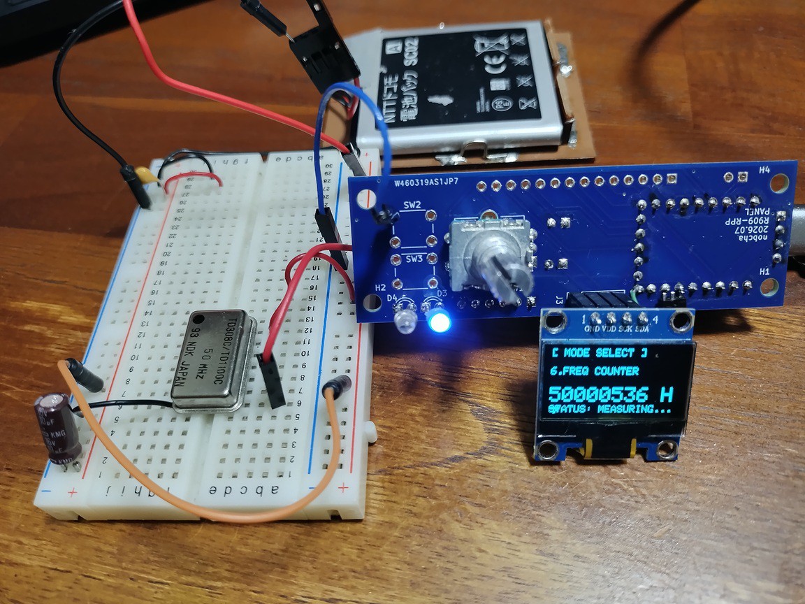

    The tester includes a continuity tester, capacitance meter, diode checker, and a frequency counter. Surprisingly, the frequency counter responds up to 50 MHz!
    ---50MHz displaying

  • Hardware Design: From Breadboard to Prototype
    nobcha07/04/2026 at 15:31 0 comments
    In the previous log, I talked about why this project exists. Now, let's get into the what – the hardware.
    The core of this instrument is the Raspberry Pi Pico Zero (RP2040) of Waveshare. It's cheap, powerful, and has enough I/O to handle all the functions I wanted to pack into this tester.
    Here’s a quick tour of the main hardware blocks.
    The Brain: Waveshare RP2040 Zero
    I chose the Pico Zero because it gives me a complete, ready-to-use RP2040 board in a compact form factor. It already has the large flash memory, and the USB port, so I can focus on the application circuitry. The dual-core Cortex-M0+ and the PIO (Programmable I/O) are also big pluses – especially for the frequency counter, which I'll talk about in a later log. Comparing with ATmega328P it's attractive for USB-IF and large memory.
    User Interface: OLED + Rotary Encoder
    For display, I'm using a small SSD1306 OLED (I2C interface). It's simple, low-cost, and perfect for showing measurements and menus. The rotary encoder (with a built-in push switch) handles all user input: turn to select functions, press to confirm. No touchscreen, no complex keypad – just a clean, minimal interface.
    Continuity Tester:
    This uses a simple voltage divider on an ADC pin (GPIO26). The firmware reads the voltage and decides if the circuit is open or shorted. V-open and I-short is enough small to avoid bad influence for the circuit on testing. I
    There's also a buzzer (on GPIO6) that gives audible feedback – because sometimes you just want to listen for the beep.
    Capacitance Meter:
    This is based on the classic RC charge time method. A known resistor (100kΩ) charges the capacitor through a test terminal, and the firmware measures the time for the voltage to reach 63.2% of the supply voltage (VCC) on an ADC pin (GPIO26). From that time (τ = RC), it calculates the capacitance. There’s a small trick to discharge the capacitor quickly between measurements using a GPIO pin as a switch. At first I let GPIO26 change as a digital port, but in vail GPIO26 will not work so.
    Frequency Counter:
    This one uses the RP2040's PIO feature. The PIO can count pulses very fast and accurately without bogging down the CPU cores.
    Diode Identifier:
    This function measures the forward voltage drop (Vf) of a diode using a constant current source.
