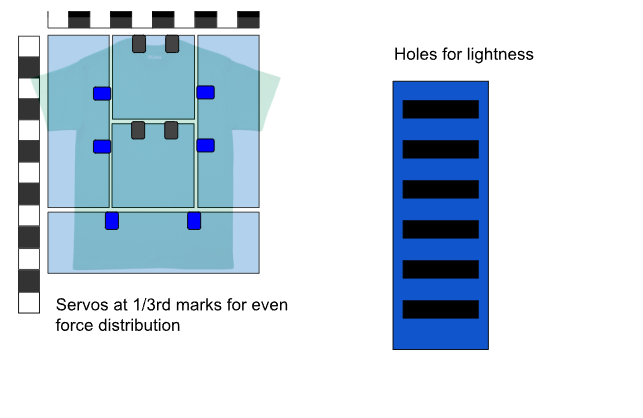

    Cut cardboard flaps
    Take one of your shirts and make folding lines where you would usually fold. Use those to find the dimensions of your cardboard flaps.

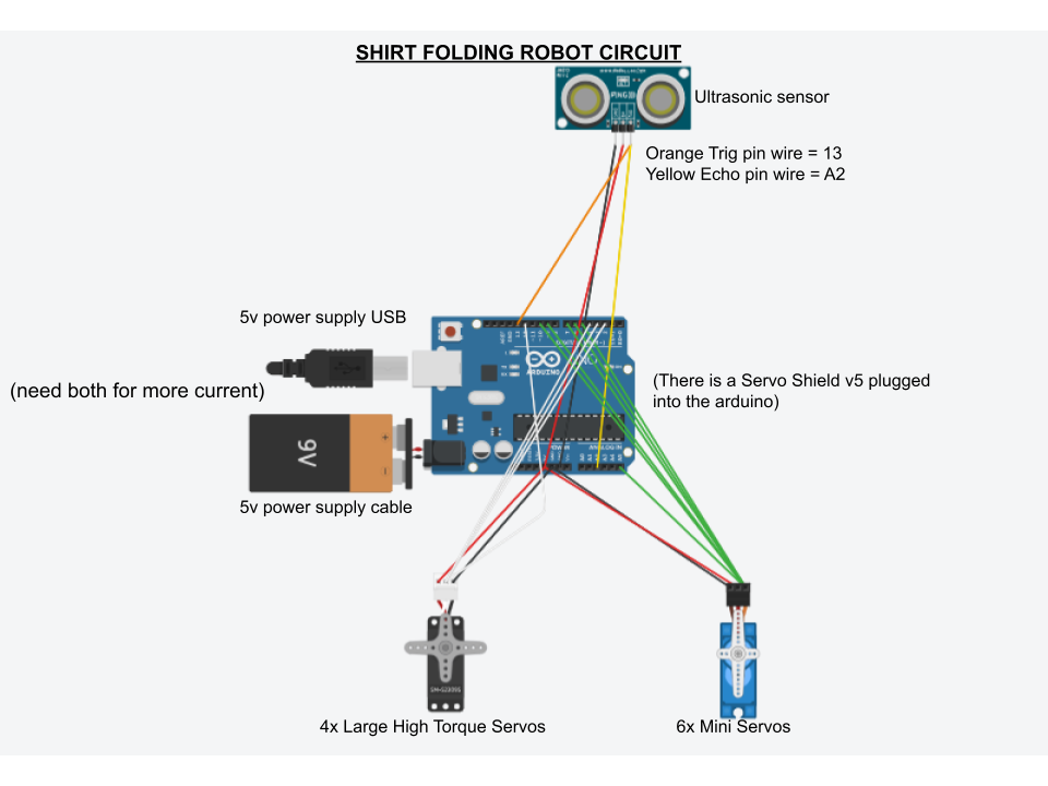

    Wire servos and ultrasonic sensor to an arduino using a breadboard or servo shield.
