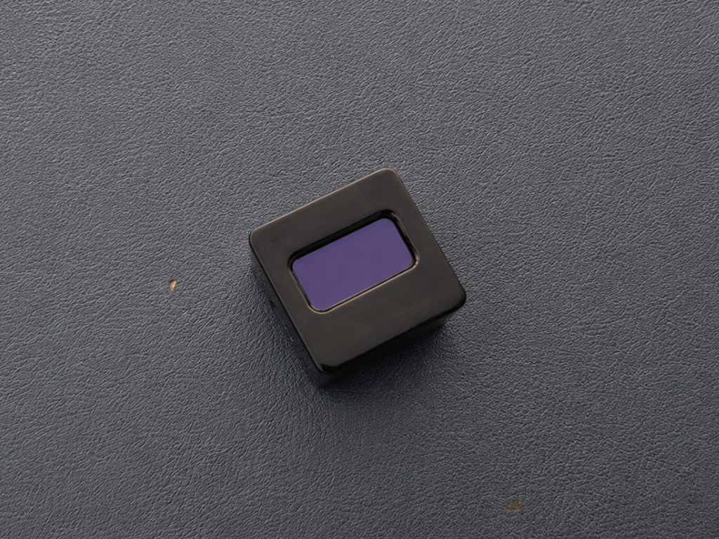

2Display Assembly
Carefully insert the 0.96-inch OLED display into the front opening of the housing, ensuring that it sits straight and flush with the front surface. Once you're happy with the alignment, secure it using a small amount of super glue around the edges.
Avoid using too much glue, as it may seep onto the display or make disassembly difficult in the future. A few tiny drops are all that's needed to hold the display firmly in place.

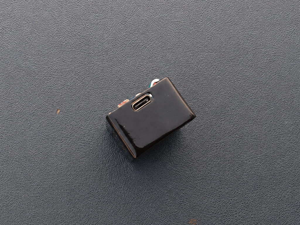

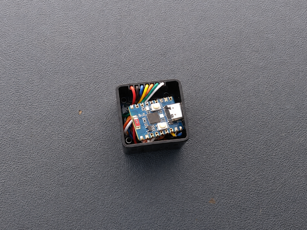

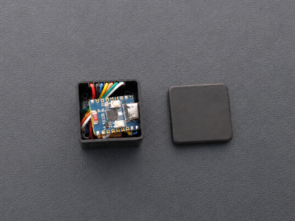

4Assemble the MCU
With the display wired up, carefully place the ESP32-C3 Zero inside the enclosure. Arrange the wires neatly so they fit comfortably without putting stress on the solder joints.
Make sure the USB Type-C connector is aligned with the opening in the side of the case. This allows you to easily upload the code or power the clock.

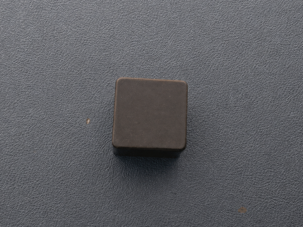

5Final Assembly
With everything assembled, it's time to close up the enclosure. Carefully place the cover onto the housing, making sure it sits flush on all sides. Once you're happy with the fit, apply a small amount of super glue around the edges to secure it in place.

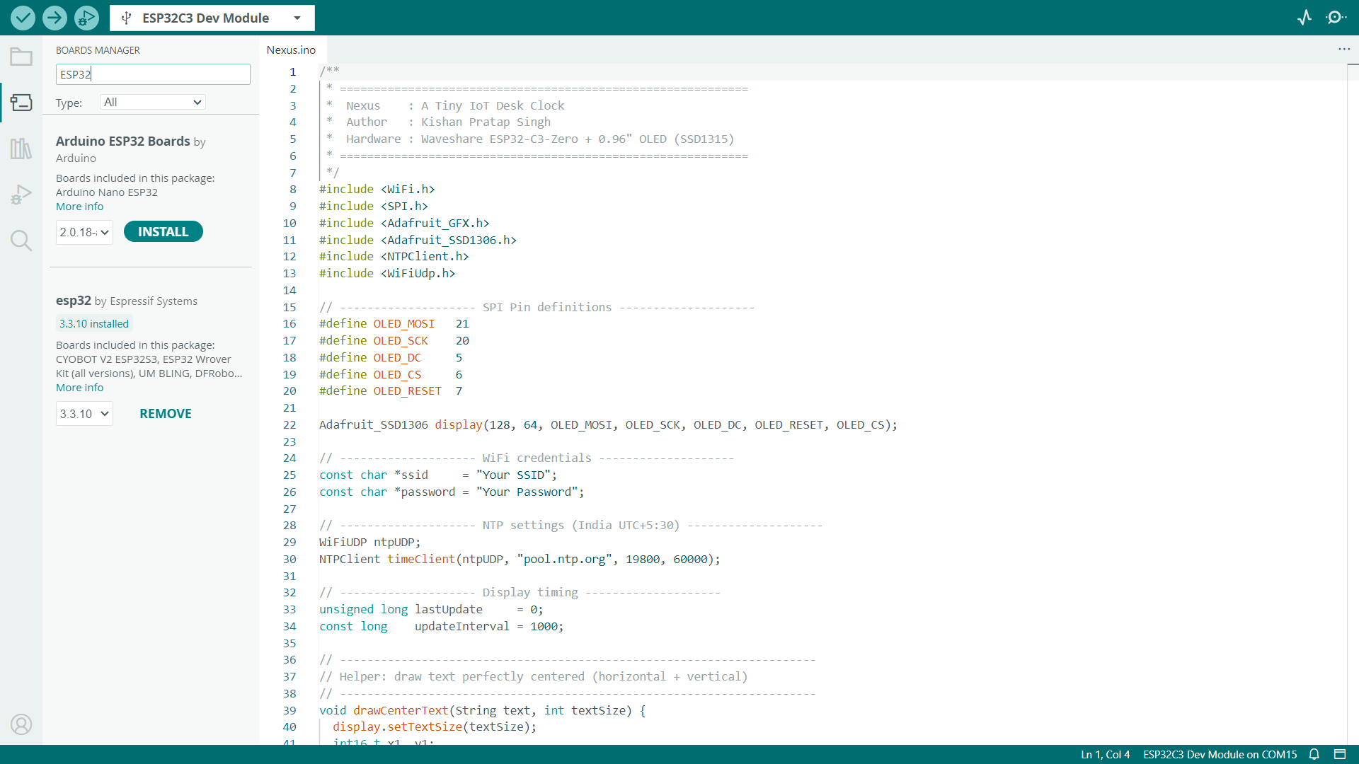

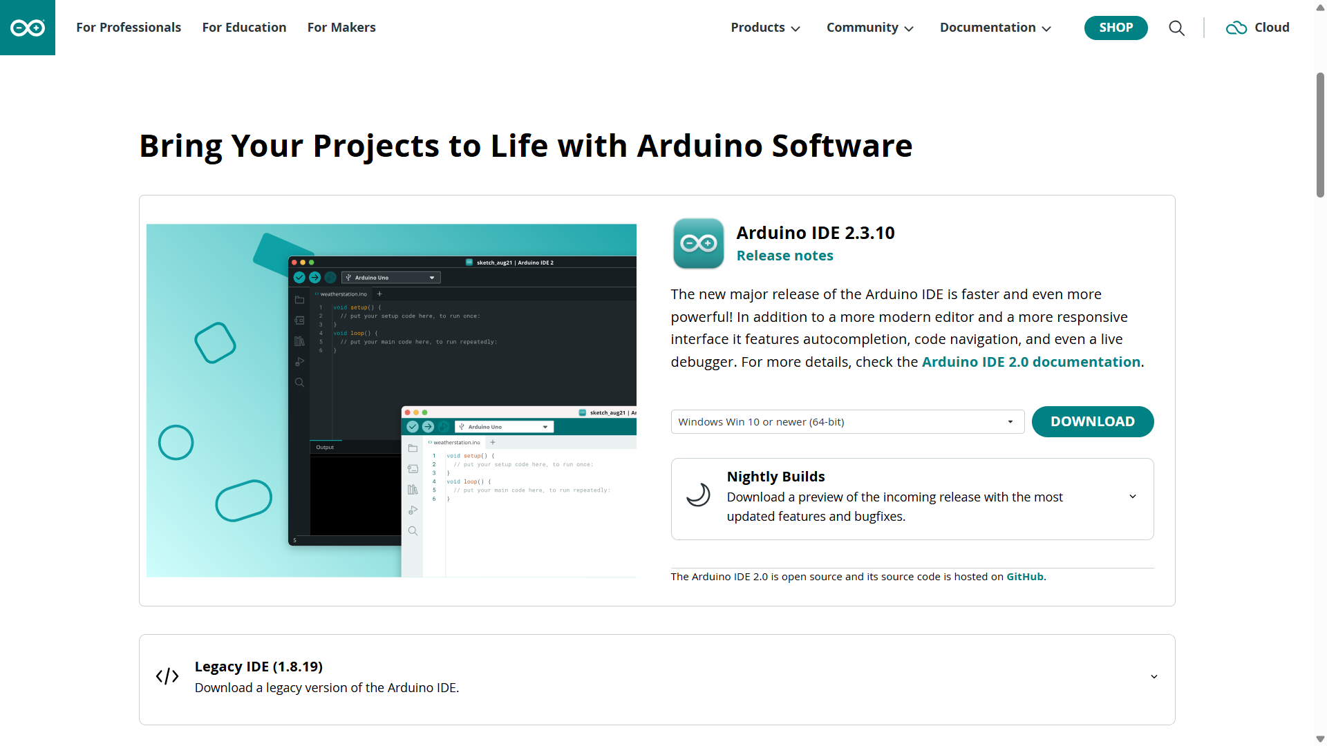

6Set Up the Arduino IDE
Before uploading the code, you'll need to install the Arduino IDE and add support for ESP32 boards.
Install Arduino IDE
If you don't already have it installed, download and install the latest version of Arduino IDE 2.x from the official Arduino website.

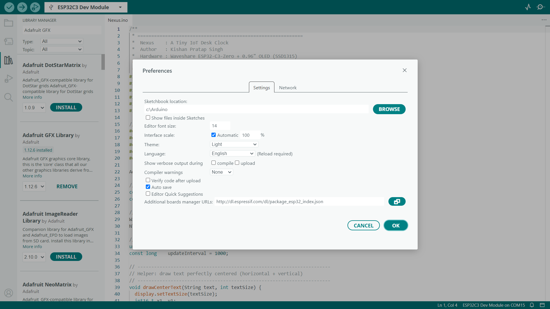

Add ESP32 Board Support
Open Arduino IDE and go to File → Preferences. In the Additional Boards Manager URLs field, paste the following URL:
https://espressif.github.io/arduino-esp32/package_esp32_index.json
If you already have other board URLs, simply add this one on a new line & Click OK to save your changes.
Install the ESP32 Boards Package
Go to Tools → Board → Boards Manager. Search for ESP32, then install the latest ESP32 by Espressif Systems package.

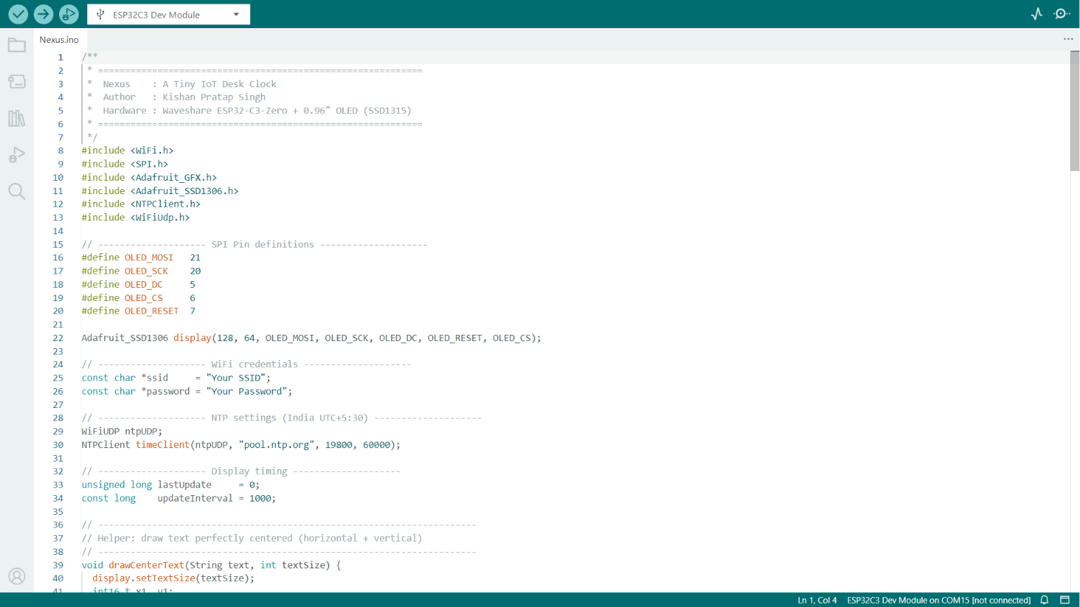

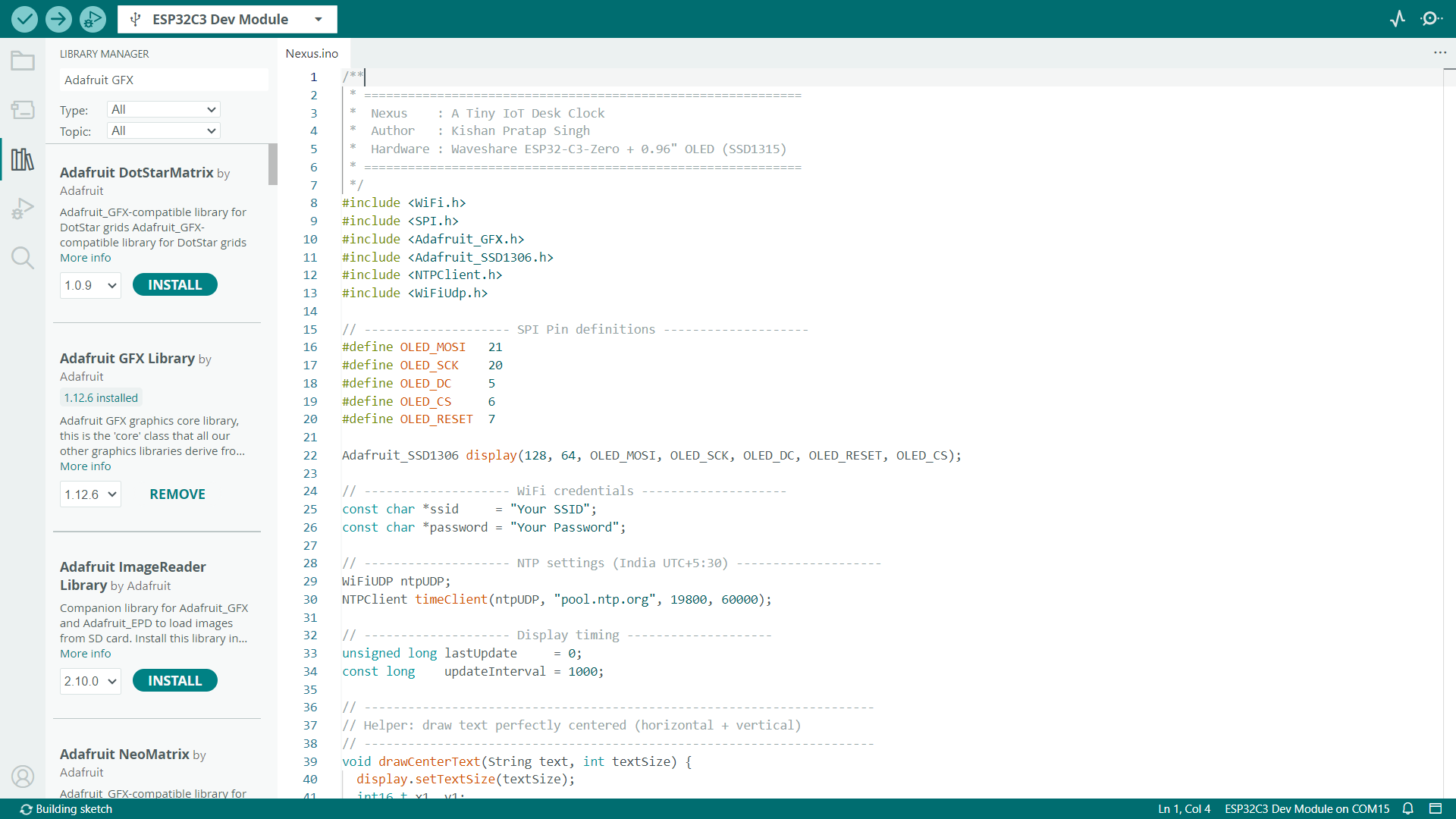

7Configure the Code
Download the project from the Nexus GitHub repository and extract the ZIP file. Open the Nexus.ino file in the Arduino IDE.
If this is your first time opening the project, make sure the required libraries are installed. Go to Sketch → Include Library → Manage Libraries... and install the following libraries:
- Adafruit GFX Library
- Adafruit SSD1306
- NTPClient
Once the libraries are installed, locate the Wi-Fi credentials in the code:
// -------------------- WiFi credentials -------------------- const char *ssid = "Your SSID"; const char *password = "Your Password";
Replace "Your SSID" and "Your Password" with your Wi-Fi network name and password.
Next, locate the NTP settings:
// -------------------- NTP settings --------------------WiFiUDP ntpUDP;NTPClient timeClient(ntpUDP, "pool.ntp.org", 19800, 60000);
The value 19800 is the UTC offset in seconds for India (UTC +5:30). If you're in a different country or time zone, replace it with the correct UTC offset for your region.

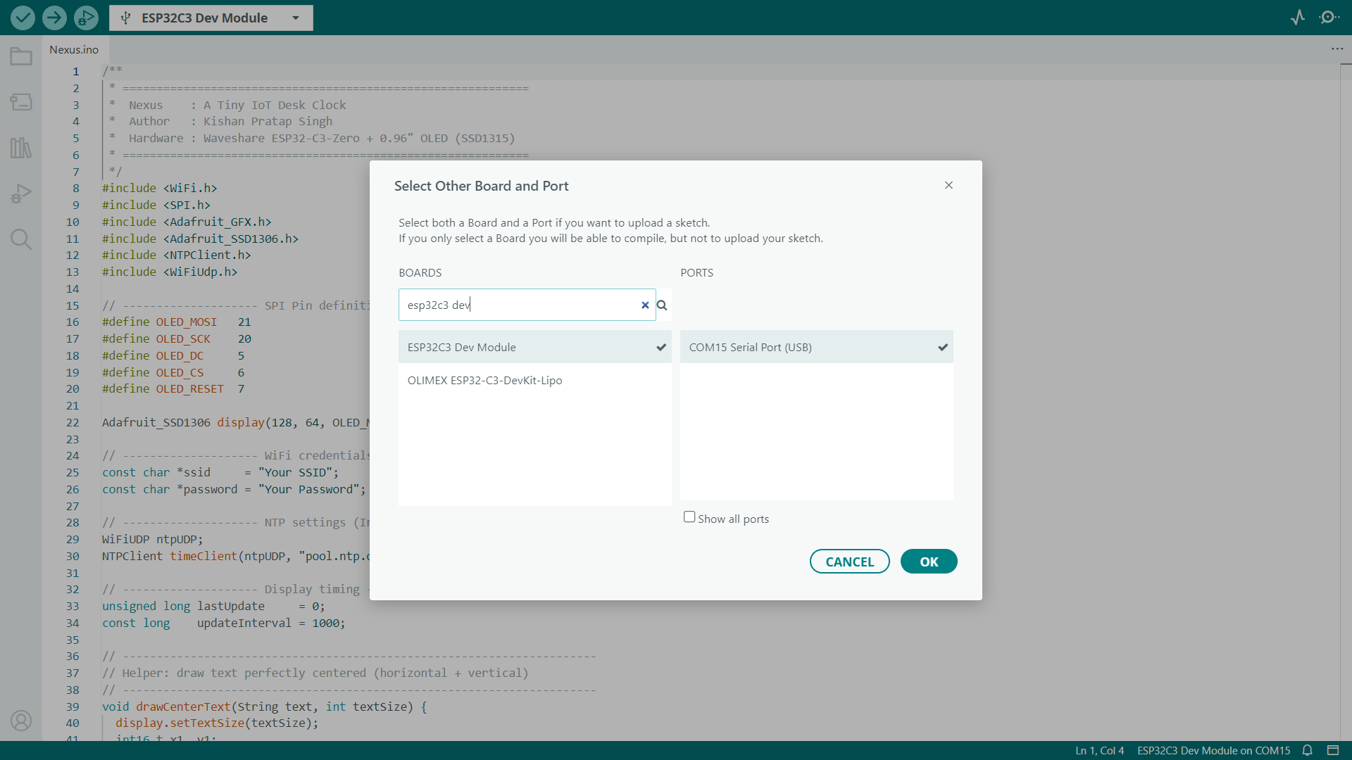

8Upload the Code
Now Connect the ESP32-C3 Zero to your computer using a USB Type-C cable. In the Arduino IDE, select the correct board and COM port, then configure the following settings from the Tools menu:
- Board → ESP32C3 Dev Module
- USB CDC On Boot → Enabled
- CPU Frequency → 160 MHz
- Core Debug Level → None
- Erase All Flash Before Sketch Upload → Disabled
- Flash Frequency → 80 MHz
- Flash Mode → QIO (use DIO if the upload fails)
- Flash Size → 4MB
- Partition Scheme → Default 4MB with SPIFFS (1.2MB APP / 1.5MB SPIFFS)
- Upload Speed → 921600
- JTAG Adapter → Disabled
Once everything is configured, click the Upload button and wait for the sketch to finish uploading.

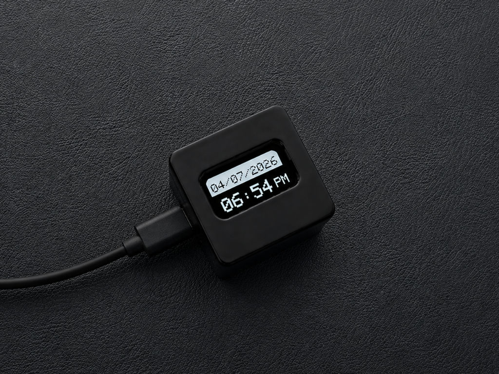

9Testing

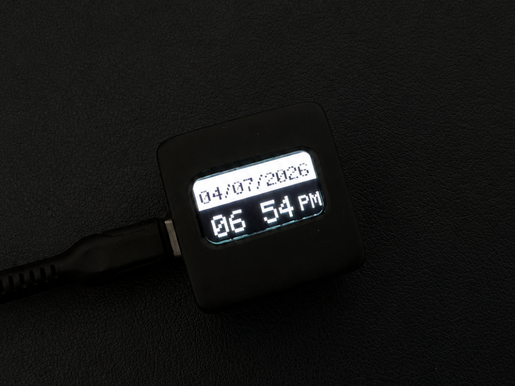

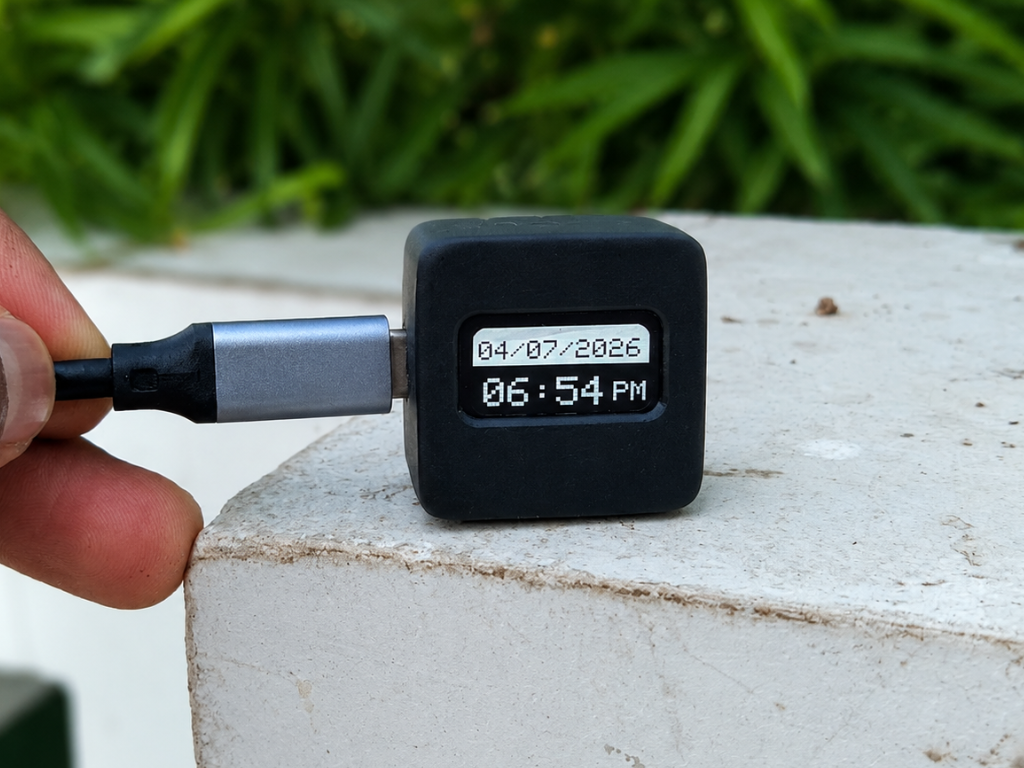

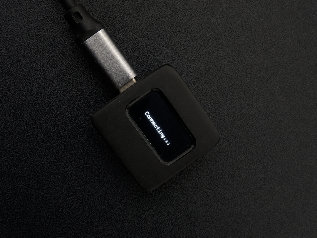

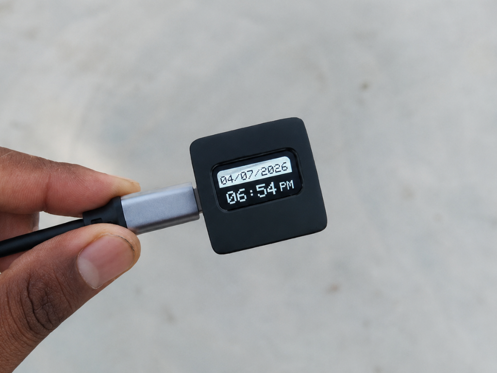

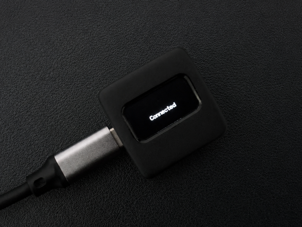

Now it's time to test your Nexus. Once the board powers up and connects to your Wi-Fi network, it will automatically synchronize with an NTP (Network Time Protocol) server to fetch the current date and time.
After a few seconds, the OLED display will show the current date at the top in DD/MM/YYYY format, while the current time is displayed below in 12-hour (HH:MM) format along with the AM/PM indicator.
10Final Thoughts
And that's it—your Nexus Wi-Fi desk clock is ready!
