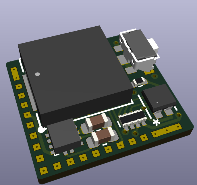

I decided on a module system, a separate PCB soldered into the main one. I looked long for a connector, so it would be easier to attach, but nothing comes close to just solder bridge the 2 things together. It takes some effort, but can be done just fine. On both sides the pads are small THT, so you can't break them off. After that it's sturdy and if needed, can be desoldered and swapped.
Please ignore the red cable, that has been fixed in a newer PCB revision :)
The first module I went with was the one above, some exposed pins and a RGB diode (It's not rotated because I couldn't buy one easily at that time, I use a 3D printed cover with some reflective paint to reflect the light...). In the newest revision it also has a small place for a frontlight diode on the other side.
I designed a second one since then, it has an IMU, buzzer, microphone (the buzzer gets integrated into the case and below the buzzer is the microphone, the 3D model just covers it). Didn't yet test it as my mind wandered to other projects, but it's a beginning:
It's obviously something not all people are interested in, removing the module area & merging the 2 PCB's in kicad is easy. People in the community have already done that successfully.

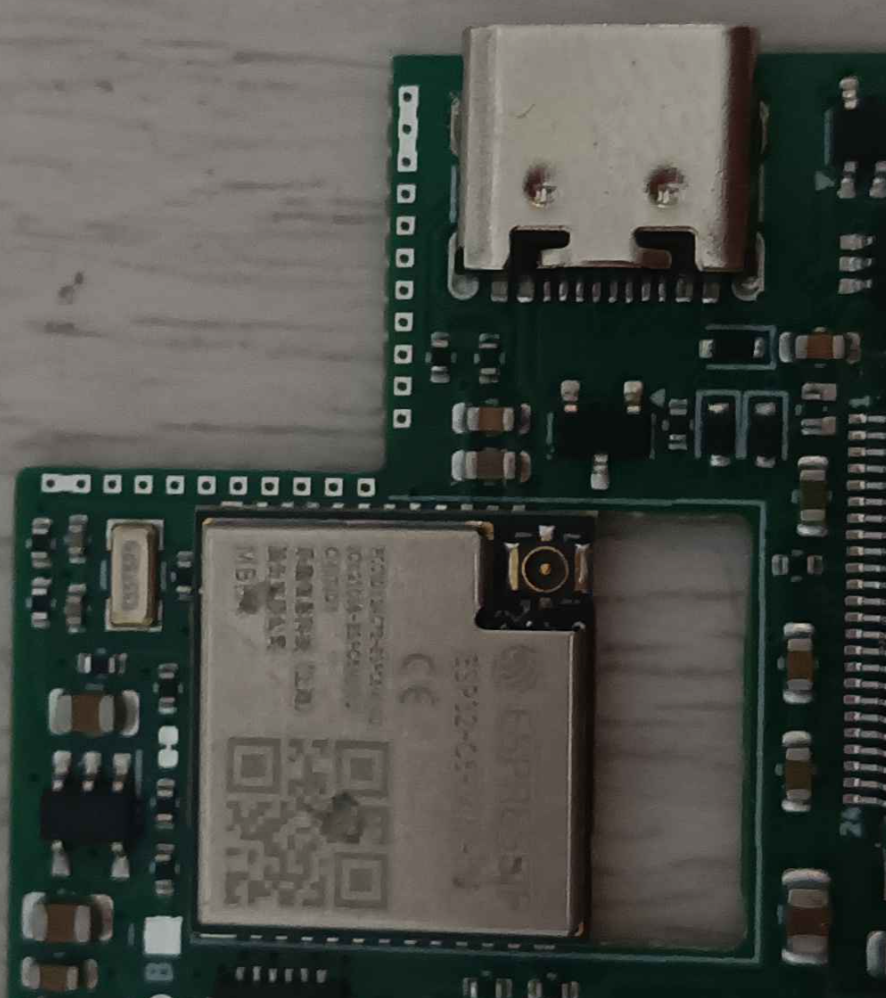

The USBC was harder (Yes, we need to switch to USBC for this, micro usb is not acceptable in this era), The only one was USB4730-GF-A-KIT with an acceptable height of the THT pins. It's on the bigger size, but that's a problem for the future me designing a case. There were already people switching it for another models, but I can't get myself to that, I only trust THT to survive.
A modified yatchy with another usbc port, that the THT pins needed to be cut off manually. The esp is without an integrated antenna because of the chip shortage. Credits go to Lukas from the DC server
