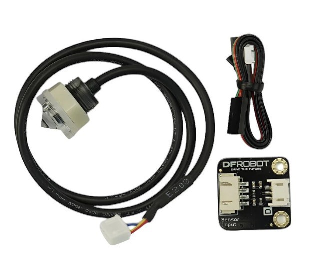

Recently I had an unpleasant experience in my home, specifically my ground floor was flooded as a result of a burst water pipe, and at that moment I was absent. So I decided to develop a warning system for such phenomena that would also take some action in order to prevent greater damage from occurring. For this purpose, I purchased the Gravity: Photoelectric High Accuracy Liquid Level Sensor for Arduino from DFRobot which has good sensitivity and no need for mechanical parts and is also corrosion resistant and can handle high temperature and high pressure.
The way this photoelectric sensor works is as follows:
- When the detected level is in air, due to reflect of the prism, most of light will enter receiver LED, optical level sensor will output high voltage.
- When the detected level is in water, due to refraction of the liquid, just less of light enter receiver LED, optical level sensor will output low voltage.
The level of the output voltage from this sensor is the same as the power supply, and since it can be powered by 3V3, I can connect it directly to the ESP32 Input. It can be mechanically installed in any direction, and specifically for this demonstration I made a small stand on which the sensor is mounted. The tip of the sensor should be just above the floor to detect even the slightest accumulation of water. As I mentioned earlier, I plan to use an ESP32 microcontroller for several reasons. It is cheap, has low power consumption, supports Wi-Fi and Bluetooth, and has other advantages over most Arduino boards.
