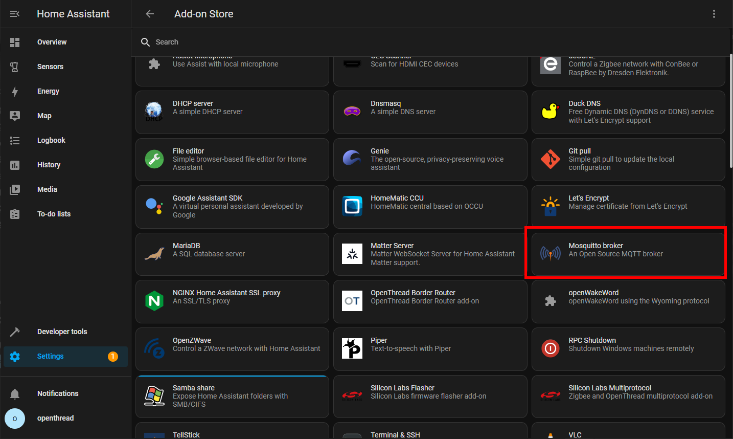

    Install the MQTT AddOn
    To see the Thread Sensor Tag as a device in Home Assistant we also need to enable the MQTT Broker functionality.
    1. Go to "Settings -> Add-Ons" and press "ADD-ON STORE"
    2. Search for Mosquitto MQTT Broker and install it
    3. In the Info Tab Start the AddOn

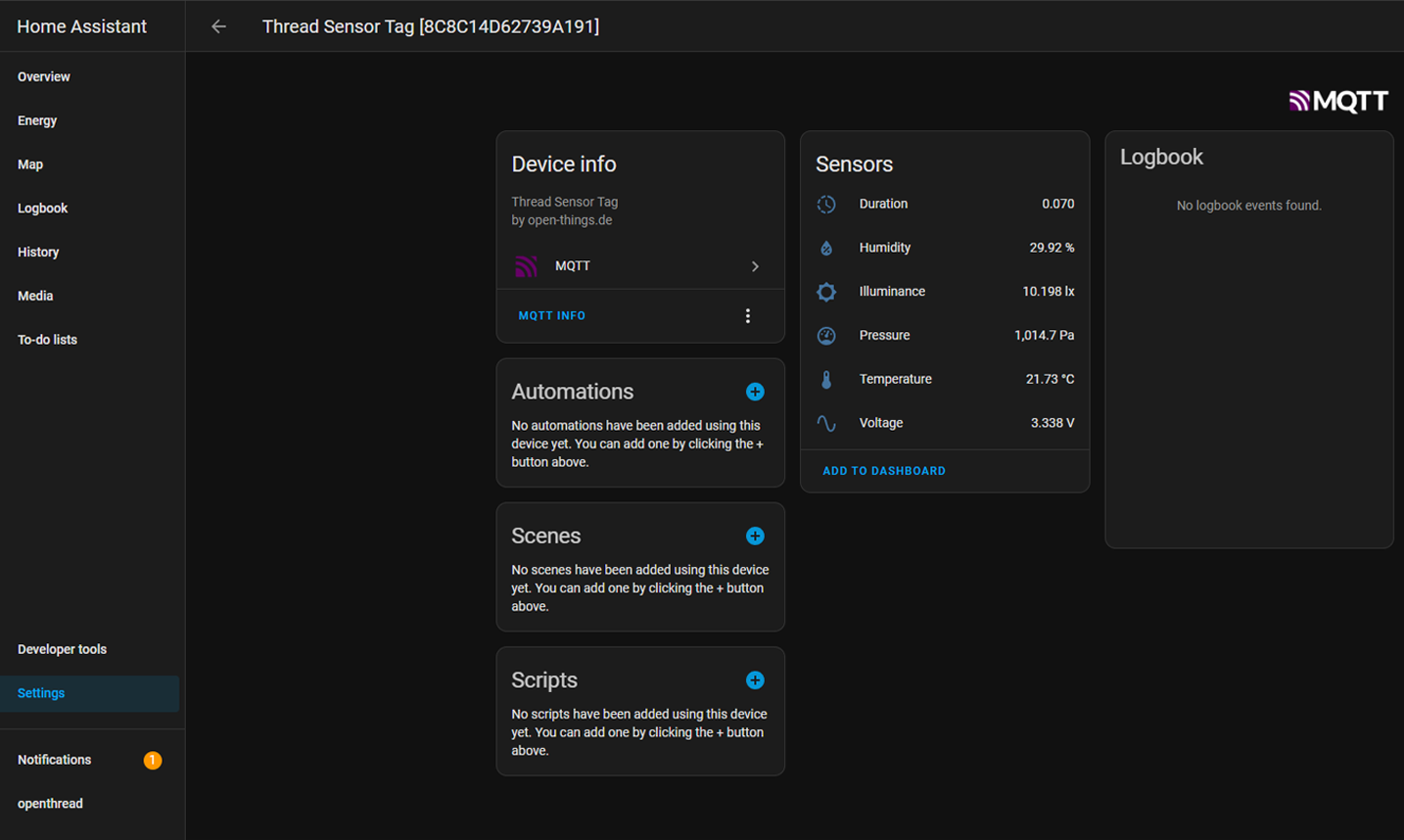

    Once the Device is successfully commissioned into the Thread Network it will start sending out UDP pakets. The AddOn will read the UDP Pakets and translate them into Devices in Home Assistant. You can find the Thread Sensor Tag now as a Device in your Home Assistant.
    Go to Settings -> Devices & Services and click on Devices in the Top Tab menu. In the List of devices you should see a Thread Sensor Tag. It might take a few minutes to first see it. You can always check in the Open Thread Border Router WebGUI under Topology if there is a client connected to the network.
