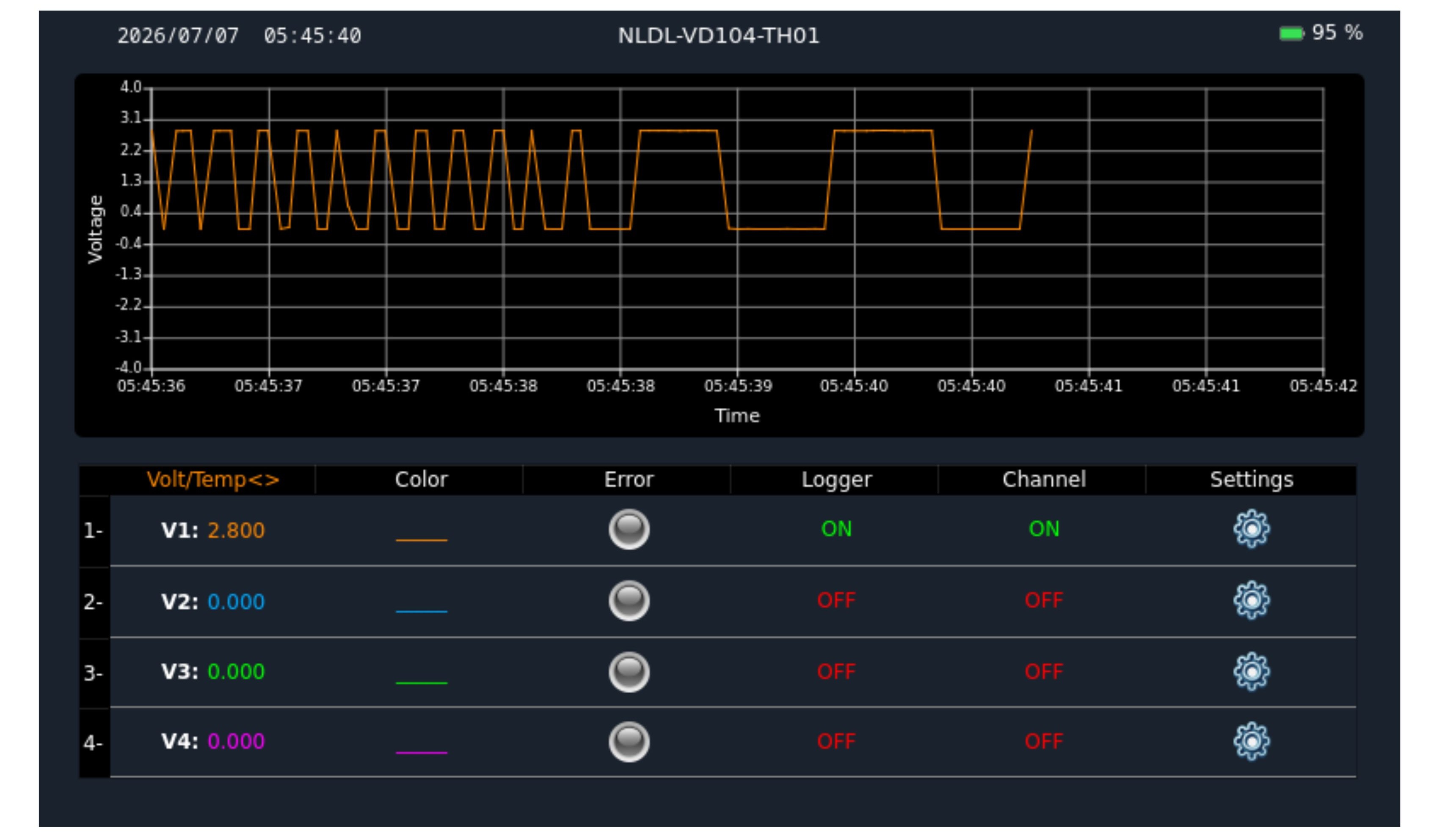

    Main Operating Screen
    After the device is powered on, the main operating screen will appear after a short startup period.
    The display is touch-enabled, allowing users to operate the device directly using their fingers. Alternatively, if a mouse is connected, all on-screen elements can also be selected and controlled using the mouse.
    1. Voltage –Time Chart
    The voltage–time chart on the main operating screen provides a real-time graphical representation of the measured voltage signals. The horizontal axis represents time, while the vertical axis displays the voltage level for each active channel.
    Each differential voltage channel is plotted simultaneously using a distinct color, allowing clear visualization and comparison of signal behavior over time. This chart enables users to quickly monitor trends, detect fluctuations, and identify abnormal conditions or transient events during operation.
    The chart is continuously updated based on the selected logging and sampling settings, providing immediate visual feedback of system performance and measurement stability.
    2. Battery Status Indicator
    The battery status indicator shows the current battery charge level. When the power adapter is connected, a yellow indicator appears on the battery display.
    3. Date & Time Display
    This display shows the current system date and time, which are used for time-stamping logged data and recorded events.

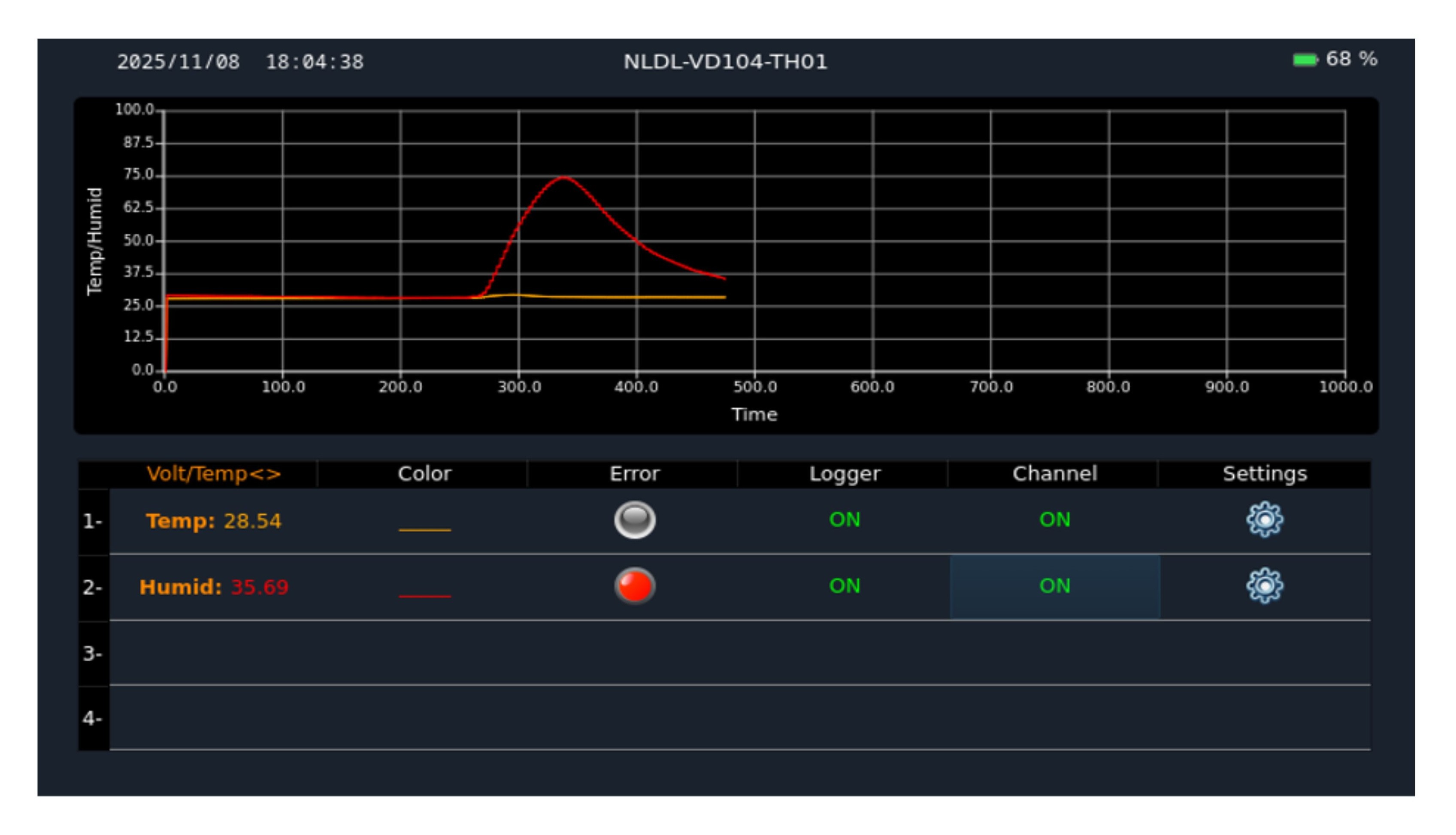

    4. Volt/Temp Button
    By default, the main screen shows voltage measurements. Pressing the Volt/Temp button toggles the display between the voltage view and the temperature & humidity view.
    Color Button
    The Color column shows the current chart color for each channel.
    Selecting a row opens the color selection screen, where a new color can be assigned to the channel.
    Error Indicators
    The ERROR column shows the error status for each channel. When an error occurs, the indicator activates and can be cleared by selecting it. Errors remain stored in memory until manually cleared, even after power-off.
    Logger Buttons
    This control allows the user to turn data logging on or off for each individual channel.
    Channel Buttons
    This control allows the user to enable or disable the chart display for each individual channel.

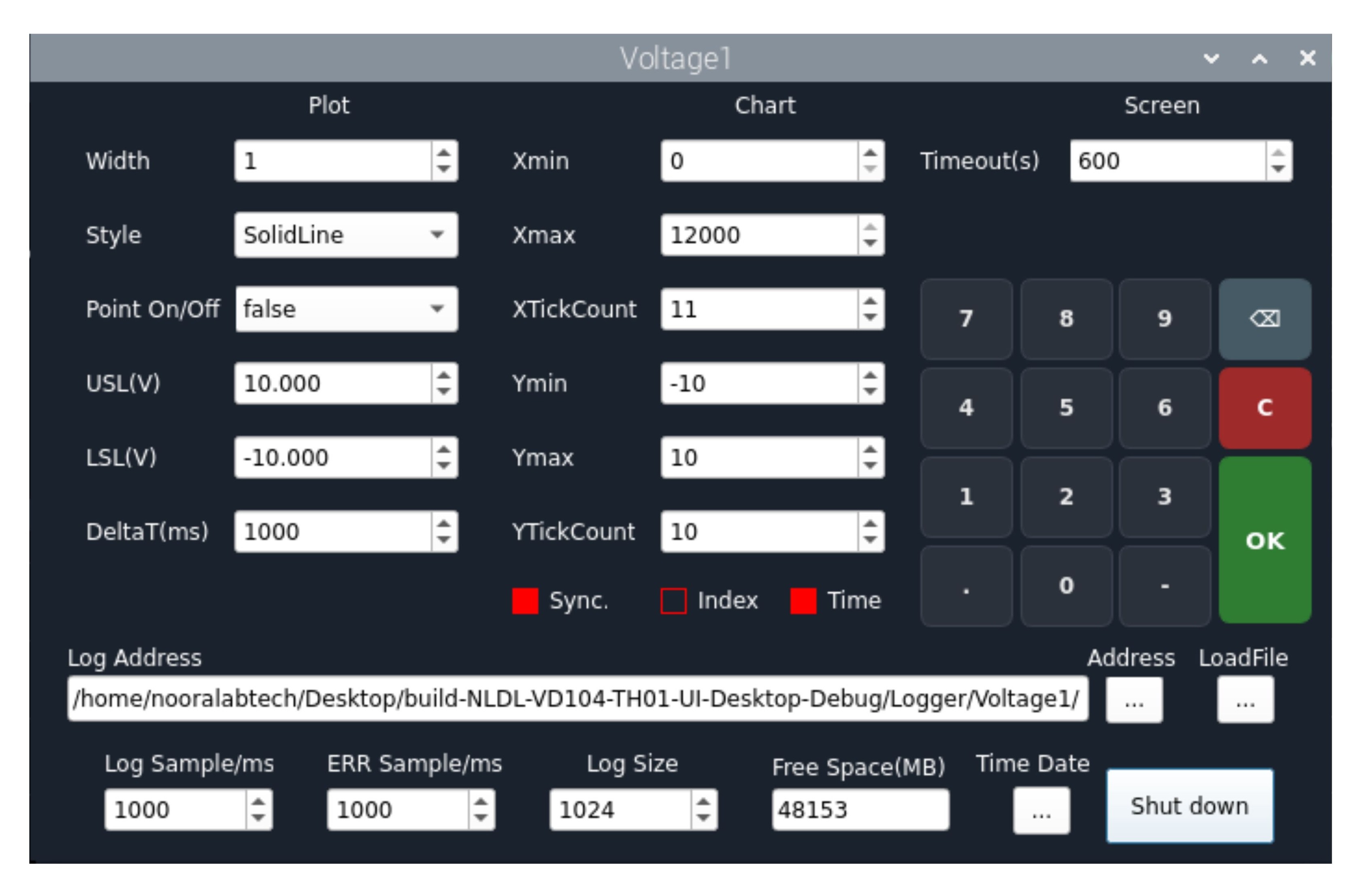

    Setting Buttons
    Clicking the buttons in this column allows access to the configuration settings for each individual channel.
    When the channel settings button is selected, the window shown below will open, allowing each channel to be configured individually and separately from the others.
    Plot
    This section allows you to adjust the chart display characteristics for each individual channel.
    Width
    Used to adjust the line thickness of the plotted chart.
    Style
    Used to select the display style of the plotted line on the chart.
    NoPen: Enables point-only display mode. After selecting NoPen, set Point On/Off to True to make the points visible.
    SolidLine: Displays the plotted line in a continuous solid style. (—)
    DashLine: Displays the plotted line in a dashed style. (---)
    DotLine: Displays the plotted line in a dotted style. (...)
    DashDotLine: Displays the plotted line in a dash-dot pattern. (-.-.-)
    DashDotDotLine: Displays the plotted line in a dash-dot-dot pattern. (-..-)
    Point On/Off
    When this option is set to True, the intersection point of each X and Y data sample will be displayed as dots on the chart. Set to False to hide the points.
    USL(V) / (C)
    Enter the upper threshold value for the error-detection system. The value is specified in volts (V) for voltage channels and in degrees Celsius (°C) for temperature measurements.
    LSL(V) / (C)
    Enter the lower threshold value for the error-detection system. The value is specified in volts (V) for voltage channels and in degrees Celsius (°C) for temperature measurements.
    DeltaT(ms)
    Specifies the sampling interval (time per data point) on the chart in milliseconds.
    Chart
    Here you can configure the...

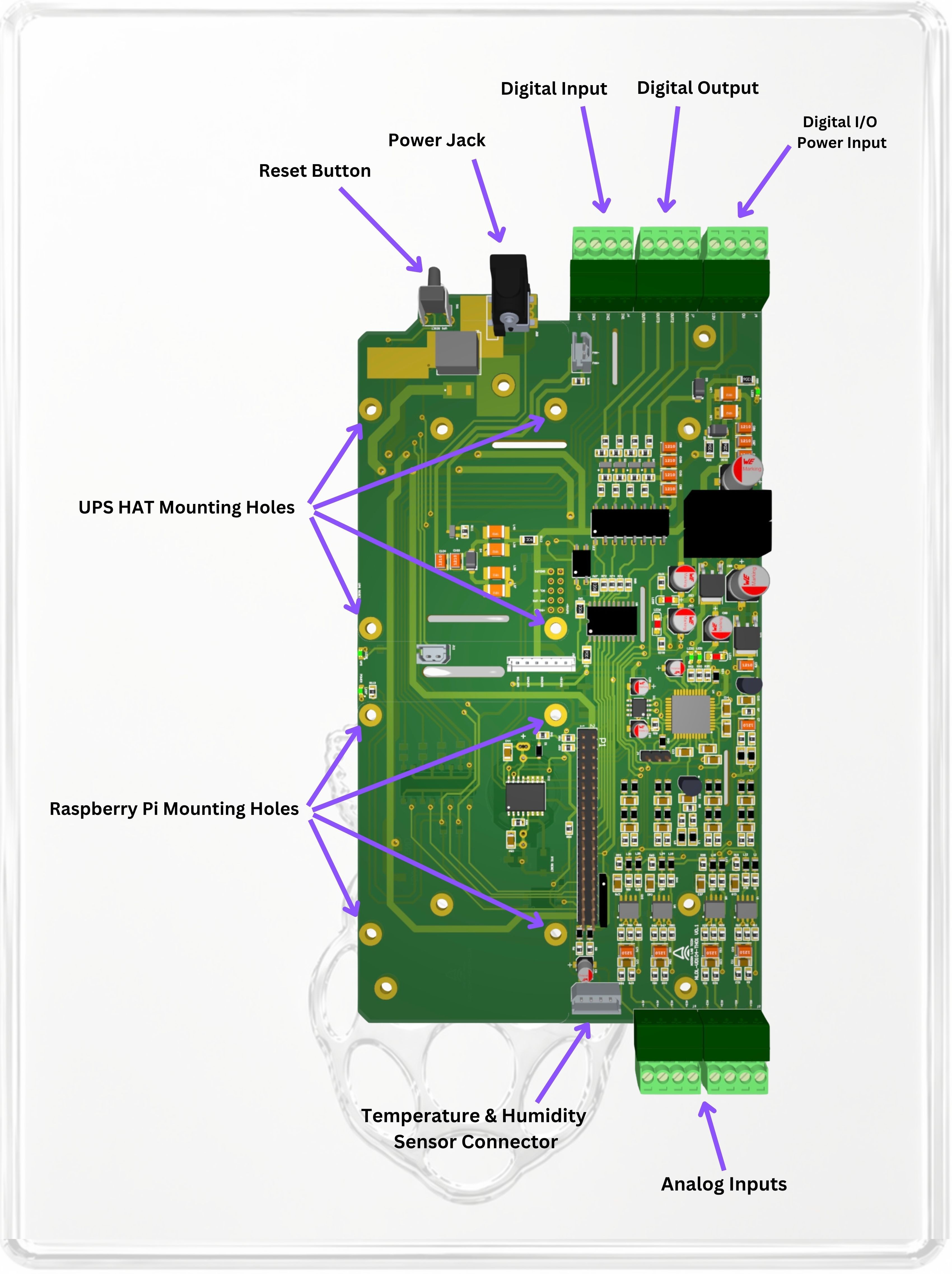

    PCB Module (PCB-VD104-TH01)
    Designed for Raspberry Pi users, developers, and system integrators who want to build the logger into their own enclosure, test fixture, or embedded system.
    >span class="a_GcMg font-feature-liga-off font-feature-clig-off font-feature-calt-off text-decoration-none text-strikethrough-none">For applications that require uninterrupted operation, users may add a compatible UPS HAT to their Raspberry Pi setup. The UPS HAT is not included with the PCB Module, but it can be integrated to support backup power, safe shutdown, and power-loss event recording.
    PCB Module Specifications
    Measurement & Logging
    Analog Inputs
    4 differential voltage input channels
    Voltage measurement range: ±0.006 V to ±12 V
    12-bit differential analog inputs
    Sampling rate: up to 30 kS/s per channel
    Adjustable logging interval: 50 ms to 1 min
    1 MΩ isolated input architecture to reduce channel-to-channel interference
    Digital I/O
    Digital inputs: 4
    Digital outputs: 4
    Logic levels: 12 V or 24 V
    Output current: 50 mA per channel
    Monitoring & Logging Features
    Integrated temperature & humidity sensor
    Independent data and error logging
    Alarm history for event tracking and diagnostics

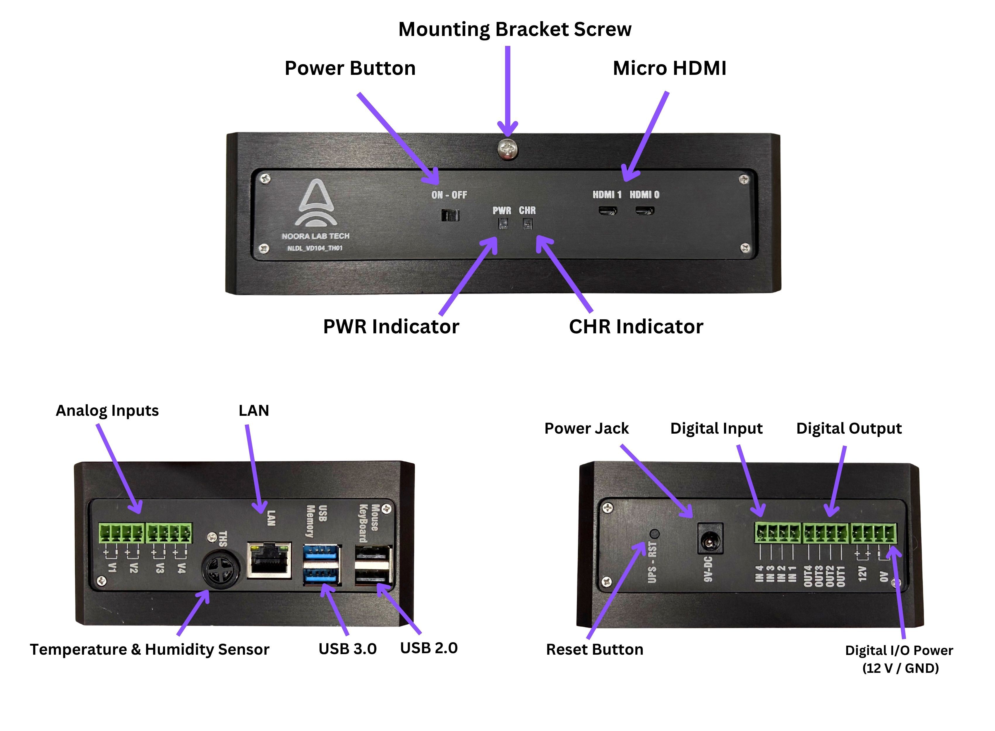

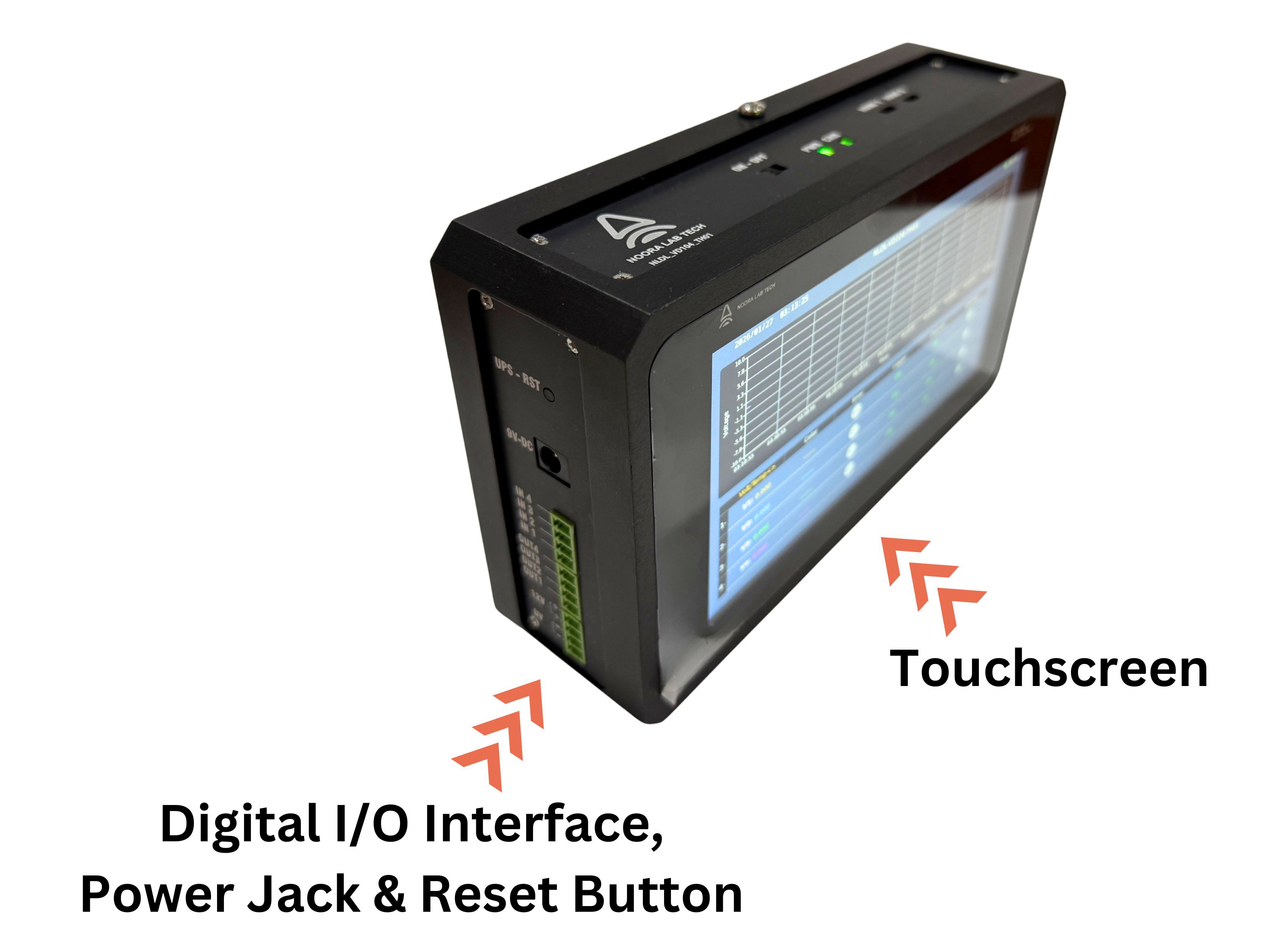

    Complete Enclosed Logger (NLDL-VD104-TH01)
    A ready-to-use instrument including the logger PCB, Raspberry Pi, 7-inch touchscreen display, UPS HAT, and durable metal enclosure. The built-in UPS HAT supports two 3,500 mAh 18650 lithium batteries for backup power. Batteries are not included to simplify shipping and avoid lithium battery transport restrictions, allowing users to source and install compatible cells locally.
    Complete Enclosed Logger Specifications
    Analog Inputs
    Digital I/O
    Digital inputs: 4
    Digital outputs: 4

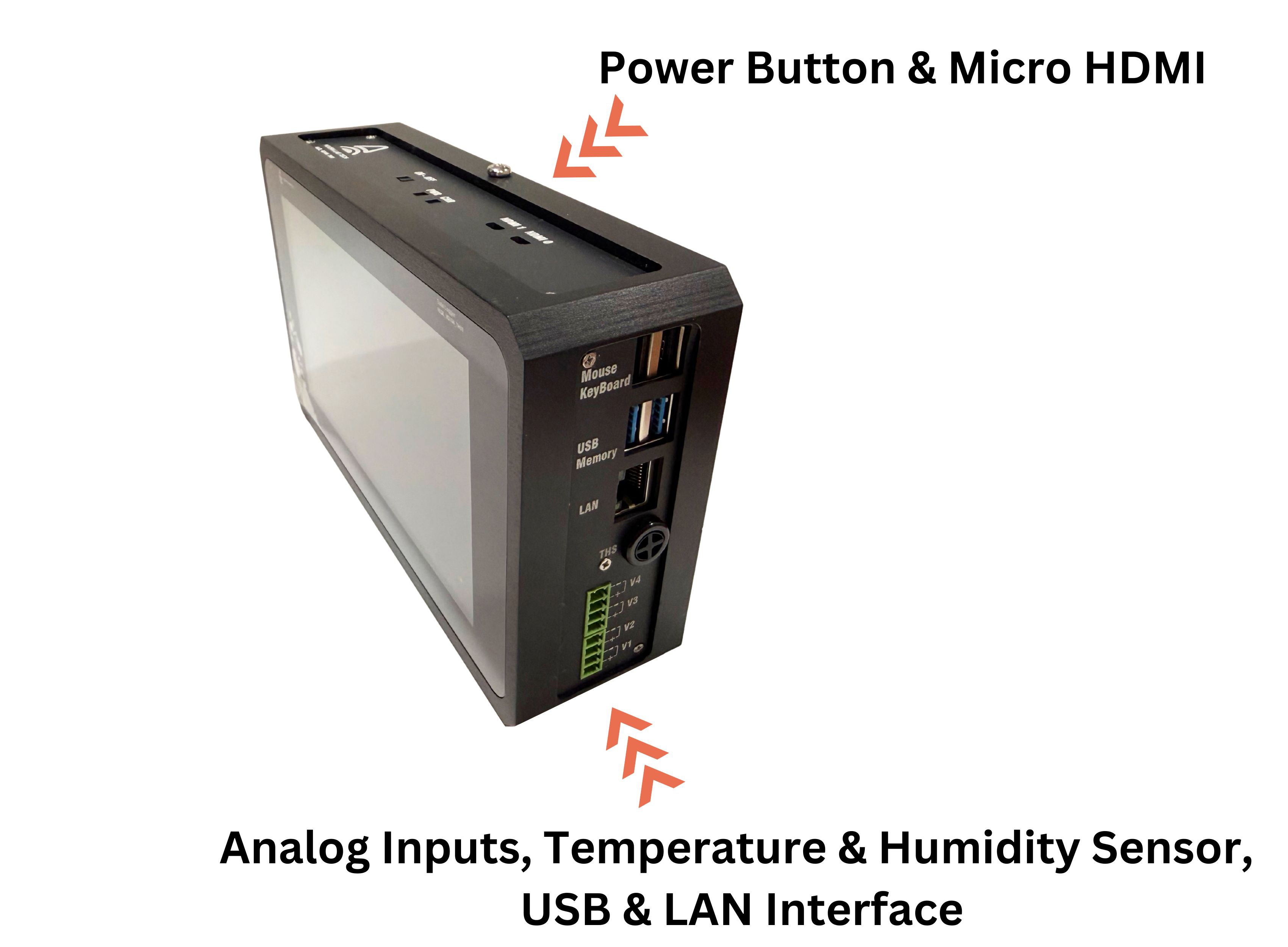

    Connectivity & Interfaces
    • LAN and Wi-Fi connectivity
    • VNC remote screen access
    • 2 × USB 2.0 ports
    • 2 × USB 3.0 ports
    • Dual Micro HDMI outputs
    Temperature & Humidity
    • Temperature accuracy: ±0.54 °F / ±0.3 °C
    • Temperature measurement range: –40 °F to +257 °F / –40 °C to +125 °C
    • Humidity operating range: 0 to 100 %RH
    • Humidity accuracy: ±3 %RH
    For applications requiring higher temperature measurement accuracy, the NLDL-VD104-TH01E model will be available as an option after the campaign ends. This version includes an external temperature probe mounted away from the device housing to minimize the influence of internal heat.
    Storage & Data Security
    • Internal storage options: 64 GB, 128 GB, 256 GB
    • External storage support: USB flash drives and external SSDs up to 2 TB
    Automatic storage failover: uninterrupted logging during external storage removal, with automatic switching to internal memory if external storage is removed or unavailable

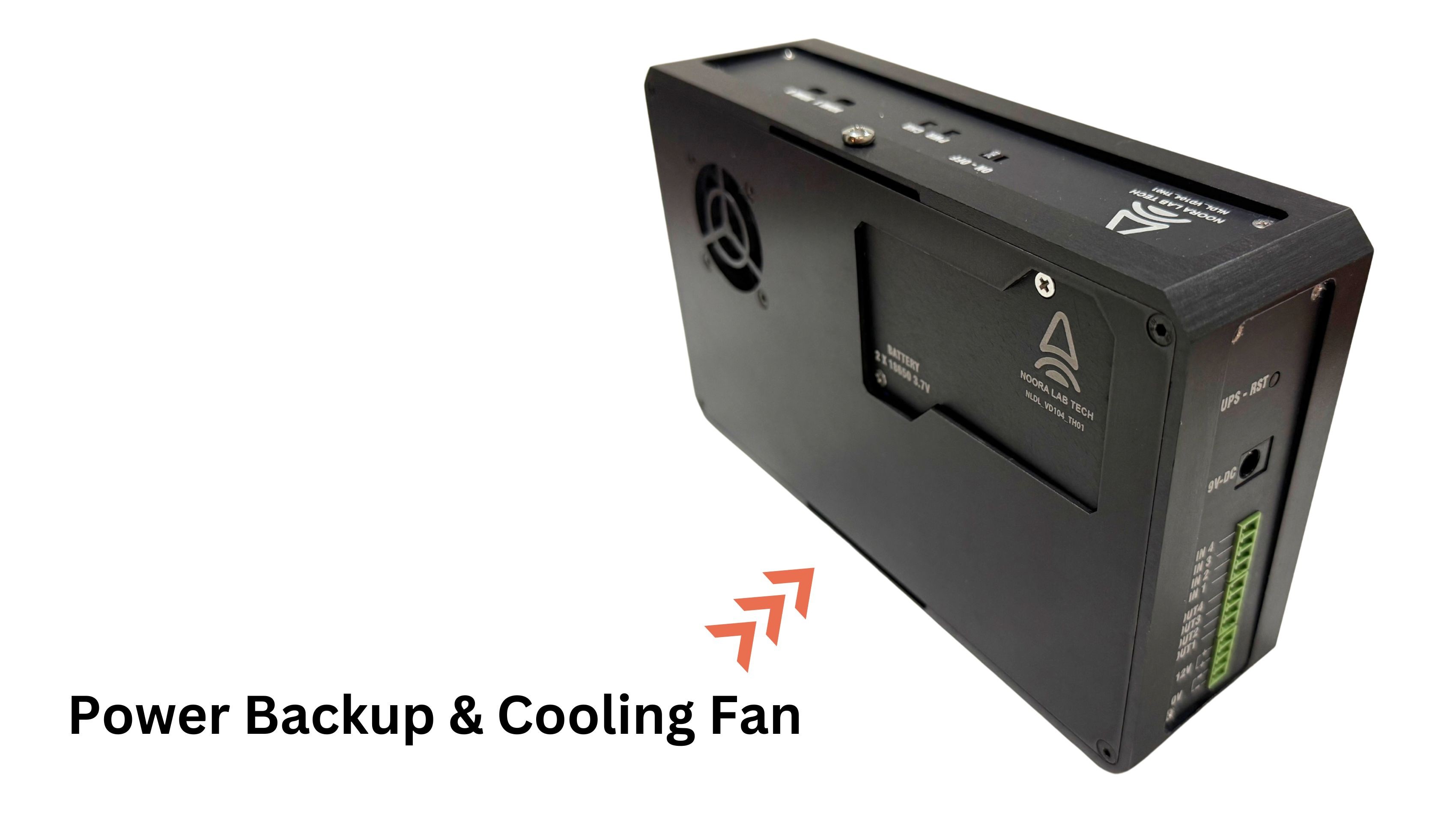

    Power System
    Integrated UPS HAT
    Supports two 3,500 mAh 18650 lithium batteries
    Up to 3 hours of continuous operation, depending on battery quality, system configuration, and connected peripherals
    Automatic transition between external power and battery operation
    Mechanical Specifications
    Durable aluminum enclosure
    Dimensions: 8.15 × 4.92 × 2.28 in / 207 × 125 × 58 mm
