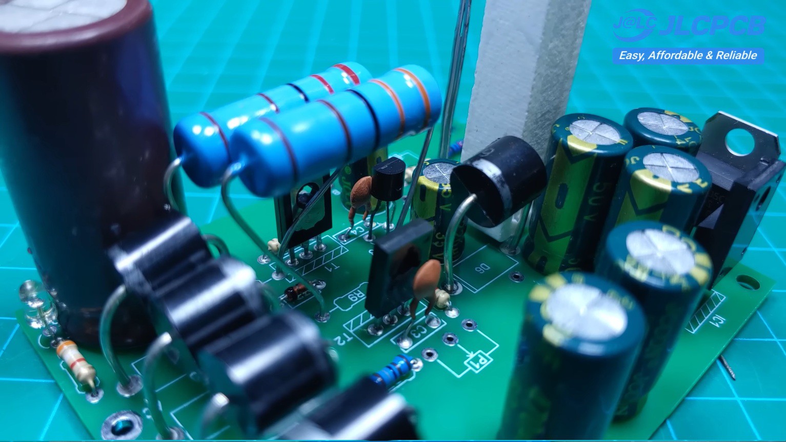

- AC input and bridge rectifier
- Large capacitor filter
- Zener reference network
- Transistor voltage regulator

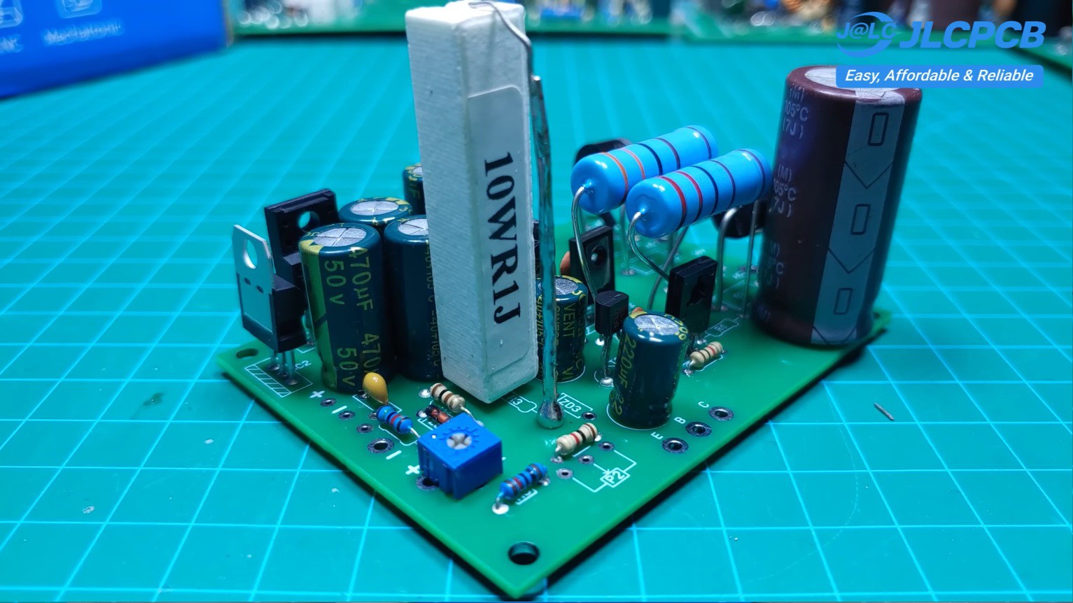

- Current sensing using a 0.1Ω / 10W shunt resistor
- Current limiting circuit
- Parallel power transistor output stage

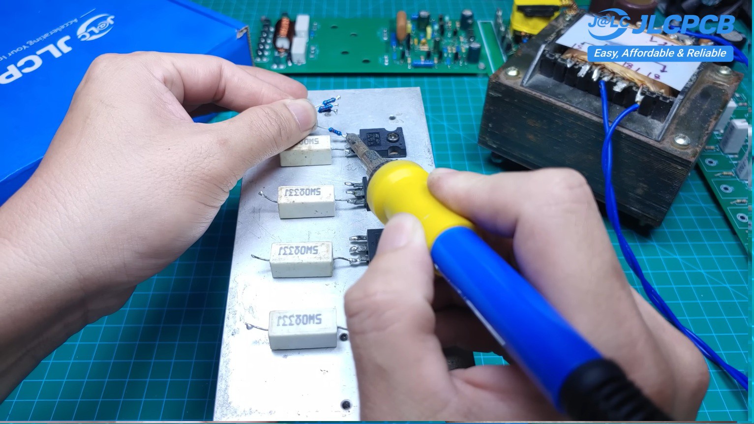

The control circuit uses common transistors such as BD137 and BD138, while the output stage uses multiple TIP142 transistors mounted on a large heatsink.
Emitter resistors ensure proper current sharing between the parallel output devices.

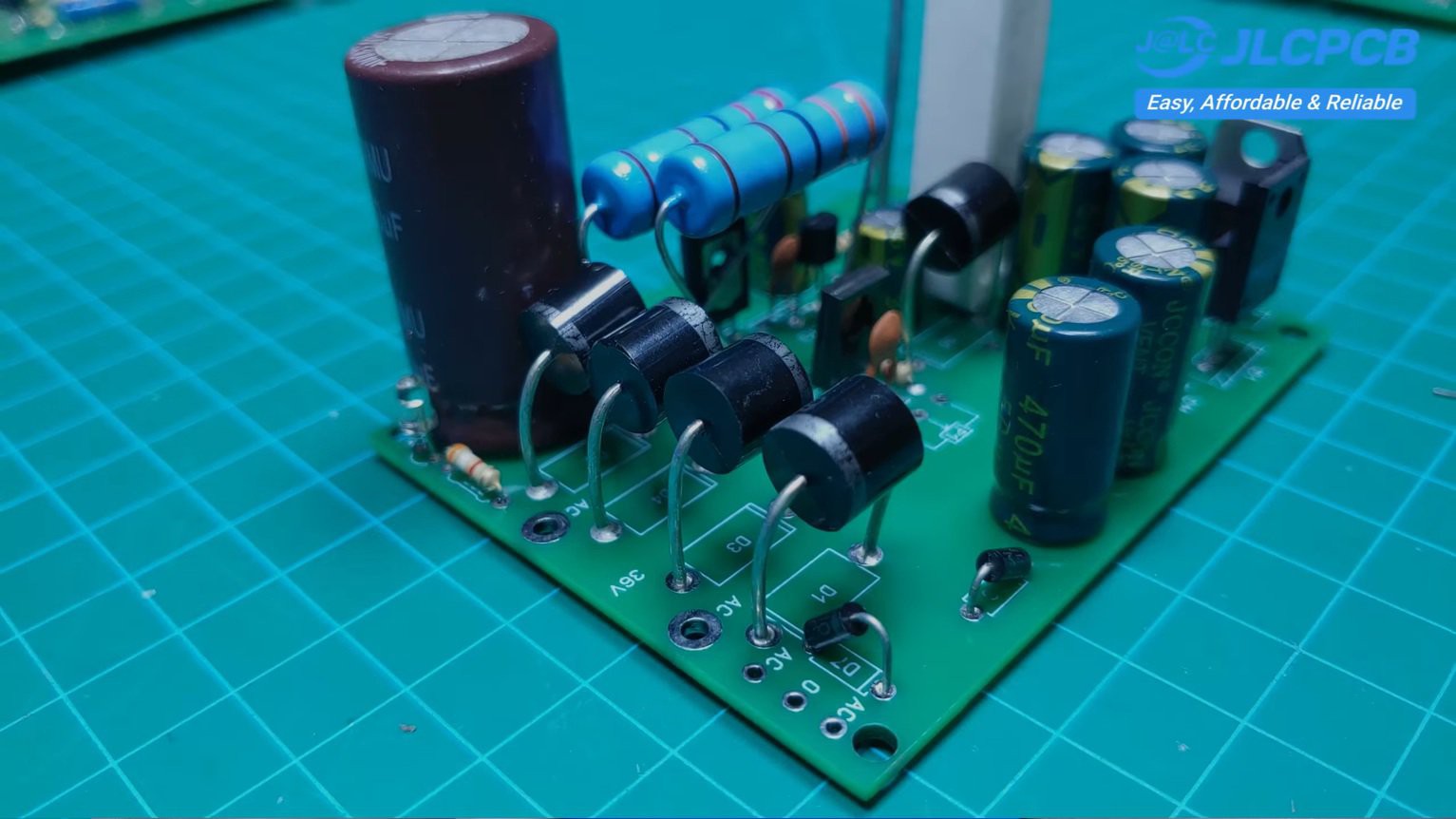

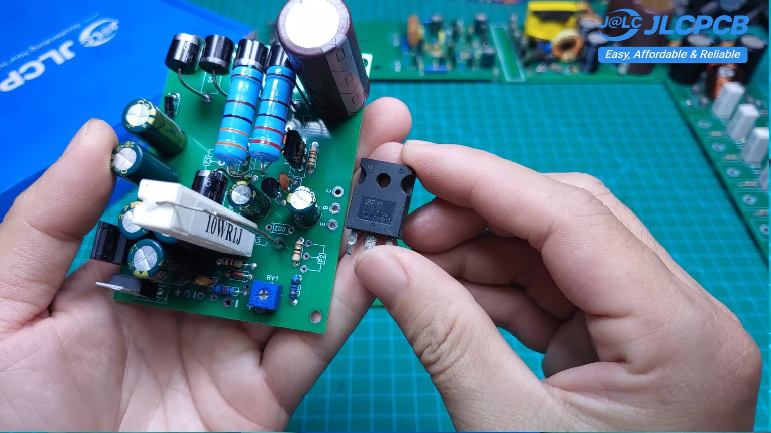

5PCB Design
The PCB was designed specifically for DIY assembly.
Special attention was given to:
- High-current copper routing
- Component spacing
- Easy soldering
- Simple troubleshooting
- Clean board layout
The boards were manufactured by JLCPCB, and the fabrication quality was excellent.

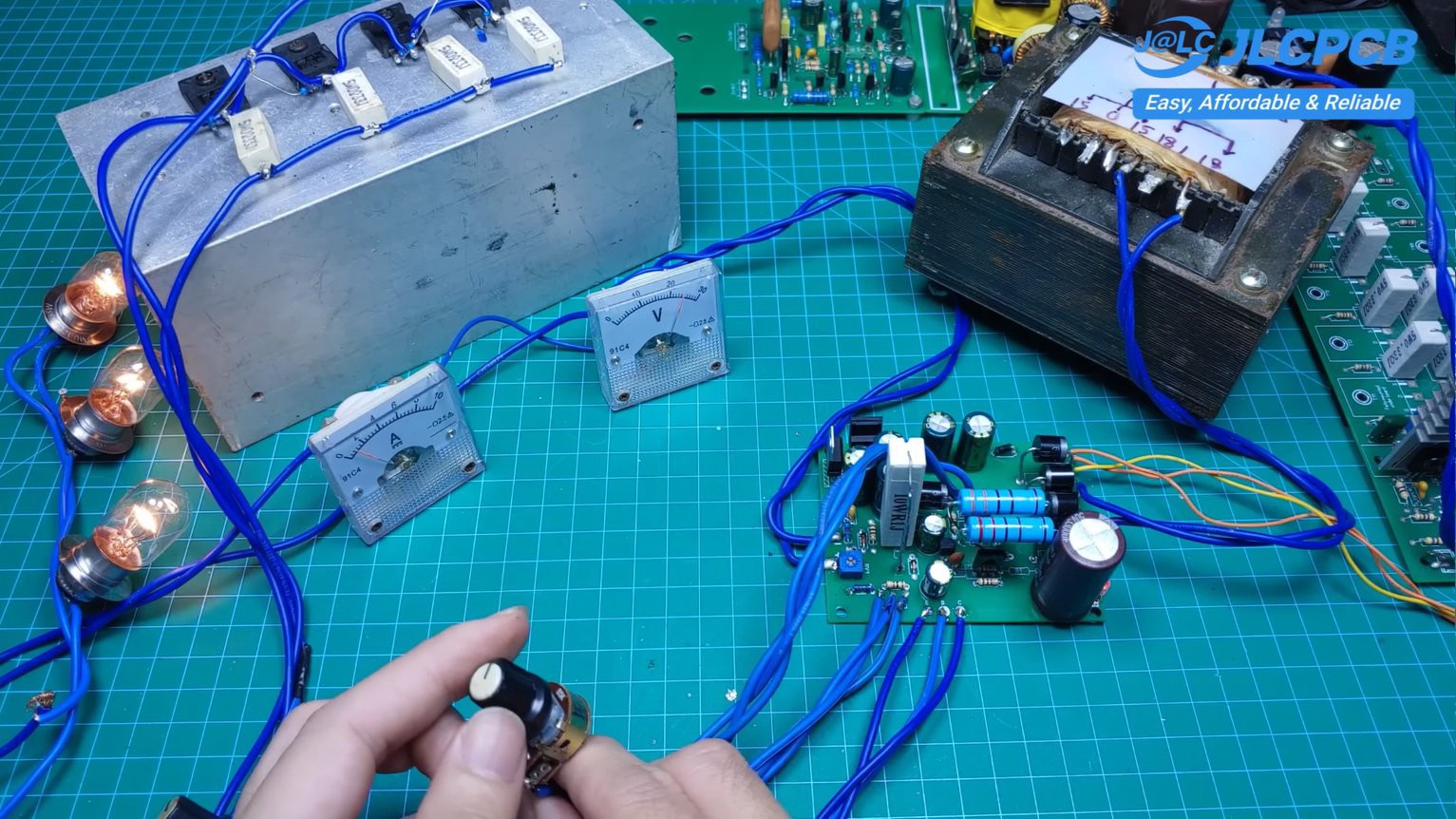

6Testing
The prototype was tested using:
- 30V AC transformer
- Approximately 40V DC after rectification
- Three 12V lamps connected in series as the load
- Digital voltmeter and ammeter
Testing confirmed smooth voltage adjustment and reliable current limiting across the full operating range.
