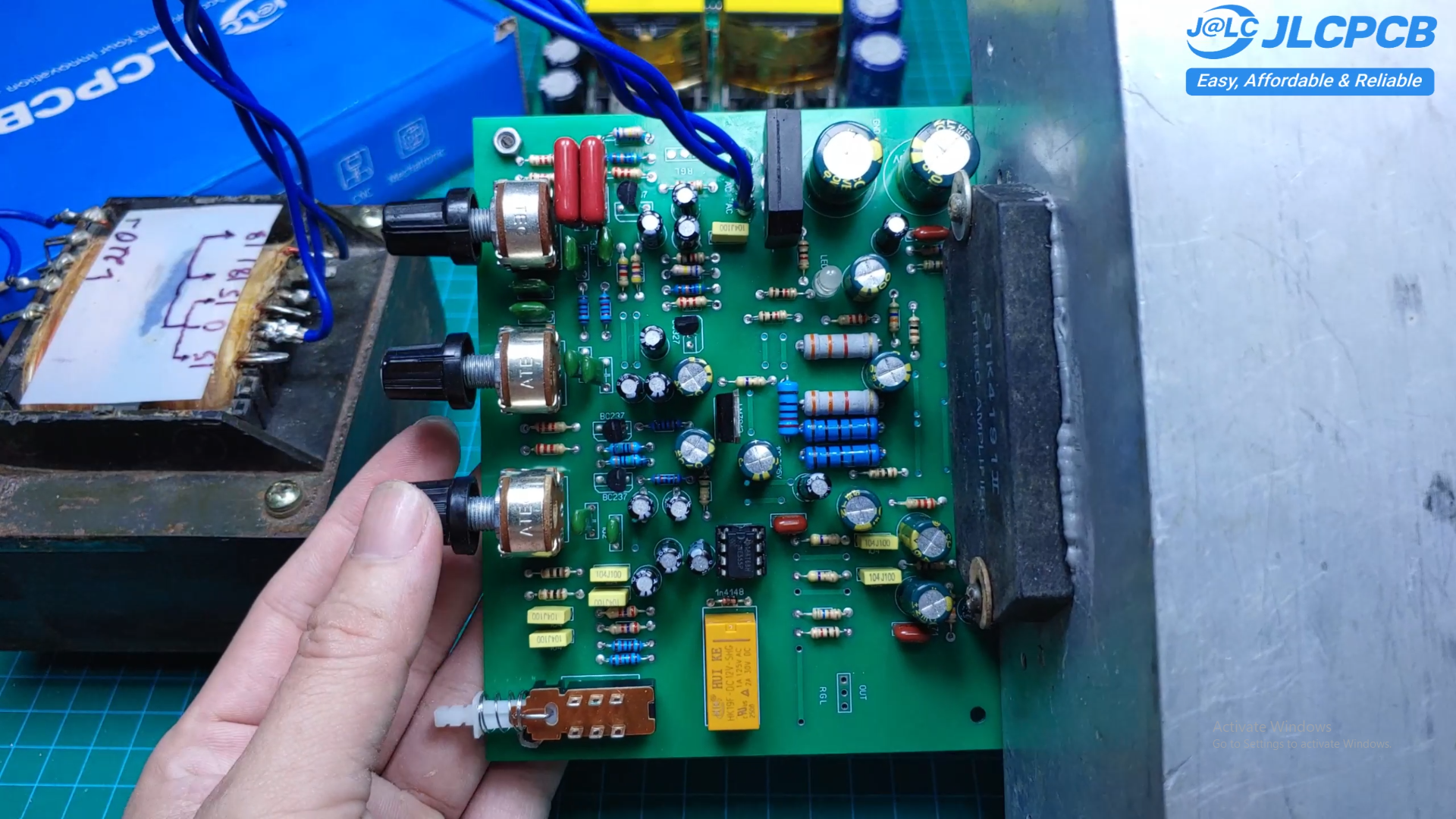

After several amplifier projects, I wanted to build a compact Hi-Fi stereo amplifier based on the well-known STK4191II power amplifier IC. My goal was not only to build a reliable amplifier but also to design a complete PCB board with an integrated tone control stage, power supply, and speaker protection relay.
The result is a clean and easy-to-build amplifier that delivers excellent sound quality while remaining simple enough for hobbyists to assemble.

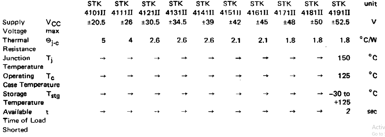

- STK4191II power amplifier
- Compatible with the STK41xx series

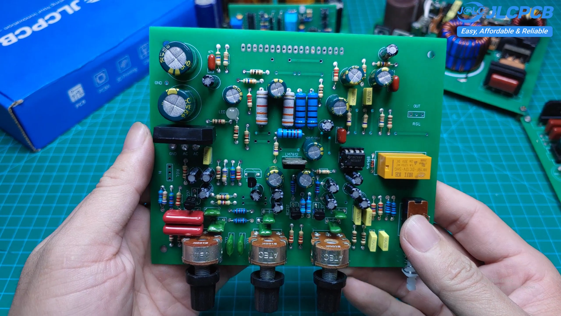

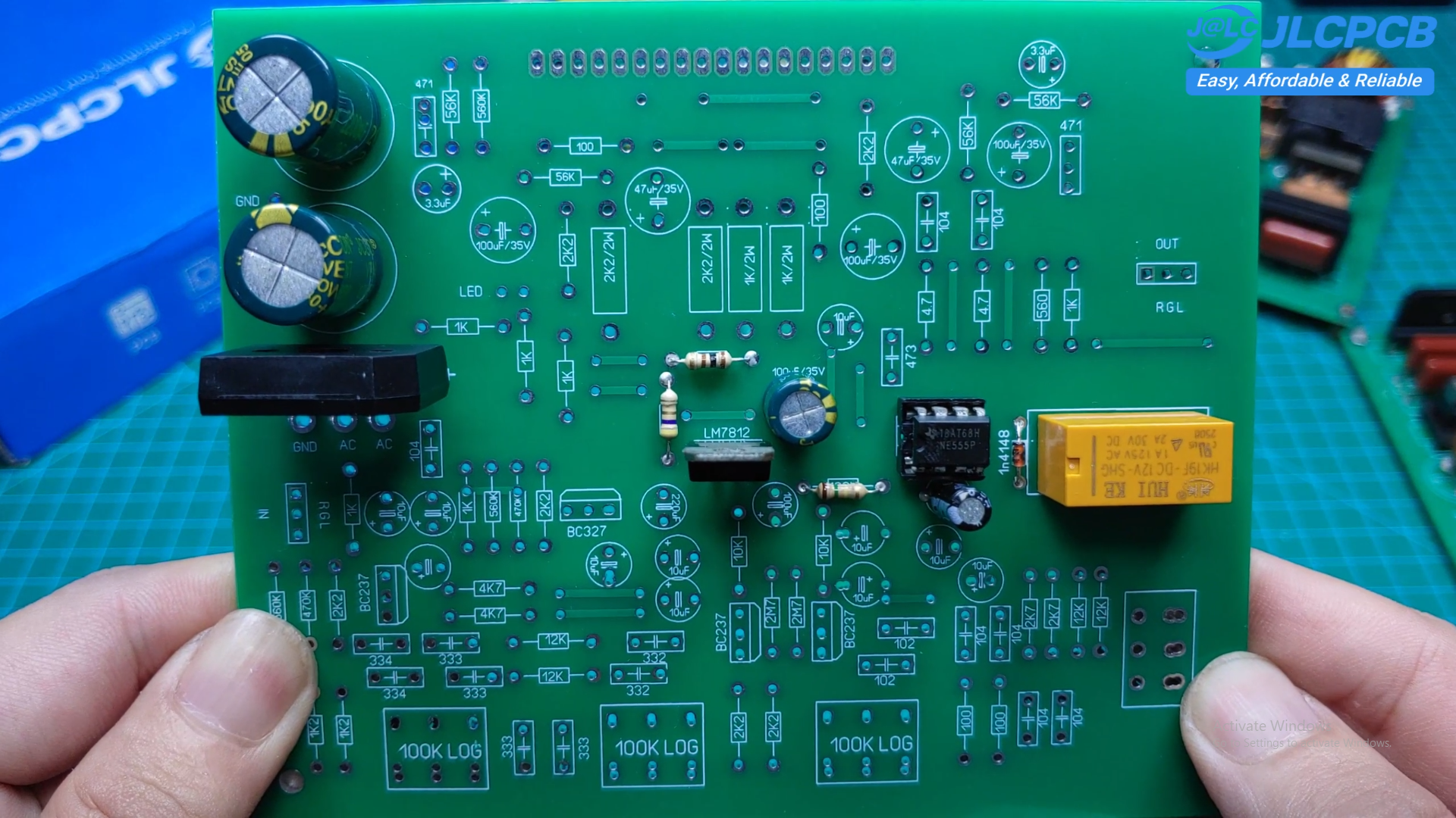

3PCB Board Design
The entire amplifier was designed on a single PCB board to simplify wiring and improve reliability.
The board includes:
- AC to DC rectifier
- Power supply filter
- 7812 voltage regulator
- Tone control circuit
- Relay delay circuit
- STK41xx amplifier section
After completing the design, I uploaded the Gerber files to JLCPCB.
The manufactured PCB boards arrived about one week later with excellent quality. The silkscreen is sharp, the solder mask is clean, and the drilled holes are accurately aligned, making assembly straightforward.

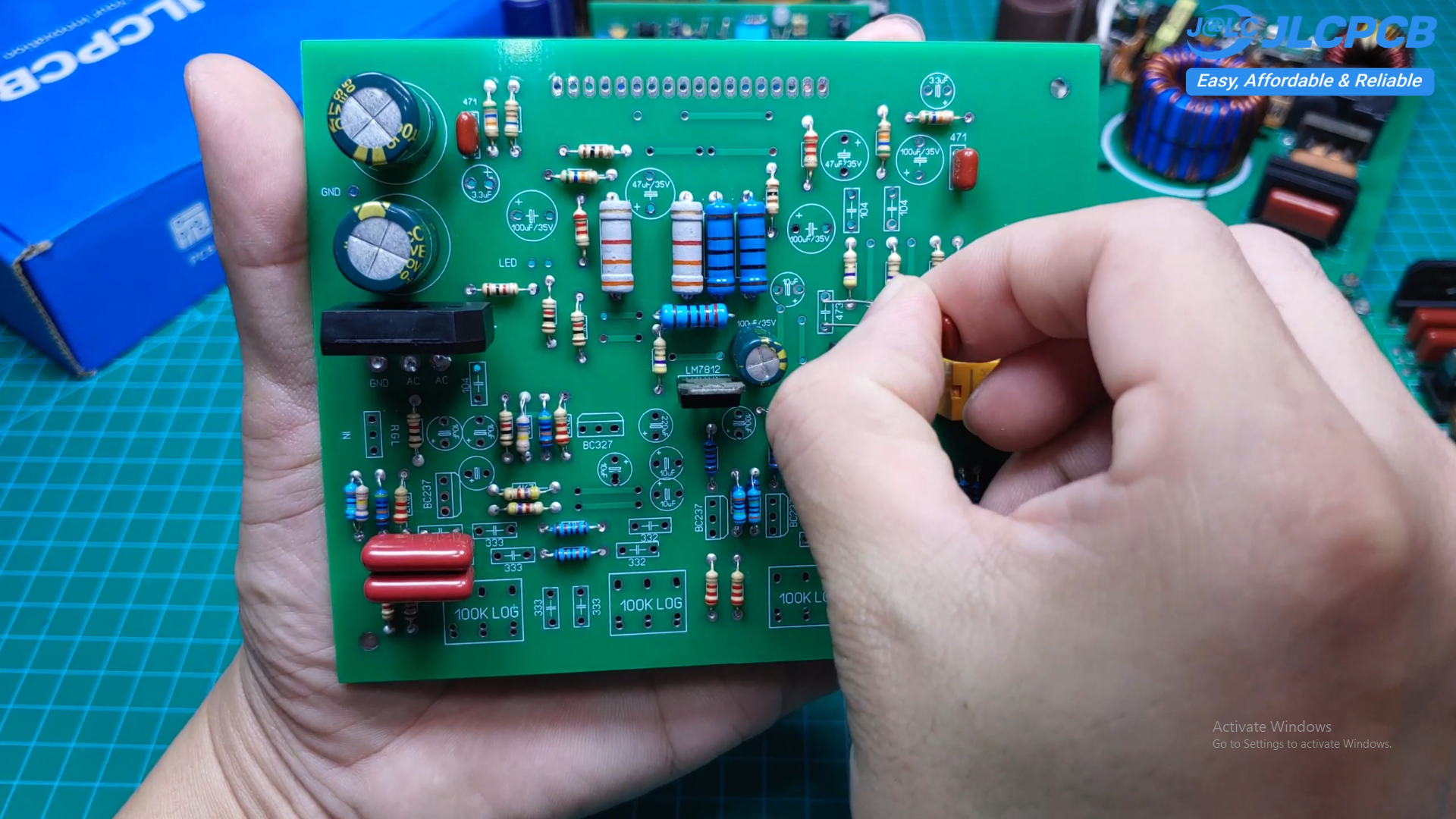

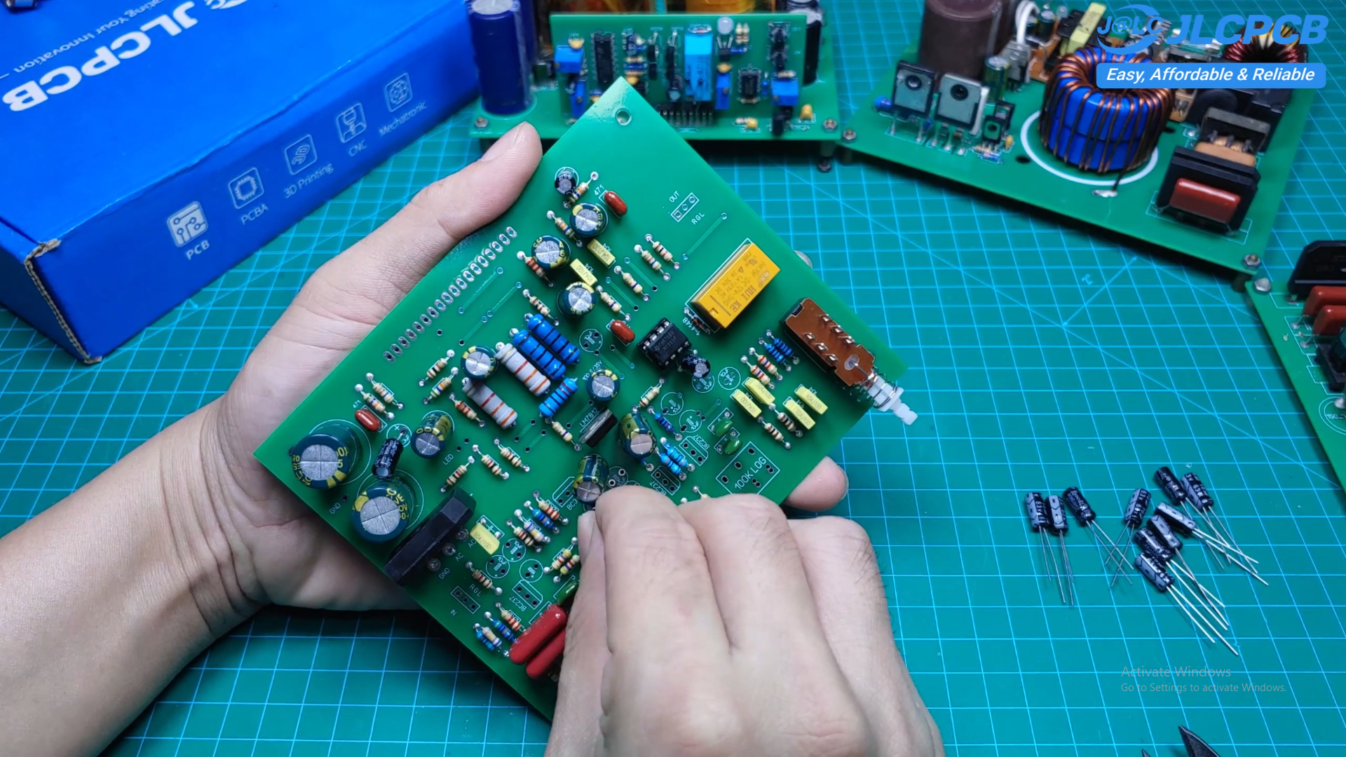

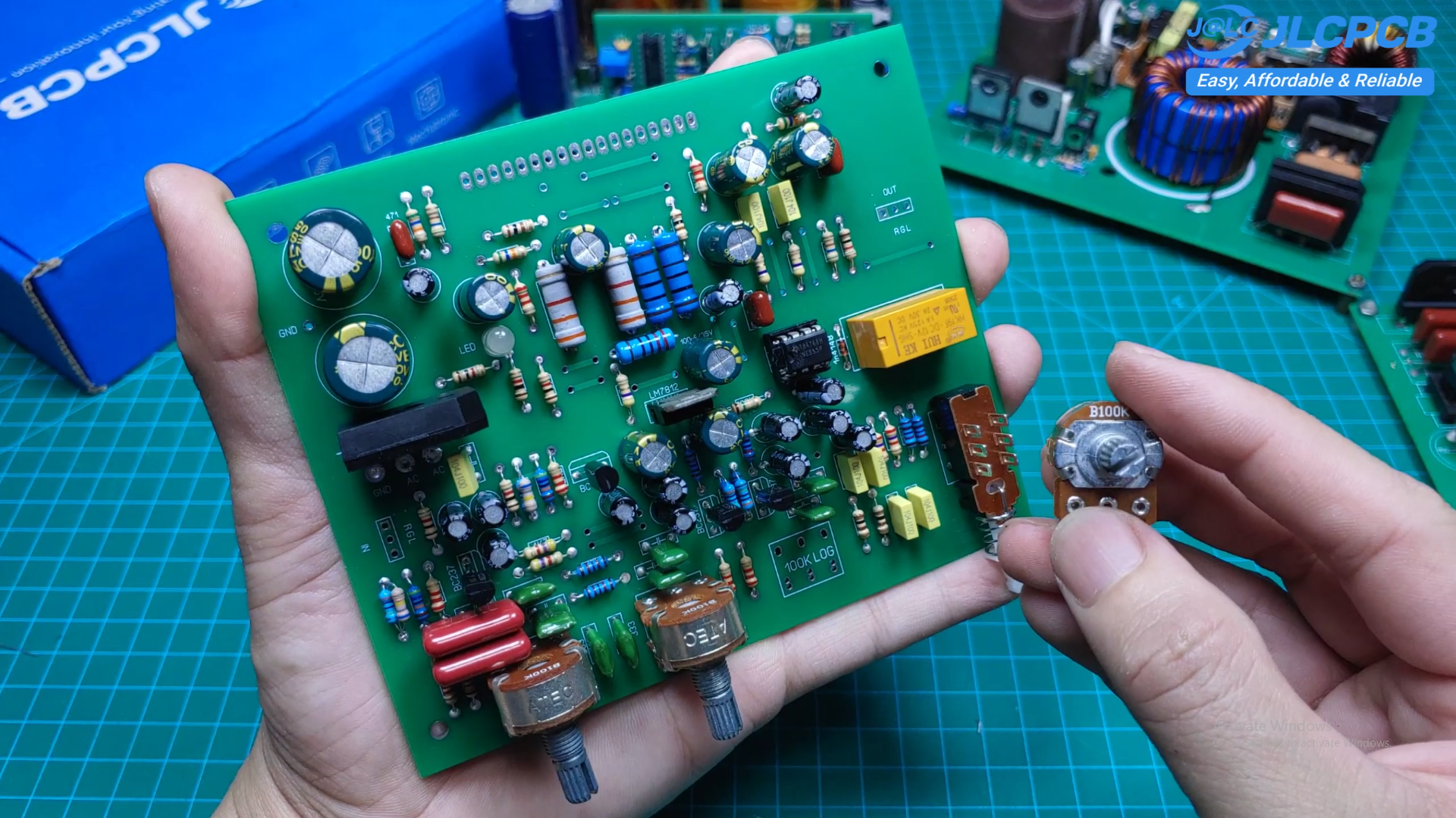

4Assembly
Assembly begins with the power supply section, followed by the tone control circuit and passive components.
Special attention should be paid to:
- Electrolytic capacitor polarity
- Correct capacitor values
- Correct resistor values
- Proper orientation of diodes and transistors
Three 100-kilohm potentiometers are used for Volume, Bass, and Treble adjustment.
Before installing the STK41xx IC, I strongly recommend powering the board and verifying every supply voltage.
Doing so can prevent accidental damage to the amplifier IC.

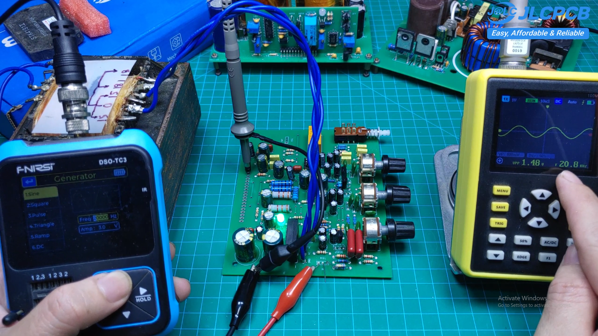

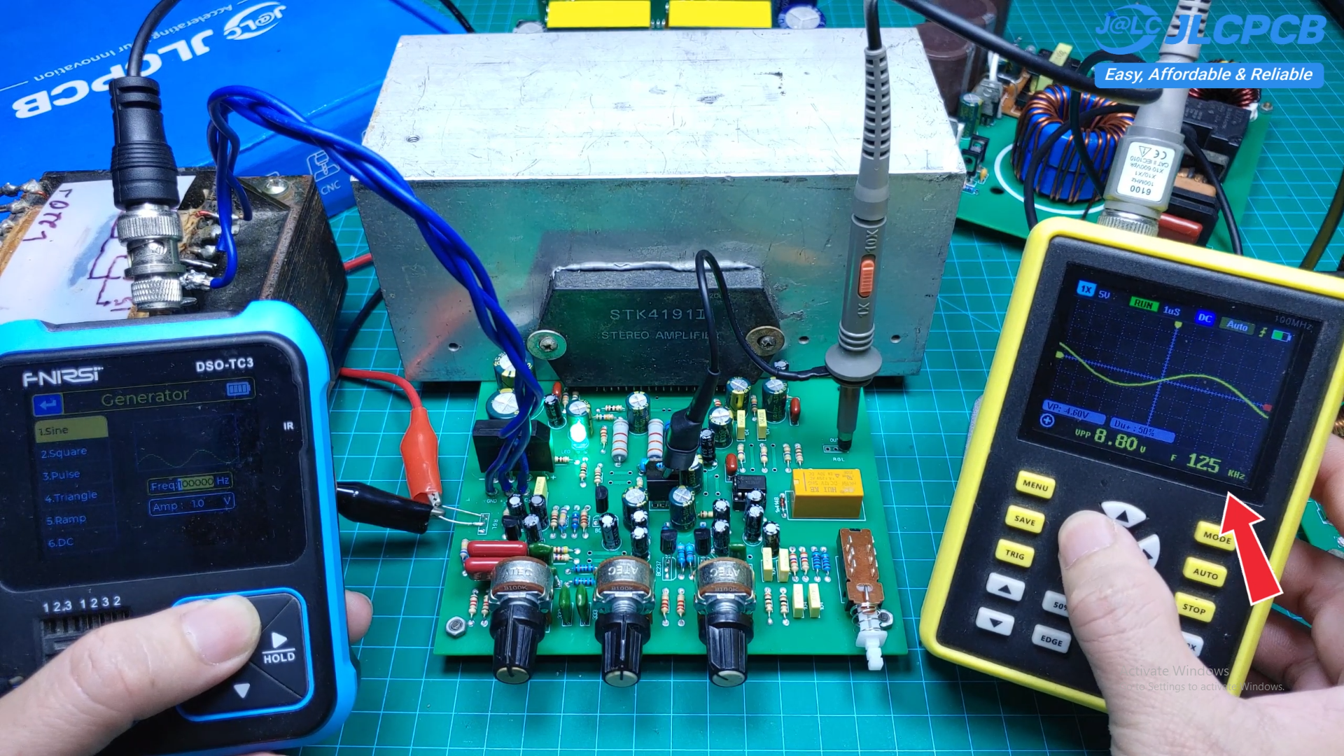

5Testing
Before inserting the amplifier IC, I tested the tone control circuit independently.
A sine-wave signal generator was connected to the input while an oscilloscope monitored the output.
The waveform remained stable as the frequency increased, demonstrating that the tone control stage has a wide bandwidth and introduces very little distortion.
After confirming that every supply voltage was correct, I installed the STK4191II together with a large heatsink.
The completed amplifier operated normally on a 24-volt power supply during testing.
The speaker protection relay activated a few seconds after power-up, eliminating the turn-on pop.
6Frequency Response
One of the most interesting parts of this project was observing the amplifier's frequency response.
Using a signal generator and an oscilloscope, I gradually increased the input frequency from low audio frequencies up to 100 kilohertz.
Even at 100 kilohertz, the output waveform remained clean with virtually no visible distortion, indicating that both the tone control stage and the amplifier are capable of maintaining excellent signal integrity across a very wide frequency range.
