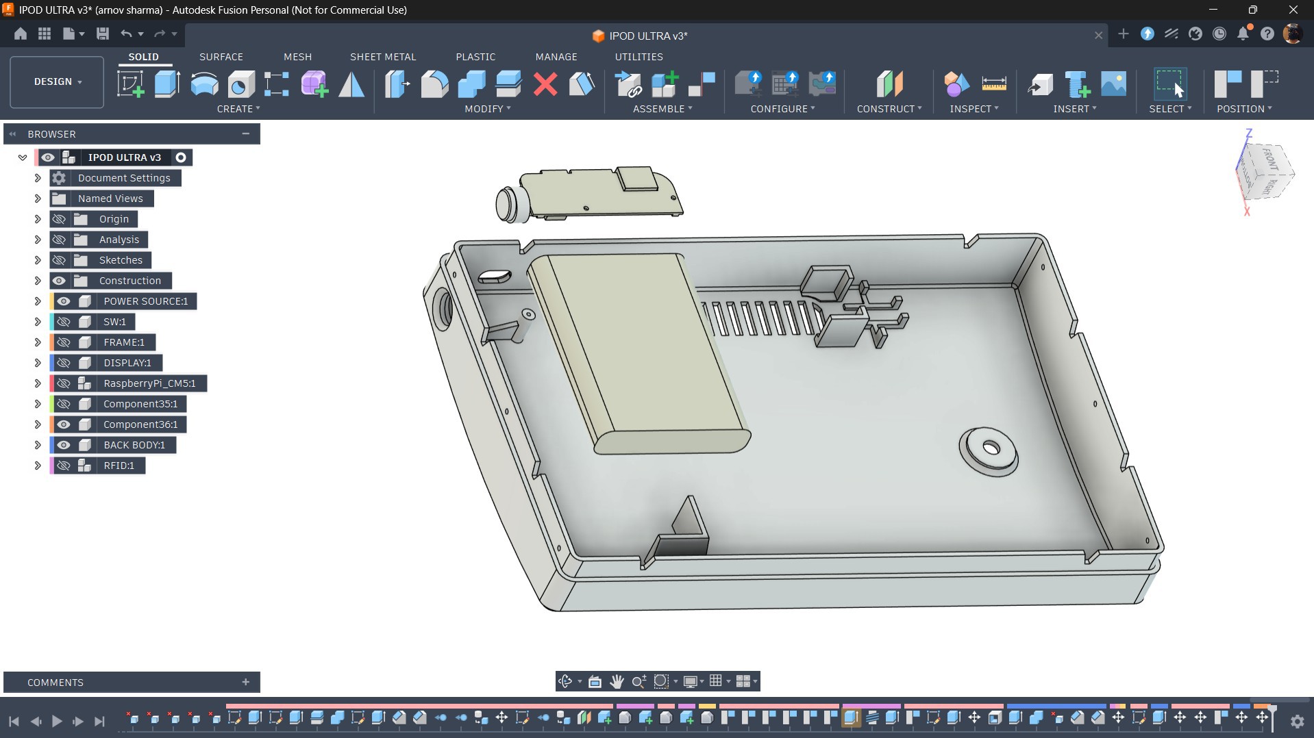

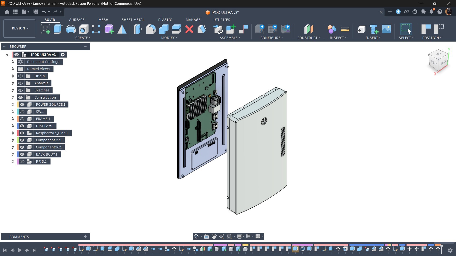

DESIGN
The main design of iBrick follows a simple, boxy form with a slightly curved back enclosure. The overall construction is divided into two primary parts: the front frame and the back enclosure, with the internal hardware, including the display, Raspberry Pi Compute Module 5, power bank, battery, and other electronics, remaining largely unchanged from the original Absolute Linux Tablet.
The main redesign was focused on the back enclosure. I intentionally kept it chunky and oversized, giving iBrick its distinctive brick-like appearance, which also inspired the name. The front frame uses a minimal-bezel design to maximize the display area while keeping the overall look clean.
Rather than trying to physically replicate every detail of the original iPod Nano, my goal was to keep the hardware design simple and recreate the recognizable iPod experience primarily through the software UI. Elements such as the classic navigation, click wheel, menus, and animations were therefore implemented digitally, allowing the oversized enclosure to remain simple while the software provides the nostalgic iPod character.
5

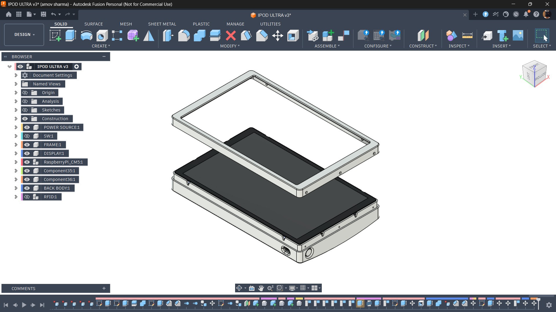

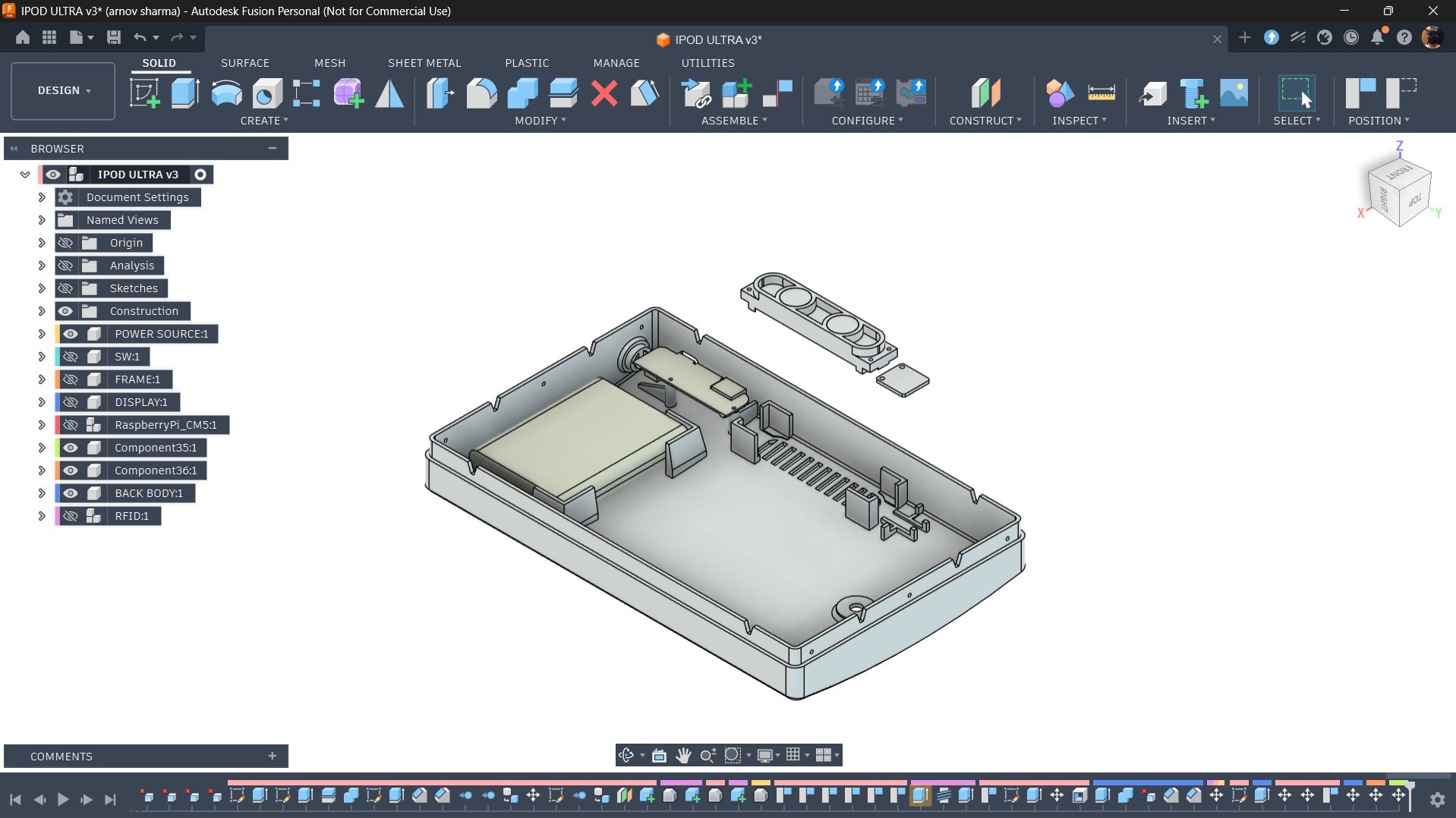

CONSTRUCTION
The enclosure mainly consists of two parts: the front frame, which holds the display and Raspberry Pi CM5 assembly in place, and the back enclosure, which houses the battery pack and power circuitry. Both parts are designed to fit together and are secured using M2 screws inserted through mounting holes positioned around the perimeter of the frame.
The back enclosure also includes dedicated mounting features for the speaker and MAX98357A I2S amplifier, allowing both components to be securely positioned inside the enclosure.
Similarly, the lithium-polymer battery has a designated area where it can be secured in place, while the power circuit sits on two dedicated mounting bosses and is fastened using M2 screws. This keeps the internal components organized and prevents them from moving around inside the enclosure.

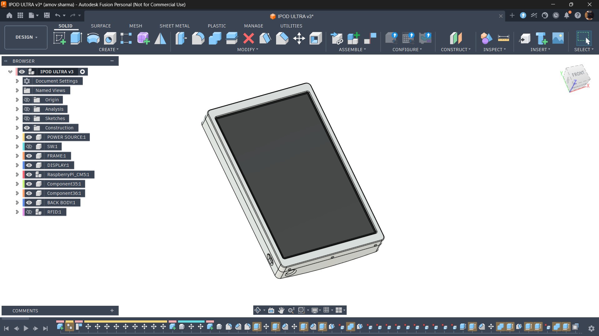

3D PRINTED PARTS
After finishing the model, we exported three parts: the back part, the frame, and the button actuator.
The frame part and button actuator were both printed in Black Hype PLA with a 0.2 mm layer height and 25% infill. The enclosure was printed in Grey Hype PLA with similar settings.

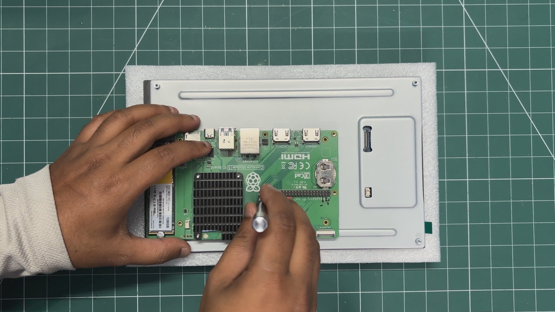

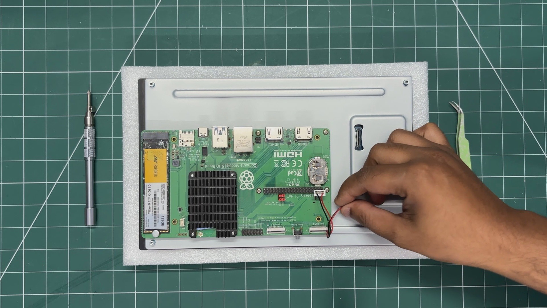

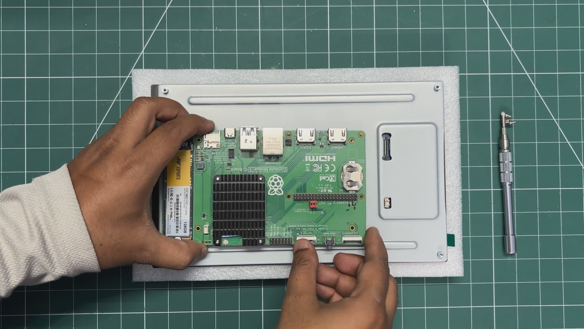

DISPLAY & CM5 ASSEMBLY
We begin the display and CM5 assembly process by positioning the expansion board over the back of the display.
We align the mounting holes of the display with the Raspberry Pi board and then use the provided four M2.5 bolts to secure both of them together.
Next, we connect the power wire harness. One side is connected to the JST connector on the display, while the other end goes to the Raspberry Pi's GPIO header. We connected 5V to 5V and GND to GND. Basically, the display will be powered directly from the GPIO header of the Raspberry Pi.

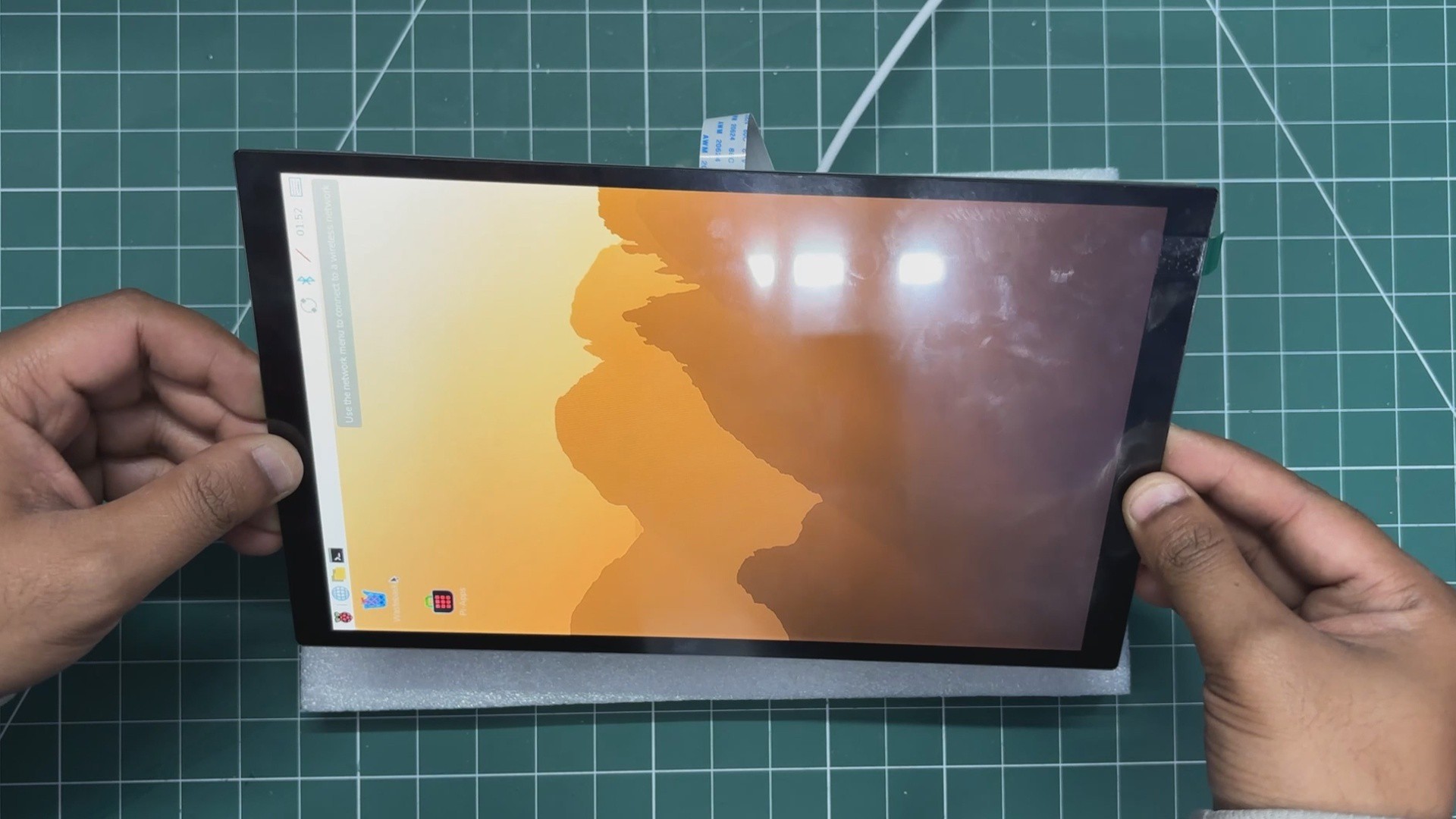

CONFIG FILE EDIT
We plugged in the power and were hoping this would be a plug-and-play job, but things are never that simple, and the display didn't work straight away.
We needed to connect an external monitor to our CM5, open a terminal, and then edit the config.txt file.
We added the following line at the bottom of the file.
On the wiki page for this display, to Waveshare's credit, they did include a custom pre-flashed Raspberry Pi OS Trixie image. If we use that image and flash our Raspberry Pi with it, the display boots up without requiring any manual edits to the configuration files.

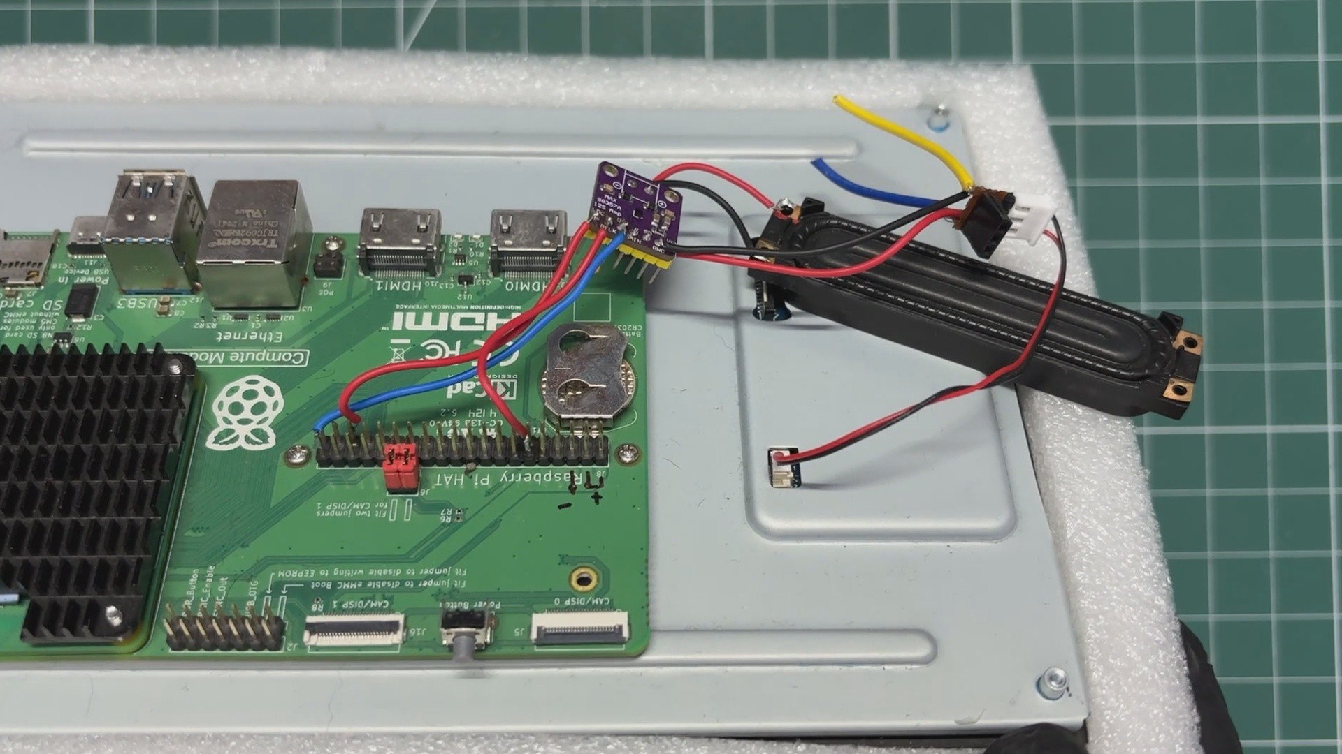

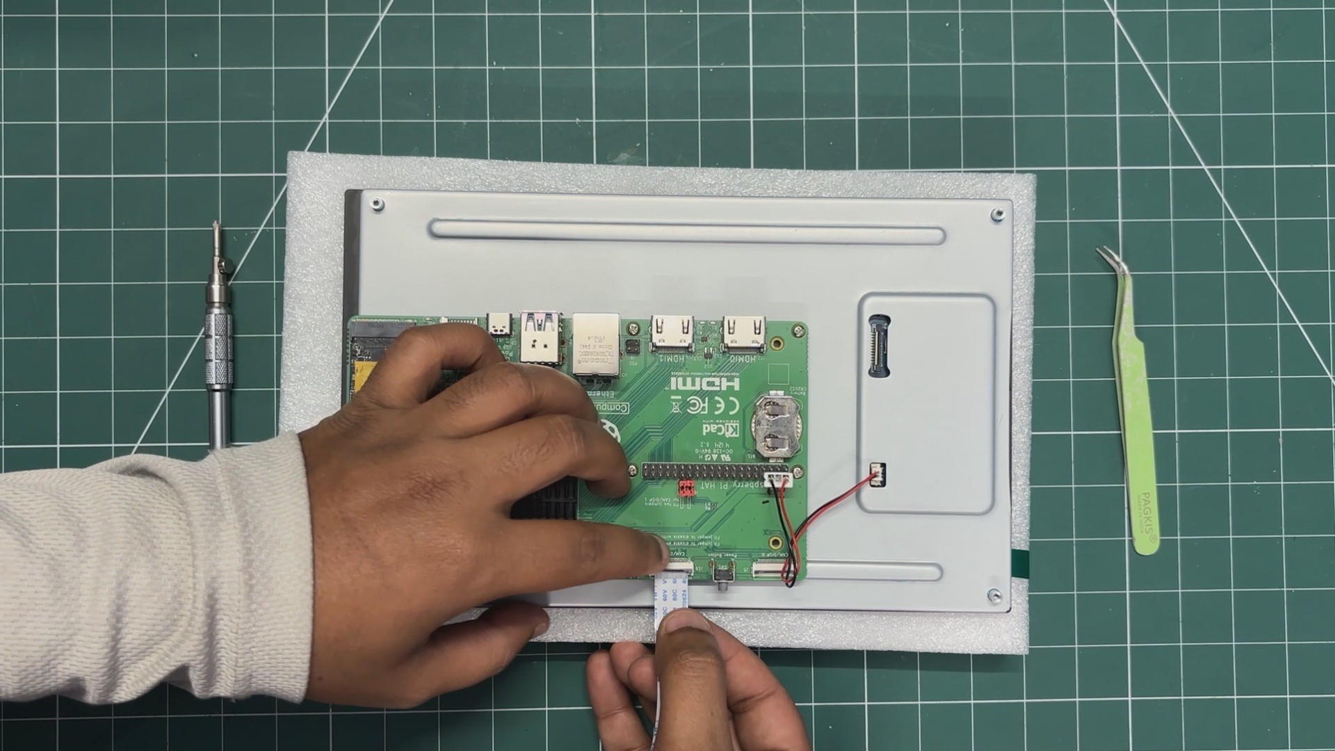

CM5 & MAX98357A ASSEMBLY
Now comes the assembly process for the MAX98357A I2S amplifier and Raspberry Pi CM5.
We start by connecting the 5V and GND pins of the CM5 to the VCC and GND pins of the MAX98357A.
Next, we connect the BCLK pin of the MAX98357A to GPIO18 on the CM5 GPIO header, followed by connecting LRC to GPIO19 and DIN to GPIO21.
Finally, we connect the speaker's positive and negative terminals to the Speaker positive and negative outputs on the MAX98357A amplifier, completing the audio connection between the CM5 and the speaker.

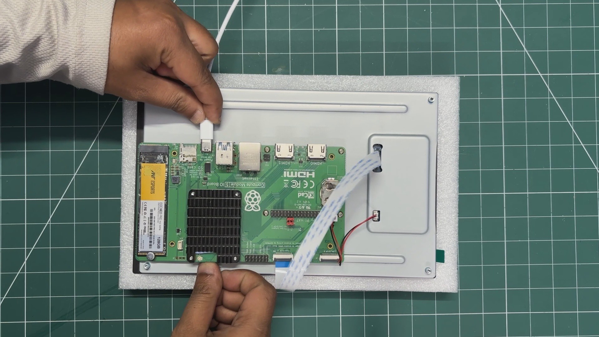

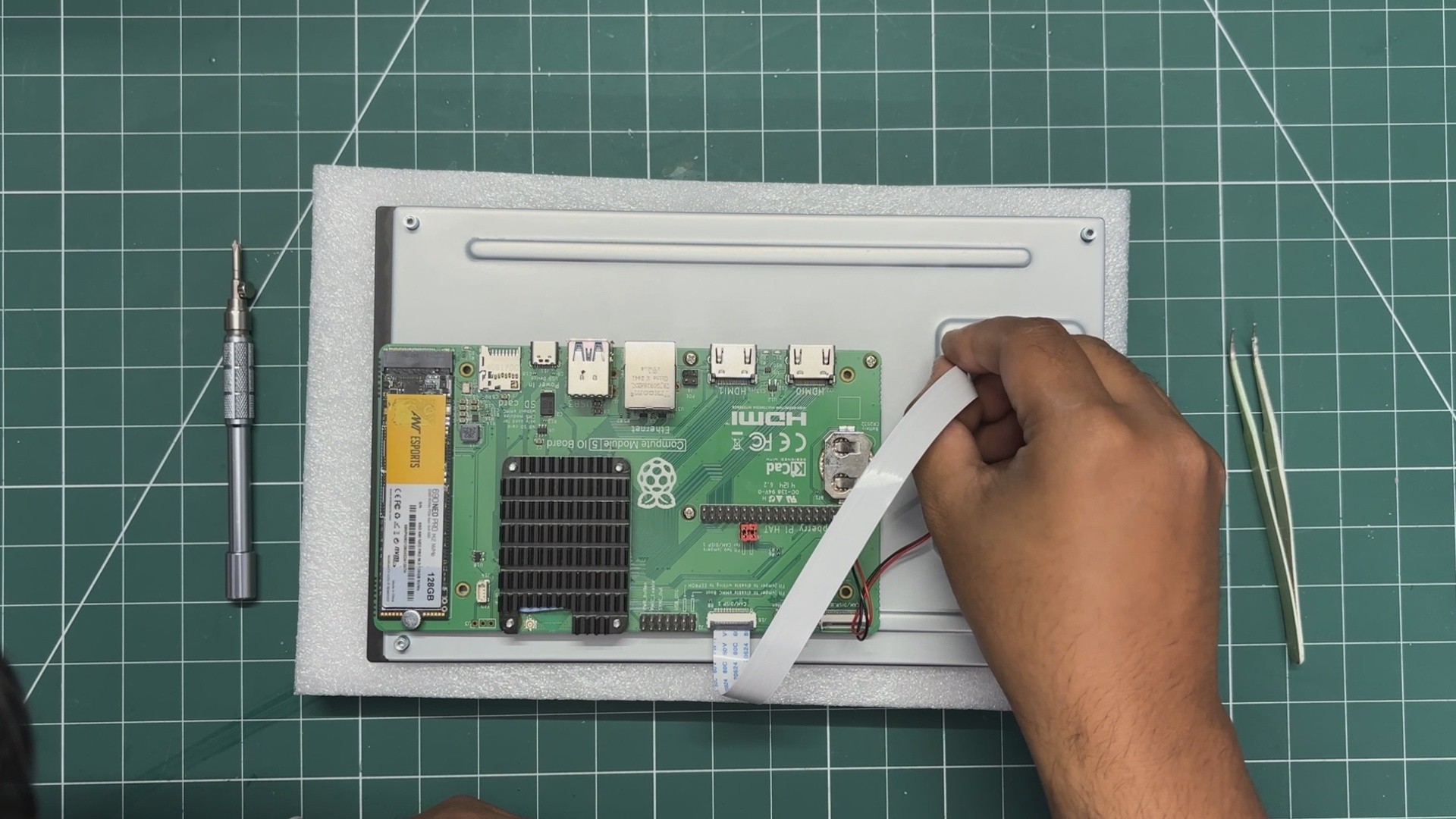

FRAME & CM5-DISPLAY ASSEMBLY
The display is now placed into the frame, making sure it sits properly in position.
We then reconnect the CM5's DSI connector to the display's DSI connector for video and touch communication.
Finally, we connect the display's power input to the 5V and GND pins on the CM5, providing the required power to the screen.
