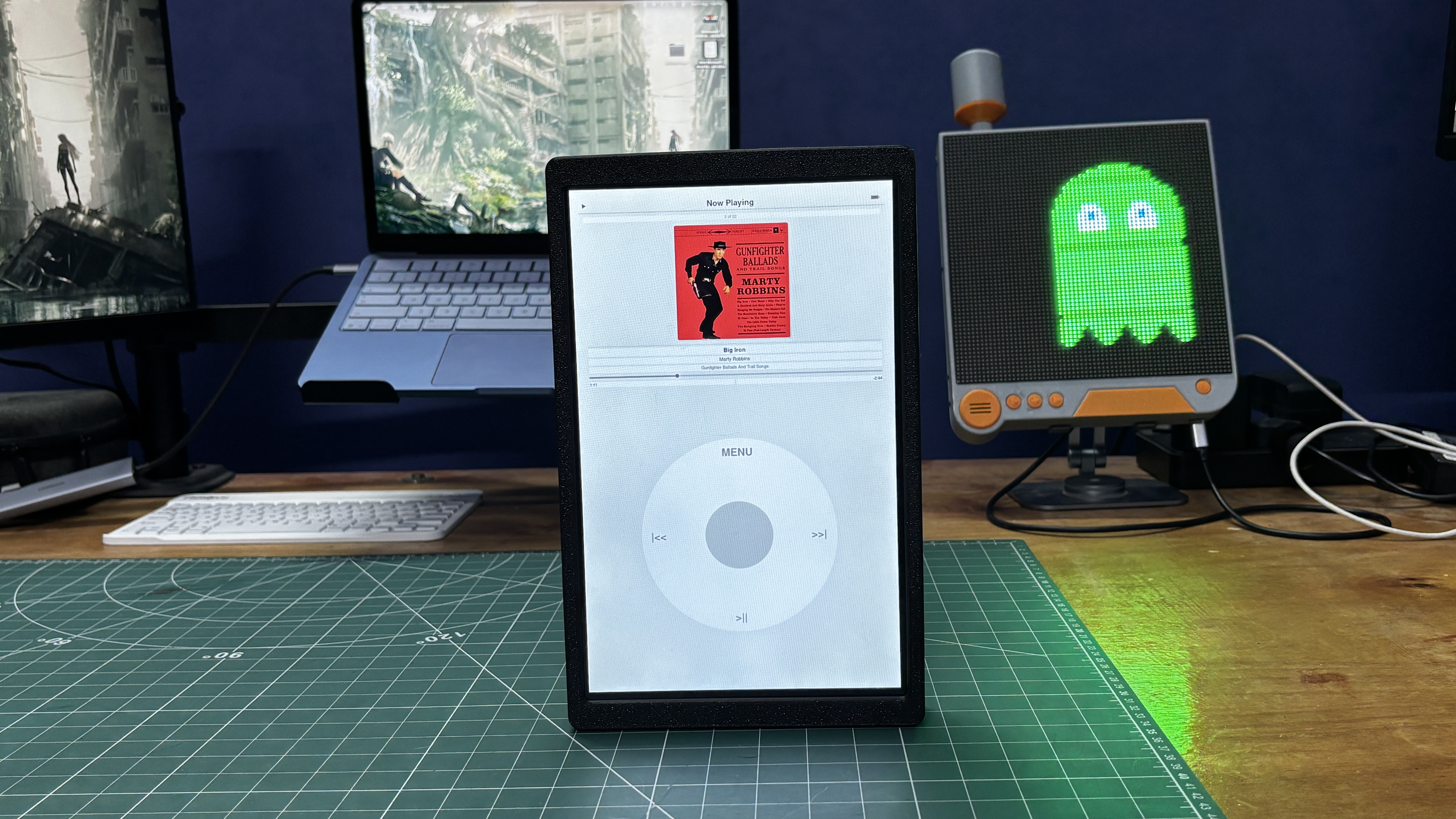

Here's something BIG. Meet iBrick, a giant, 3rd-generation iPod Nano-inspired music player, powered by a Raspberry Pi Compute Module 5.
The 3rd-generation iPod Nano was one of those gadgets I always admired growing up. Its compact form factor, vibrant user interface, and the iconic click wheel made it one of the most recognizable portable music players of its time. Although I never got the chance to own one, the design always stuck with me.
Today, original iPod Nanos are becoming increasingly difficult to find in good condition. Many available units have worn-out batteries, cosmetic damage, or are simply too expensive to justify buying for a project.
Rather than restoring an old device, I decided to recreate the experience but with a giant twist.
At the heart of this build is a Raspberry Pi Compute Module 5 paired with a 10-inch Waveshare touchscreen. Instead of starting from scratch, I repurposed the hardware from my previous Absolute Linux Tablet project, giving it a completely new identity through a redesigned enclosure and custom software.
This article walks through the entire process of transforming that Linux tablet into a fully functional giant iPod Nano.

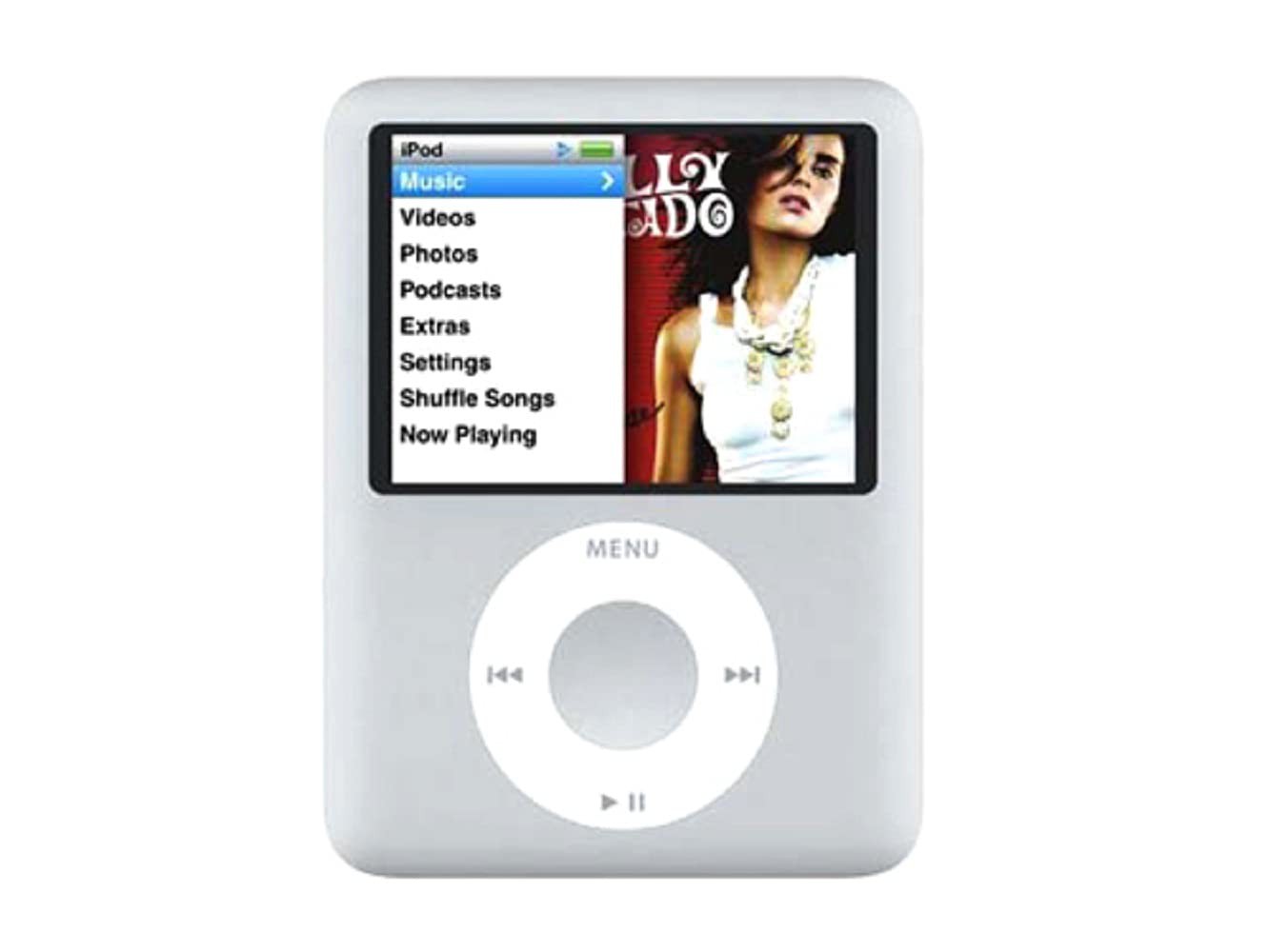

IPOD 3rd GENERATION
Released in 2007, the 3rd-generation iPod Nano marked a significant departure from its predecessors. Nicknamed the "fat Nano" due to its shorter and wider design, it featured a 2-inch QVGA color display with a resolution of 320 × 240 pixels, making it ideal for both music and video playback.
The device retained Apple's iconic Click Wheel, a touch-sensitive circular controller that combined rotational scrolling with five physical buttons, allowing users to navigate menus quickly with one hand. Available in 4 GB and 8 GB flash storage variants, the iPod Nano could store thousands of songs and supported popular audio formats such as MP3, AAC, WAV, AIFF, and Apple Lossless, along with H.264 and MPEG-4 video playback.
Powered by a rechargeable lithium-ion battery, Apple rated it for up to 24 hours of music playback and around 5 hours of video playback on a single charge. Its compact aluminum enclosure, bright display, and intuitive user interface made it one of the most recognizable portable media players of its era.

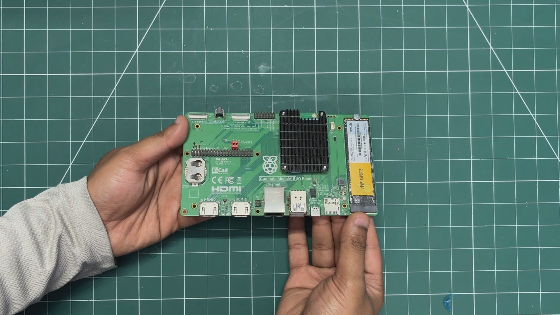

The brain of our project is the Raspberry Pi CM5, which is a more industrial-oriented version of the usual Raspberry Pi 5 in a module form factor. It uses the same Broadcom BCM2712 quad-core 64-bit Arm Cortex-A76 (Armv8) SoC running at 2.4 GHz, but in a much more compact package.
The CM5 sits on an evaluation board that breaks out USB ports, Ethernet, dual HDMI ports, GPIO headers, an SD card slot, and even an M.2 port for adding an NVMe SSD.
Here, we are using the 4GB variant, which comes with onboard 32GB eMMC storage.
For the operating system, I used the new Raspberry Pi OS based on Debian Trixie. The OS is installed on an NVMe SSD, which makes the system super fast. OS installation was done using Raspberry Pi Imager. We connected the SSD using an M.2-to-USB adapter and flashed the operating system directly onto the NVMe drive. Once the NVMe SSD was plugged into the CM5 board, the system booted directly from the SSD.

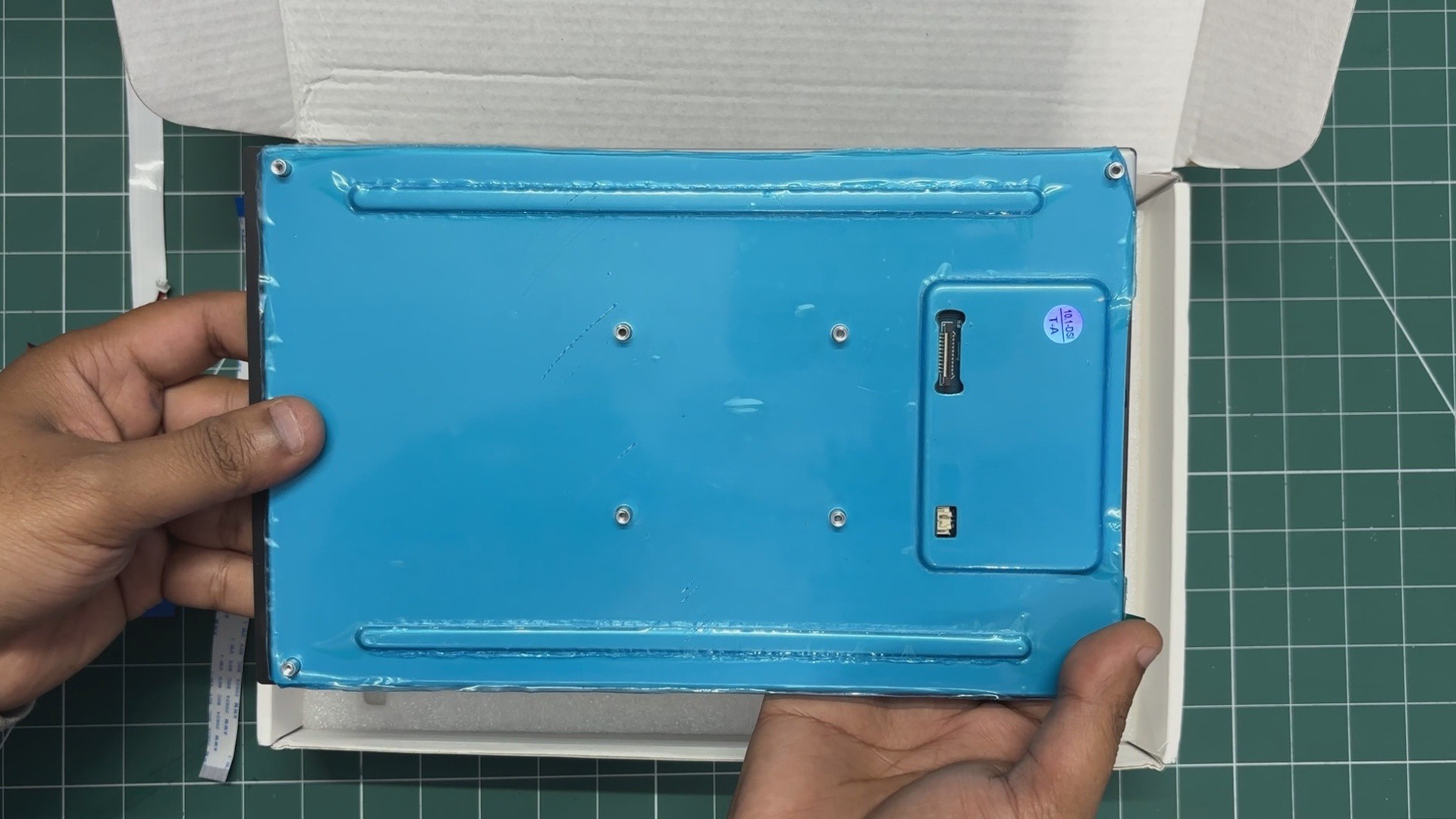

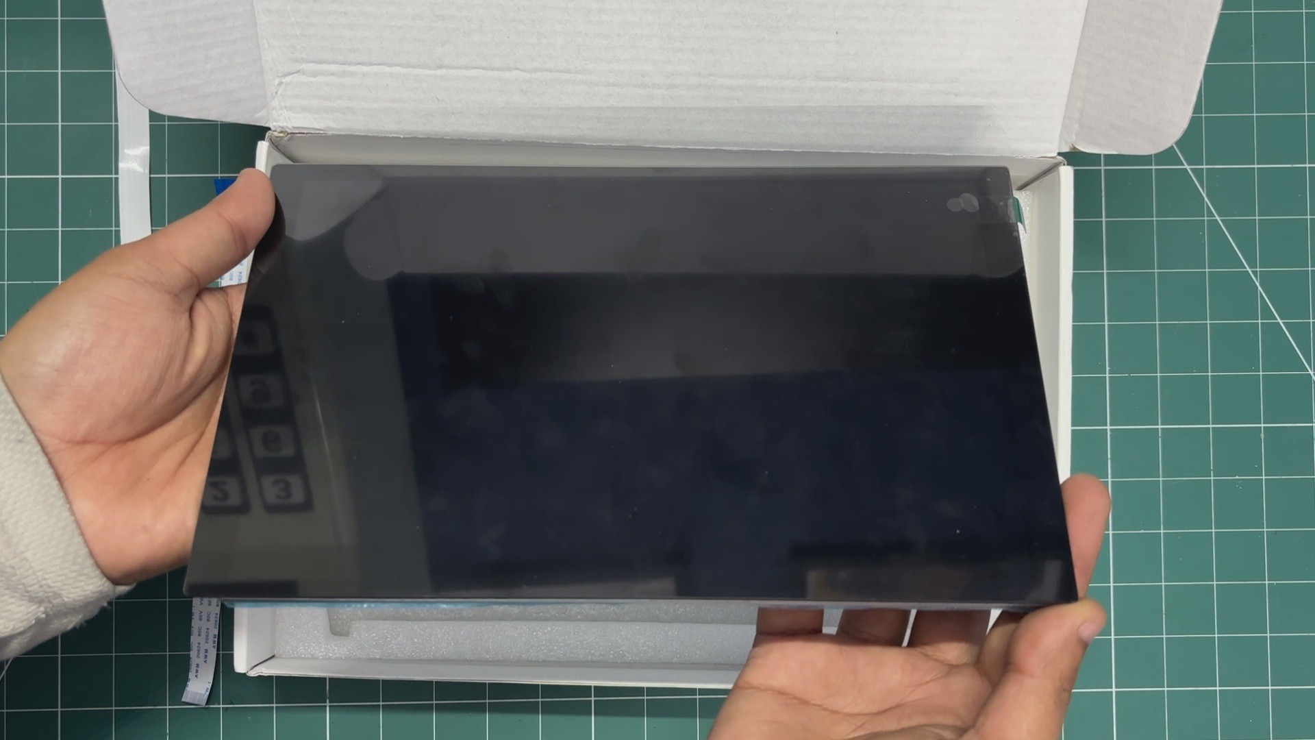

HARDWARE- WAVSHARE 10.1 INCH DSI SCREEN
For the main display, I wanted something huge, not the average 7-inch size, but something larger.
Connectivity was also an important factor, as I wanted a DSI interface instead of HDMI.
So, I selected Waveshare's 10.1-DSI-TOUCH-A display for this project. It is a portrait touchscreen LCD display with ten-point capacitive touch control. The display uses an IPS panel with a hardware resolution of 800×1280, which is perfect for our tablet application.
The LCD pairs with the Raspberry Pi through the DSI interface and supports a refresh rate...

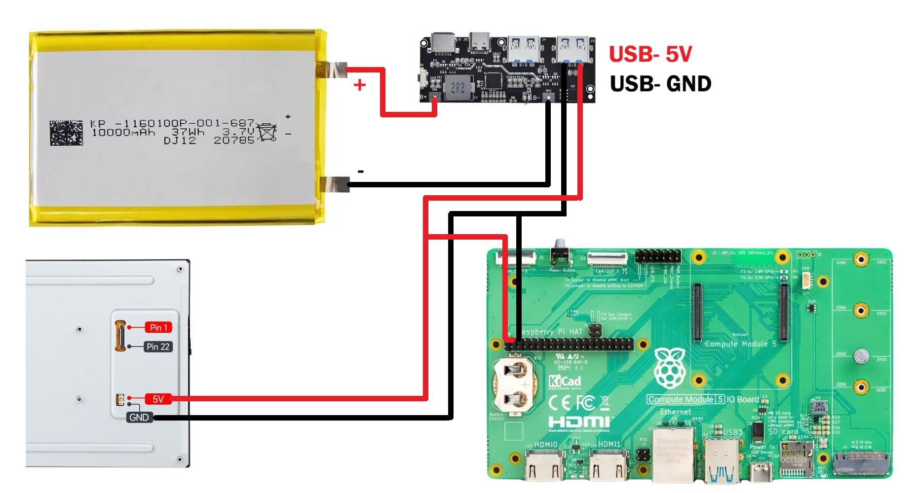

    POWER SOURCE ASSEMBLY
    • After harvesting the lithium-polymer cell and charger circuit from the power bank, we extended the battery wires by desoldering the original wires and replacing them with longer ones.
    • We connected the battery positive terminal to the B+ pad on the circuit and the battery negative terminal to the B- pad.
    • Next, we soldered two output wires to the USB port's 5V and GND terminals. For connecting these output wires to the Raspberry Pi header pins, we added a CON3 female header connector to the 5V and GND wires.
    • With this header connector, we can simply plug it onto the Raspberry Pi's GPIO header 5V and GND pins, which power the entire setup.
  • 3

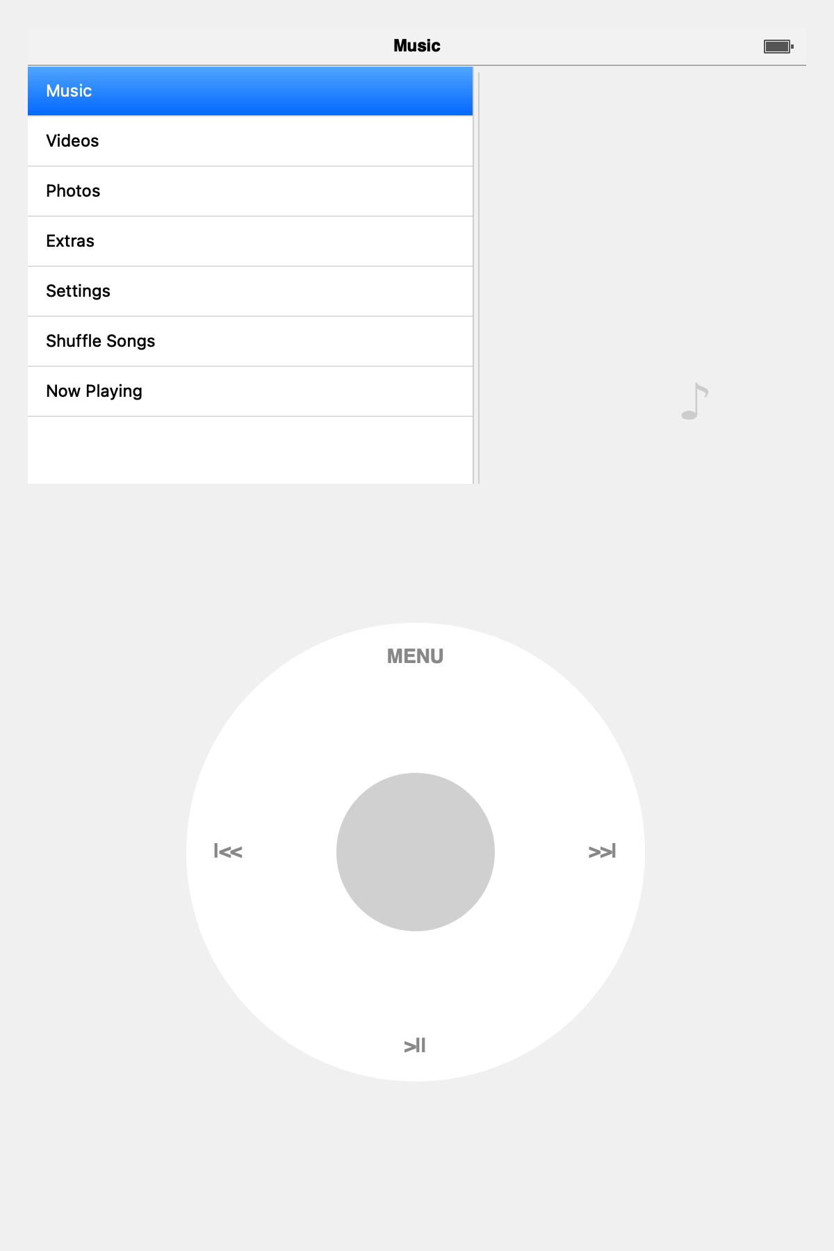

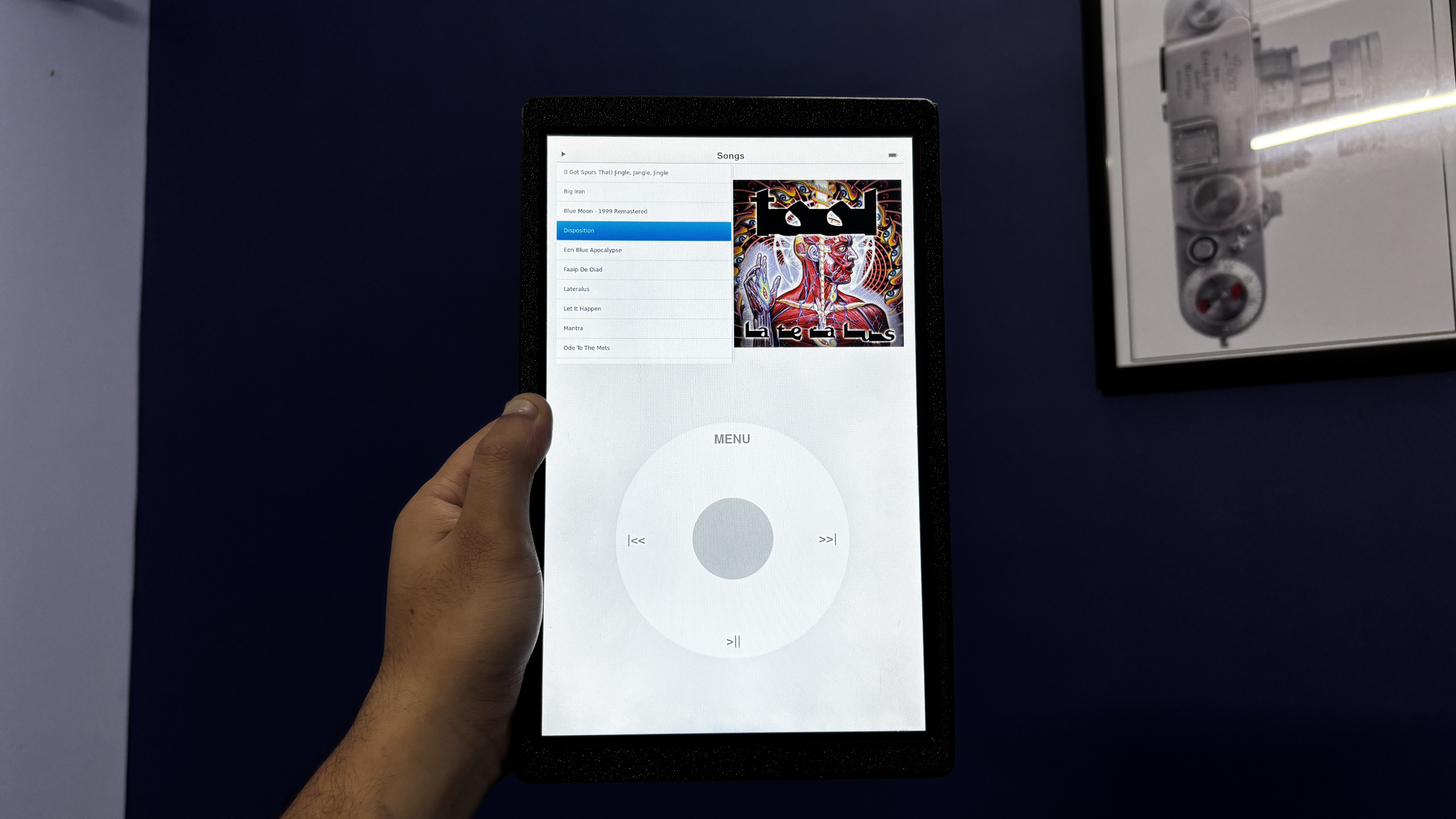

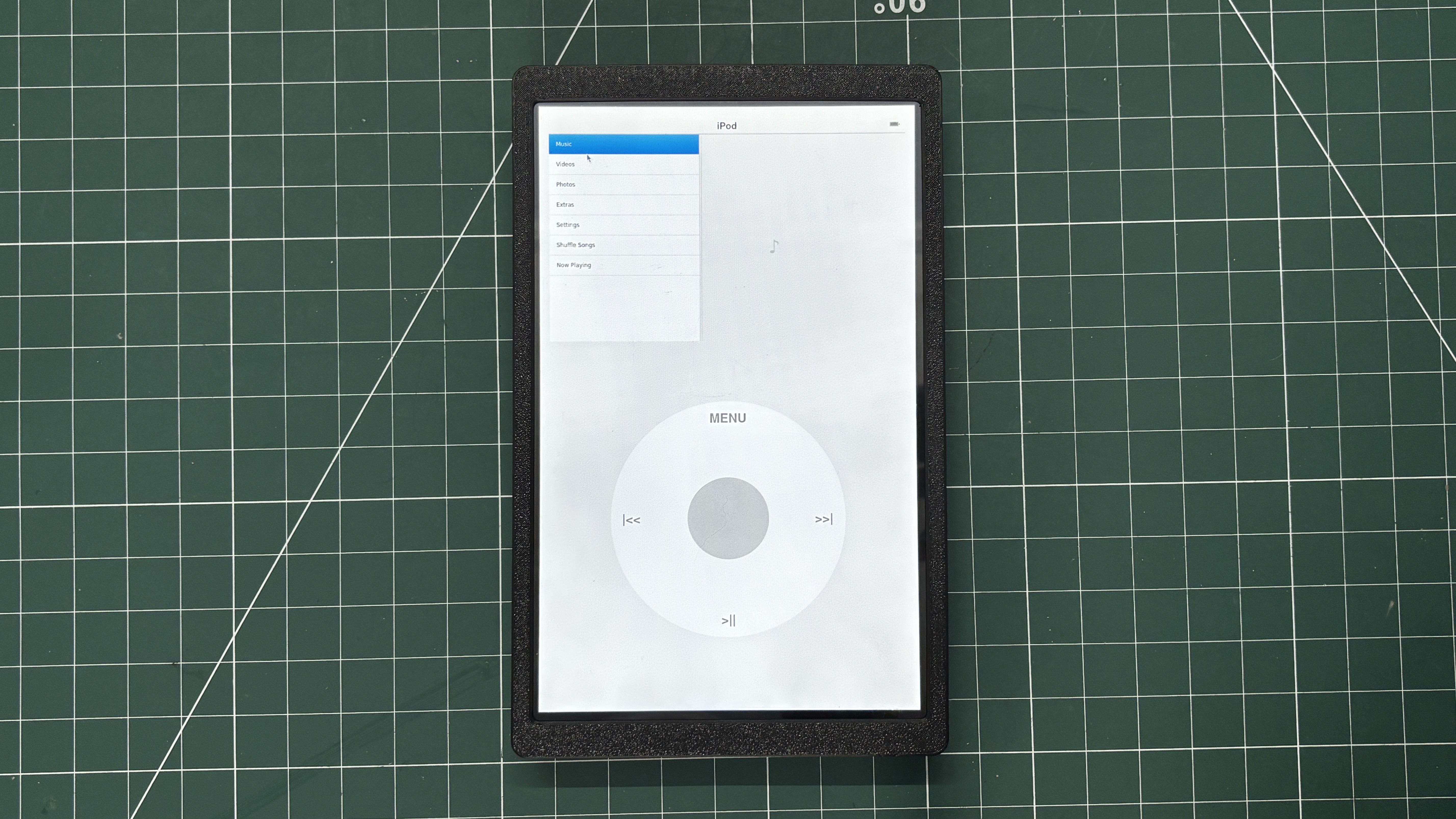

    IPOD UI
    The software and UI for this project were developed with the help of my friend Aahan Sharma, who handled the application development. You can find his GitHub repository linked below.
    https://github.com/AahanDoesGit/iPod-classic-Cm5
    The goal was to recreate the feel of the original iPod experience as closely as possible. The interface features authentic sliding stack navigation, where nested menus animate left and right just like the original firmware, along with a fully emulated click wheel supporting rotational scrolling and the classic five-button controls. The media library is scanned in the background using Mutagen, automatically detecting newly added MP3 files, while python-vlc provides hardware-accelerated audio and video playback for smooth, low-latency performance.
    The codebase is organized into three main sections: the core logic (library.py and player.py), the UI components (iPod_screen.py, now_playing.py, sliding_stack.py, and click_wheel.py), and the main application entry point (main.py), making the project modular and easy to extend.

    Sliding Nav Menu

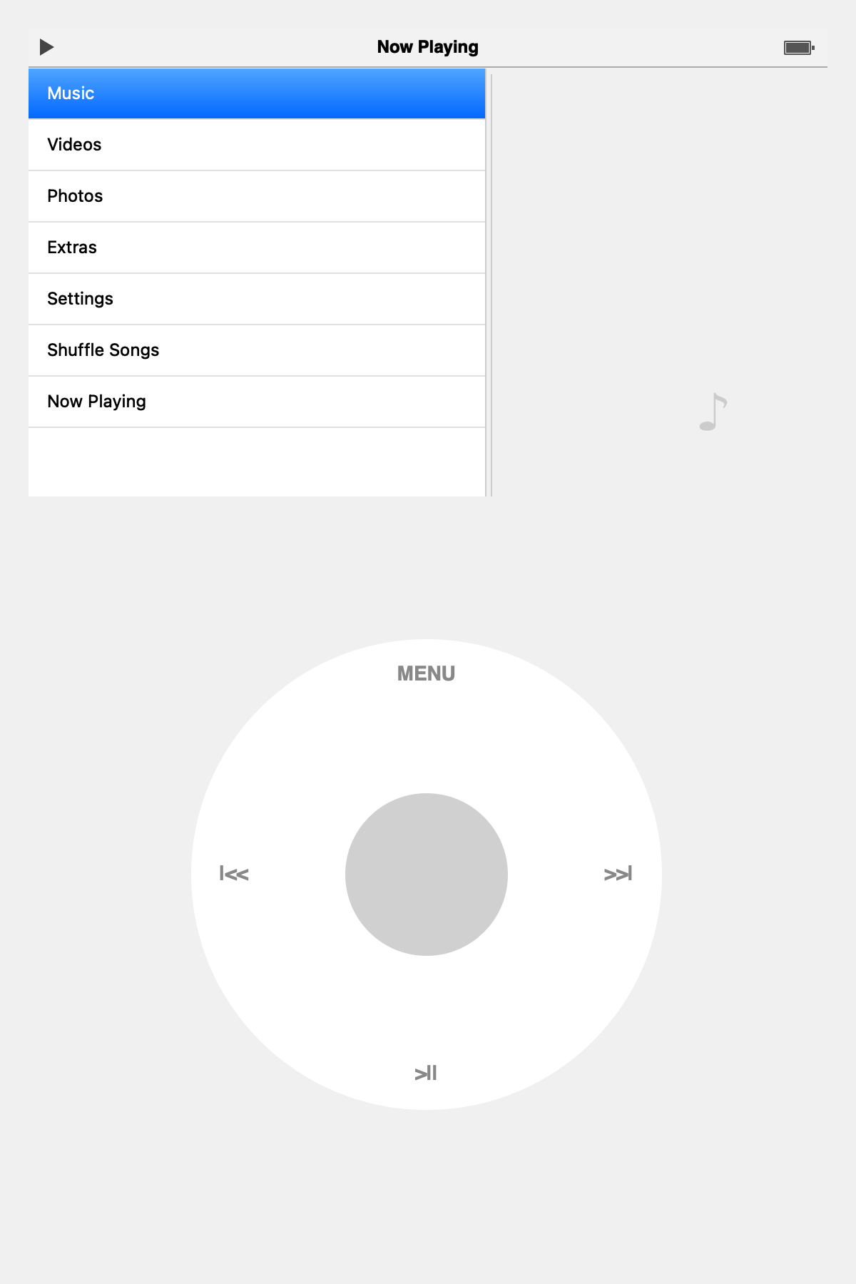

    The core of the iPod experience is the sliding menus. We built a custom 'SlidingStackWidget' 'ui/sliding_stack.py' that uses Qt 'QPropertyAnimation' to smoothly slide 'QWidget' pages in from the left or right when navigating
    Screen States and Nav
    The 'IPodScreen' 'ui/ipod_screen.py' acts as the state machine for the UI; it pushes and pops different menu lists using a 'menu_history' stack to remember where the user came from.
    # snippet from ui/ipod_screen.pydef _push(self, spec):self.menu_history.append((self.current_spec, self._current_row()))self.current_spec = specself.status_bar.set_title(self._screen_title(spec))next_screen = self._create_screen(spec)self.sliding_stack.setWidget(next_screen, direction=1)self.current_screen_widget = next_screen
