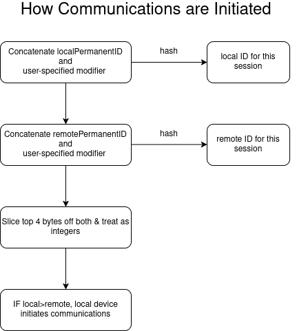

  • How communications are initiated
    Legionlabs • 09/17/2026 at 02:01 • 0 comments
    This possibly helpful chart shows how communications are initiated between two devices. I'll make more for the various other functions of the device.
    Important things to note:
    1. If there's no user-specified identifier, the channel will be static. So at least the server operator (possibly others, depends on MQTT server settings) can determine how many unique devices have contacted each other.
    2. They can also determine how many times, and when, specific devices have contacted each other.
    3. If someone obtains your device, they could determine which sessions were yours.
    It is possible to mitigate these using simple schemes:
    1. Using the first 7 digits of the Unix timestamp would mitigate the first two.
    2. Choosing a random string at the end of communications to use for the next chat mitigates all 3.
    3. If you don't care about preventing traffic analysis, you can use a static value.
