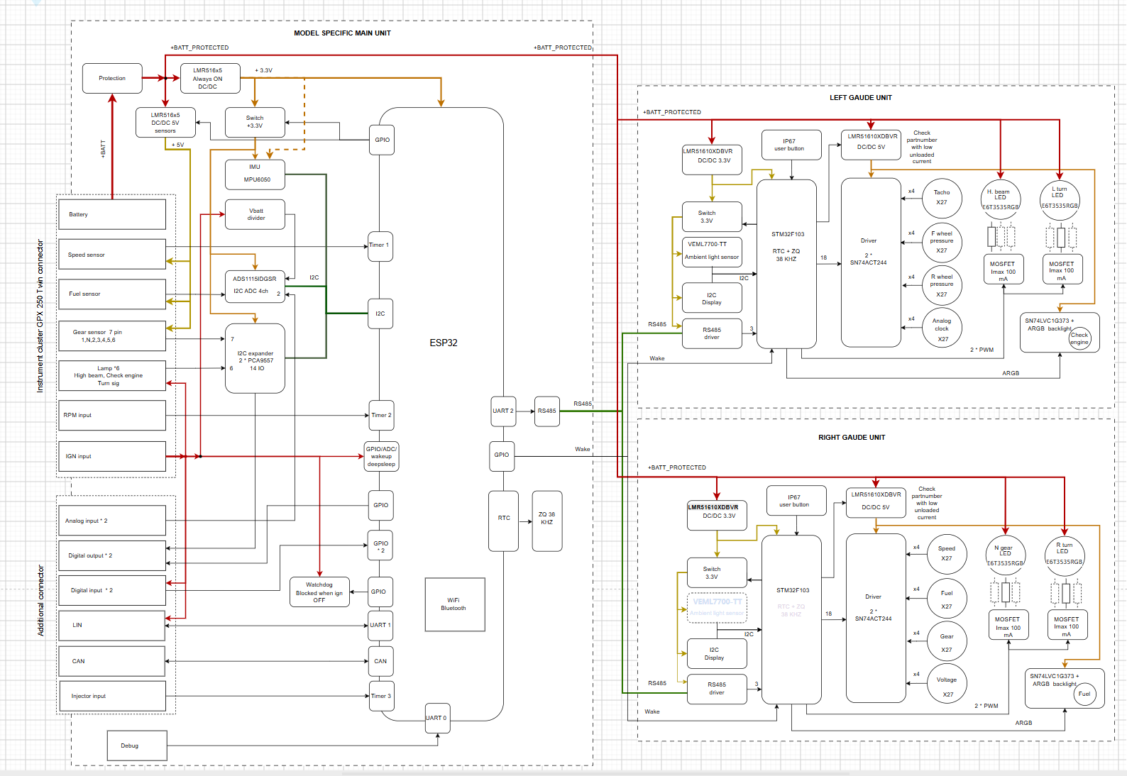

Two identical STM32 instrument modules
Each module is planned to contain:
  • An STM32F103 microcontroller.
  • Four gauge motors.
  • A display.
  • A real-time clock (RTC).
  • An ambient light sensor.
  • Its own voltage regulators.
  • Two bright indicator lamps based on high-power LEDs.
  • An RS-485 interface to the main unit.
ESP32 main unit
The main unit will contain the motorcycle interface, power-supply protection, RS-485, an IMU, an external watchdog, BLE for communication with a phone and Wi-Fi.
The ESP32 will handle application logic and generate display content. Each STM32 module will control its local instrument hardware. The intended development environment is the Arduino framework with PlatformIO.
First electronics block diagram
First electronics architecture. Proposed design, not a finished circuit schematic. Open the image for full resolution.

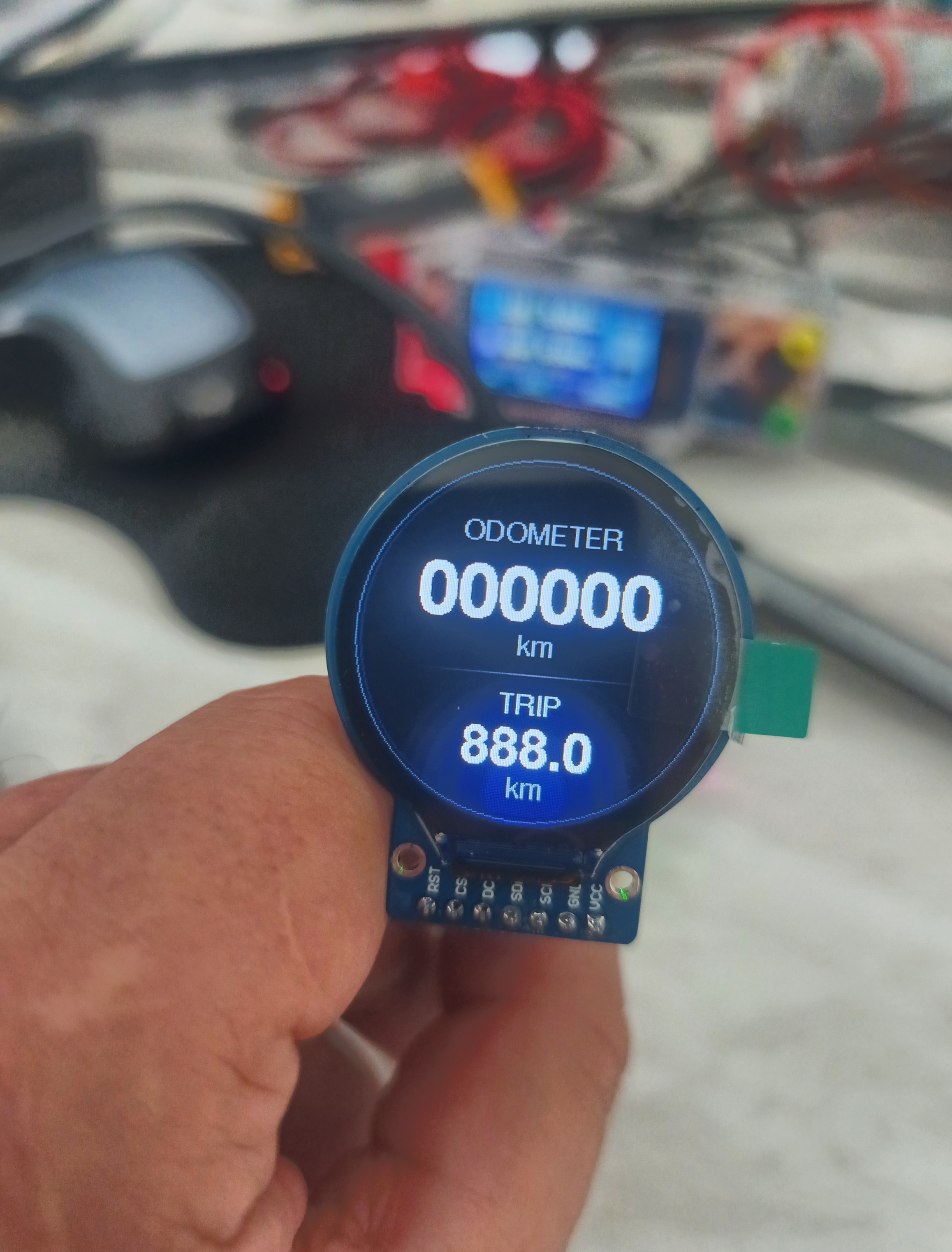

  • The displays have arrived — from AI render to real hardware
    Sergei5 hours ago 0 comments
    The displays arrived today, and I couldn’t resist trying out the odometer and navigation prompts on them.
    I grabbed a Waveshare ESP32 development board, connected a display and asked Codex to write the code. Three minutes later, it was working.
    It looks fantastic — just like the AI render, only now it’s real hardware in my hand.
    Odometer and trip display running on the round screen
    The first odometer and trip screen on the real display.

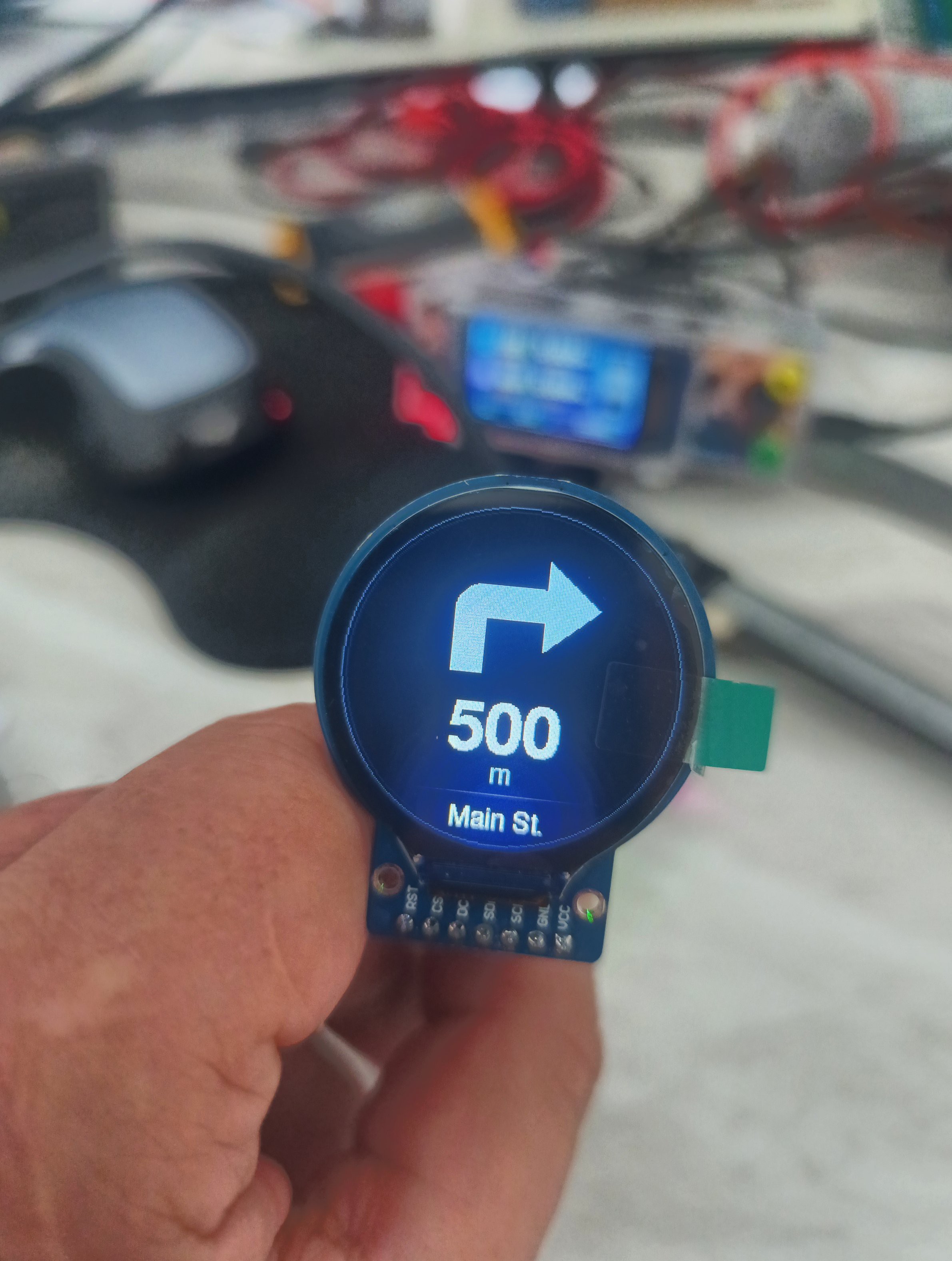

    Navigation prompt with a right-turn arrow and 500 metres on the round display
    A first look at the navigation prompt: turn right in 500 metres.

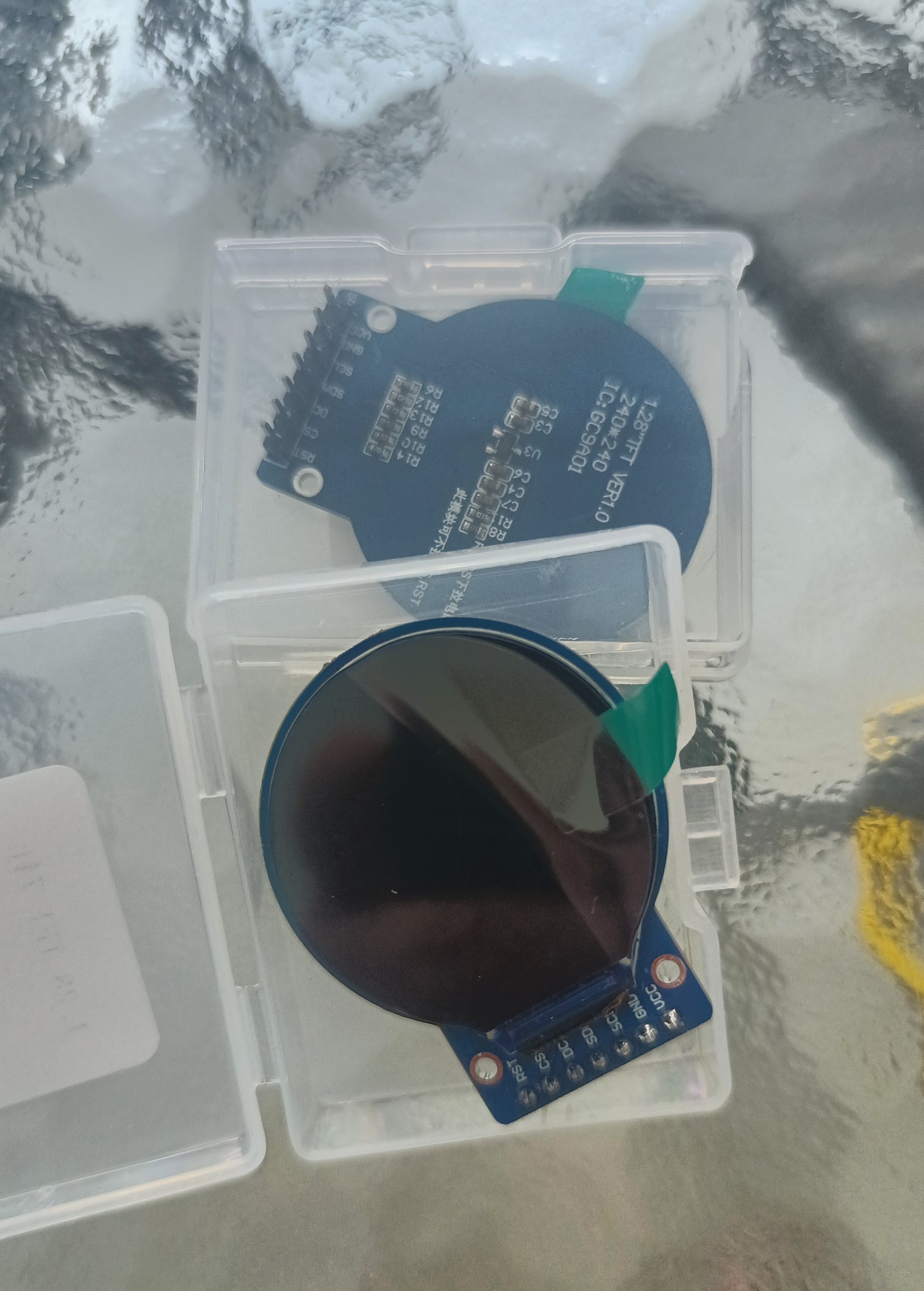

    The newly arrived round display modules in their cases
    The round displays, fresh out of the delivery box.
    One small surprise: SPI, not I²C
    The displays turned out to use SPI rather than I²C. Not a big problem: I²C was still shown as the display connection in the first block diagram, so that label needs updating. There are enough microcontroller pins for everything.

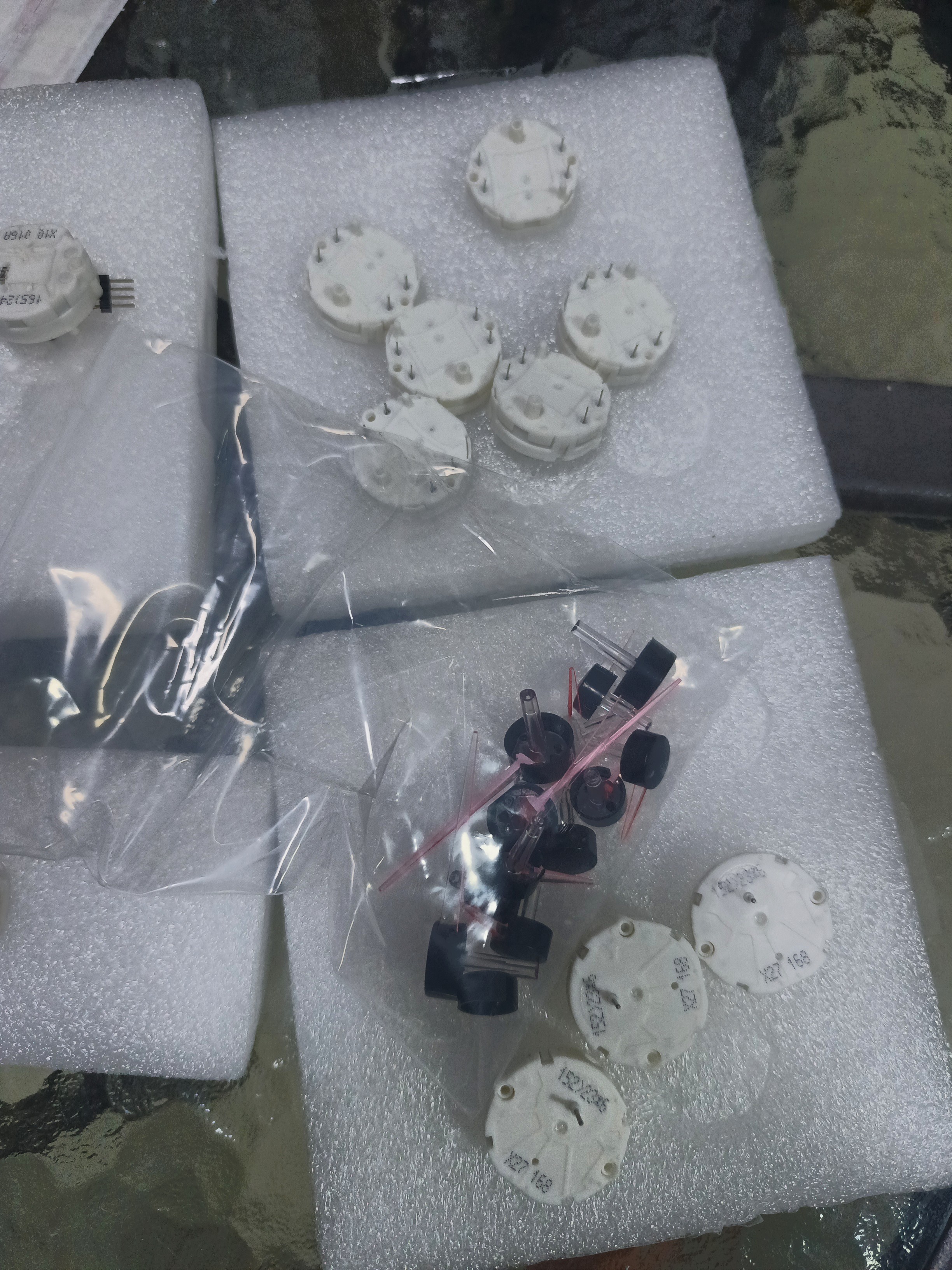

    At the start of development, I received the parts that were most critical to my design: the gauge motors and needles ordered from AliExpress. I wanted to base the layout on the actual components, so I carefully measured them and created 3D models for accurate packaging and mechanical design.
    I also checked that the motors worked using an Arduino and a very simple sketch.
    Gauge motors and needles received from AliExpress
    The actual motors and needles: the starting point for measurements, 3D models and the instrument layout.

    I also drew the first electronics block diagram. The architecture uses an ESP32 main unit connected over RS-485 to two identical STM32F103 instrument modules. Each module has four motors, a display, RTC, an ambient light sensor, its own regulators and two bright LED indicator lamps.
    Proposed architecture, first version. Hardware and firmware are still being developed.
