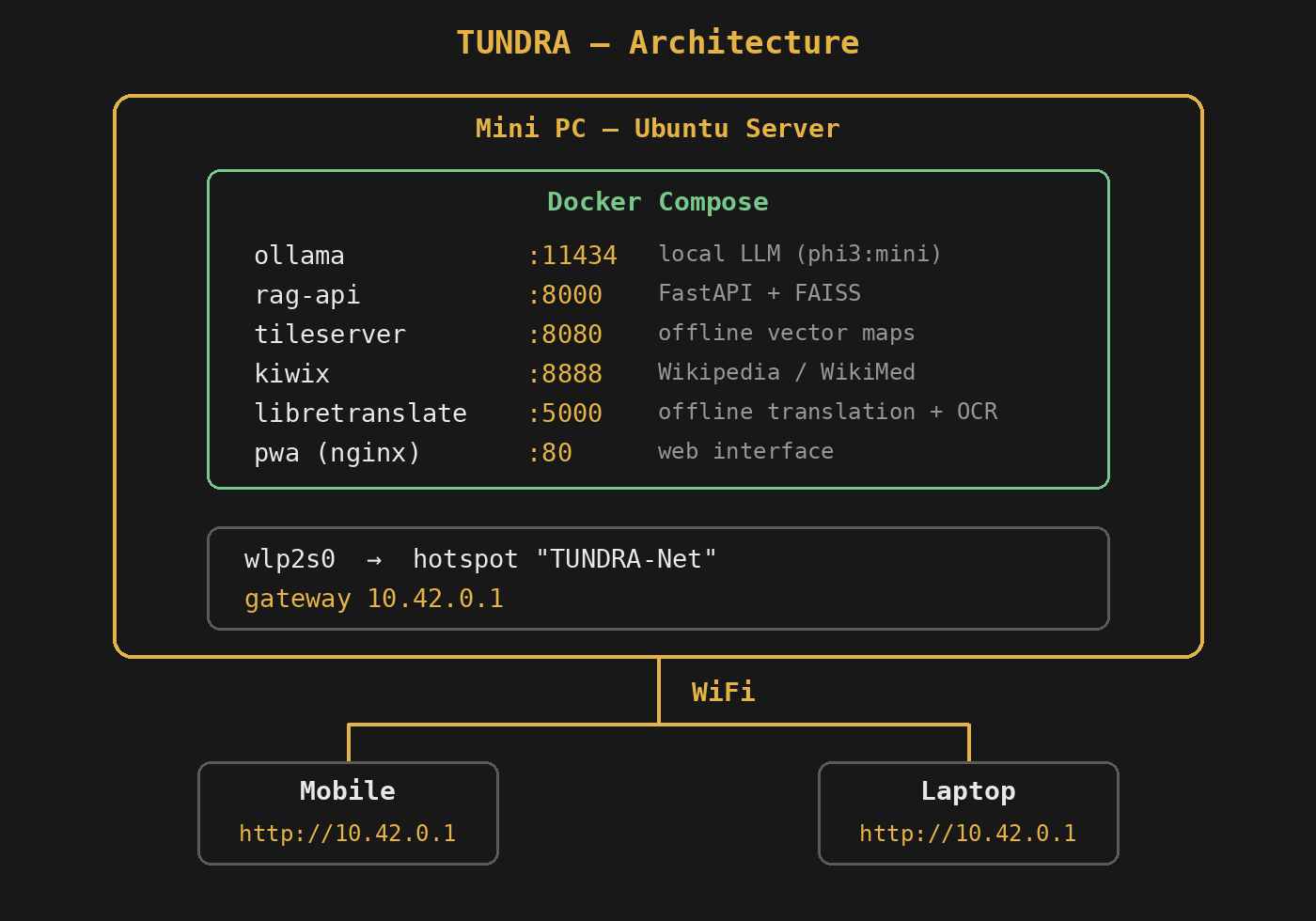

Architecture
Core services
Service                                         Port                               Technology                                          Purpose
Frontend UI80NGINX / PWAMulti-theme Progressive Web App (Basic / Modern / Retro), installable on mobile
Local AI & RAG8000/1143FastAPI + Ollama +
FAISS
`phi3:mini` + `nomic-embed-text` querying survival and first-aid manuals
Offline translator5000LibreTranslate + Tesseract OCRNeural translation across 9 languages (ES, EN, DE, FR, UK, RU, IT, AR, TR) with OCR image support
Offline maps8080Tileserver-GLVector tile maps via MBTiles (sample map of Zurich)
Knowledge base8888KiwixSelected offline documents (ZIM format)
Networking & boot sequence
- Access point: broadcasts the hotspot `TUNDRA-Net` on interface `wlp2s0`.
- Static gateway: always reachable at `http://10.42.0.1` from any browser.
- Headless startup: a custom Systemd service enforces the boot order (NetworkManager hotspot, then Docker Compose).
- Zero cloud dependency: fully operational offline. Internet is only needed for initial setup and content updates.

Prototype scope & status
A working prototype for testing and demonstration, with a small survival knowledge base (water, fire, shelter, first aid, food), a sample map of Zurich and the English WikiMed encyclopedia. The architecture is designed to scale with more documents, maps and ZIM files.
Status: functional. Headless cold start without ethernet validated.
