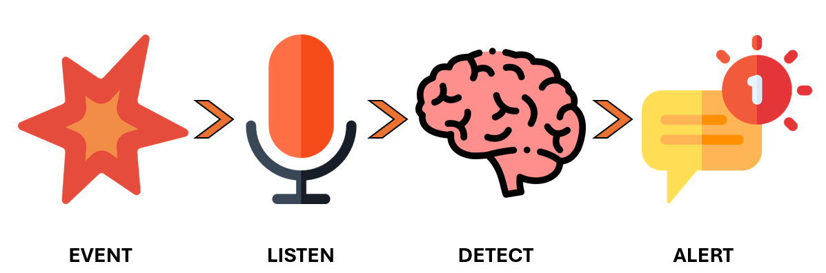

From Sound to Action
When a potentially dangerous event occurs, the system turns sound into a signal for action:
Fall Thud → Fall Detected
Glass Break → Intrusion / Accident
Smoke Alarm → Fire Warning
But detecting danger is only useful if the safety system itself can be trusted.

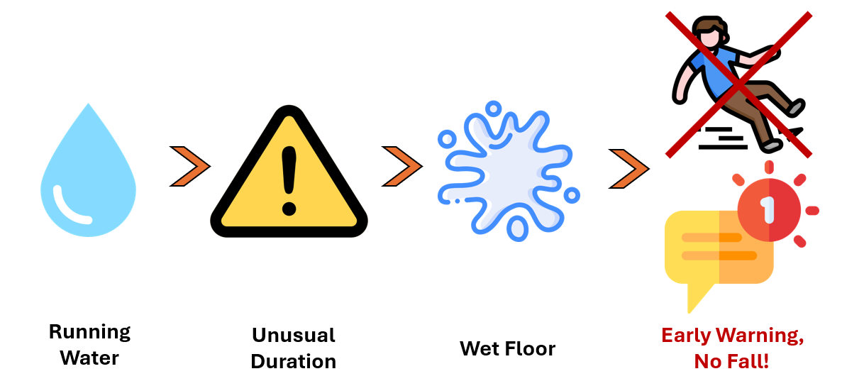

From Detection to Early Warning
So far, these examples respond after an event has occurred.
But what if sound could also warn us before an accident happens?
Some sounds are not emergencies themselves, but may indicate that risk is increasing. Continuous running water, for example, could indicate an unattended faucet or leak. If it continues for an unusual amount of time, the system could issue a warning before water accumulates and creates a slipping hazard.
Instead of only asking:
What happened?
the system can also ask:
What sounds unusual—and could it become dangerous
The goal is not only to hear danger when it happens, but to recognize the acoustic signals that may precede it.

    Detecting an emergency is important, but preventing an emergency before it happens can be even more valuable.
    We therefore added a risk detection feature based on sound patterns over time. Instead of reacting to a single sound event, the system continuously monitors repeated environmental sounds.
    For example, YAMNet can recognize water-related sounds such as dripping or running water. A single water drip is usually normal, but if the system continuously detects water sounds over a certain period of time, it may indicate a possible water leak.
    The system can then generate an early warning before the situation develops into a more serious problem.
    This adds a second layer of home safety:
    Emergency detection → respond to danger
    Risk prediction → identify potential danger early
