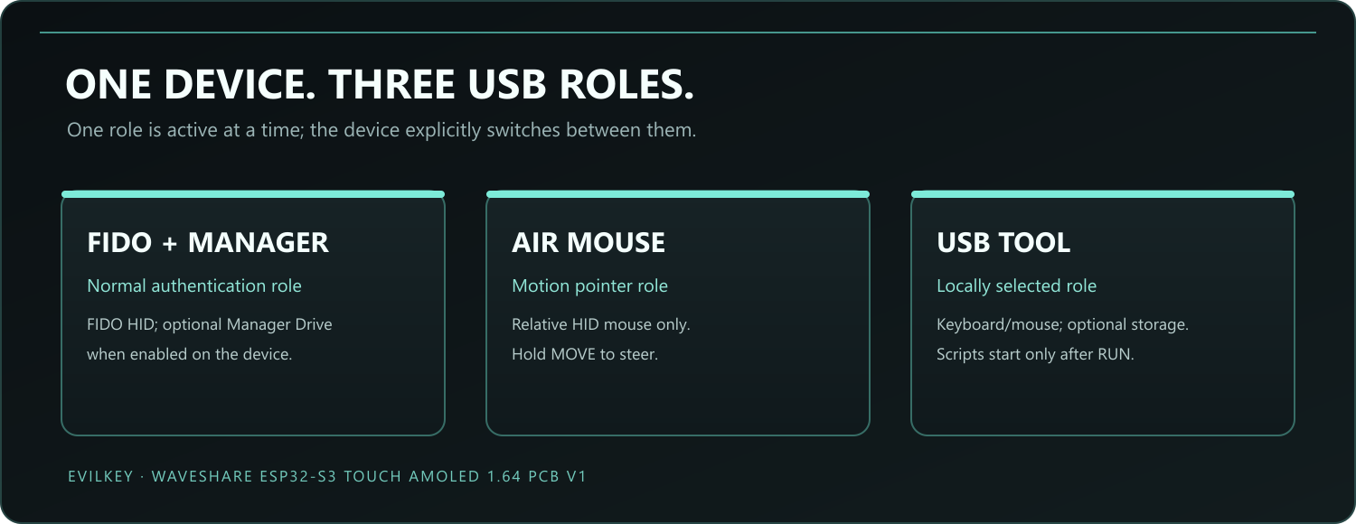

ESP32-S3 FIDO2 prototype: touch AMOLED, microSD apps, HID scripts, USB/BLE AirMouse and an IMU BLE Gamepad. A key that got carried away.
A search for a FIDO2 key turned into EvilKey: an ESP32-S3 prototype with touch AMOLED, on-device PIN, USB/BLE AirMouse, an IMU gamepad, HID scripts and microSD apps. Firmware 0.9.1 supports Waveshare PCB V1.0/V1.1, ABI6 apps and signed updates with separate RESCUE firmware.
