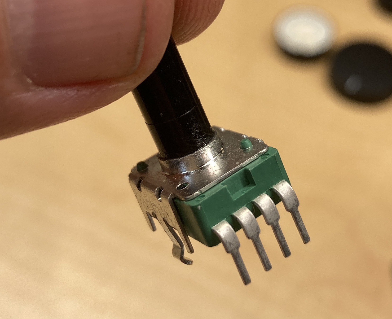

Lately I'm really enamored of these RV112-FF dual 360-degree potentiometers from Taiwan Alpha. Really they are analog rotary encoders; they give a really precise and subtle finger interface to digital instruments. Most rotary encoders this precise cost a lot more and are big complicated weird components. These look just like normal pots, and they almost are. Each unit has two separate potentiometers arranged 90 degrees apart. By combining A/D readings from those two pots with a bit of trigonometry, you can calculate the absolute angle of the shaft around a complete rotation. (If you hate trig, don't worry; my AI intern Claude has just written a nice Arduino library for reading the RV112-FF.) Just like a standard rotary encoder -- but unlike a standard potentiometer -- you can spin the RV112-FF around and around forever. No matter where you twist it, the reading is reported as an absolute floating-point angle from 0 to 360 degrees.

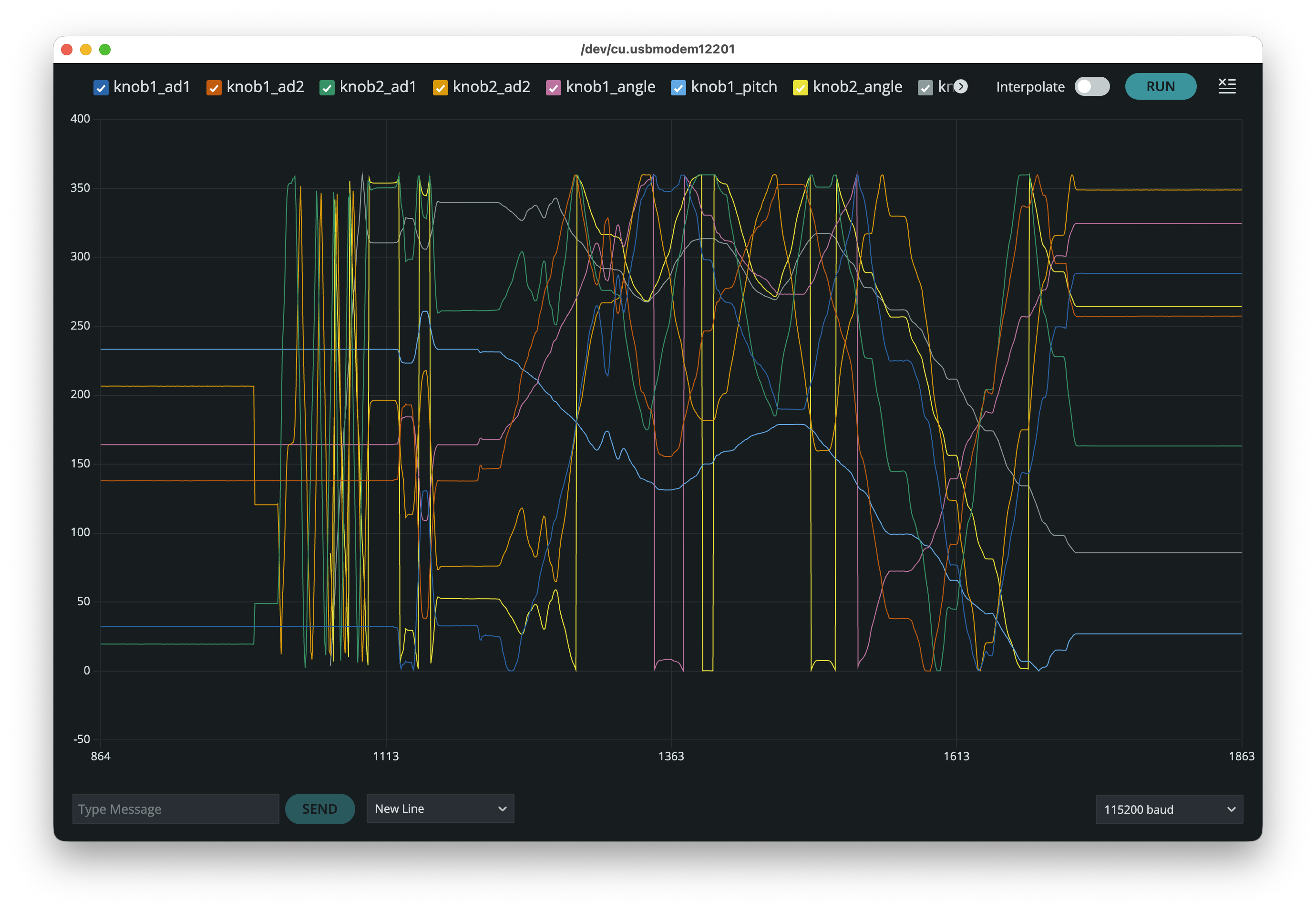

    This sketch doesn't just make audio waves -- it can also make squiggles on your screen! If you turn on the Arduino Serial Plotter you'll see it plot a bunch of signals. For each pot (knob1 & knob2) we plot the raw A/D value for both wipers, the calculated angle in degrees, and the calculated pitch. Eight values in all. Above you can see a plot of all of them at once. It's kind of pretty, but hard to read. The next plot is simpler:

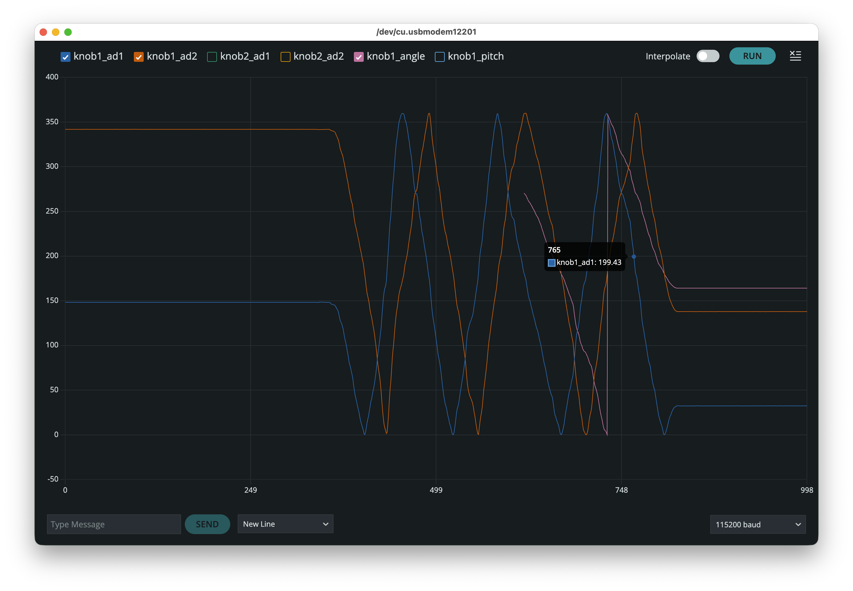

    This is a plot of just the two wiper readings in knob 1 (blue and red), showing some details of these signals as I turn the knob slowly by hand right after a reboot. You can see that the two pots' readings are 90 degrees apart, and each pot sweeps a value from 0% to 100% and back. (Inside the pot, on each track the supply current is fed to the center of the track and grounded at both ends, unlike a standard pot which feeds current at one end of the track and grounds the other end.) Notice how the sketch starts to report the angle measurement (pink) once isCalibrated() returns true, which happens after the shaft has turned a bit less than two full rotations. That's one complete turn to find the maximum values, and a second time around just to be sure.

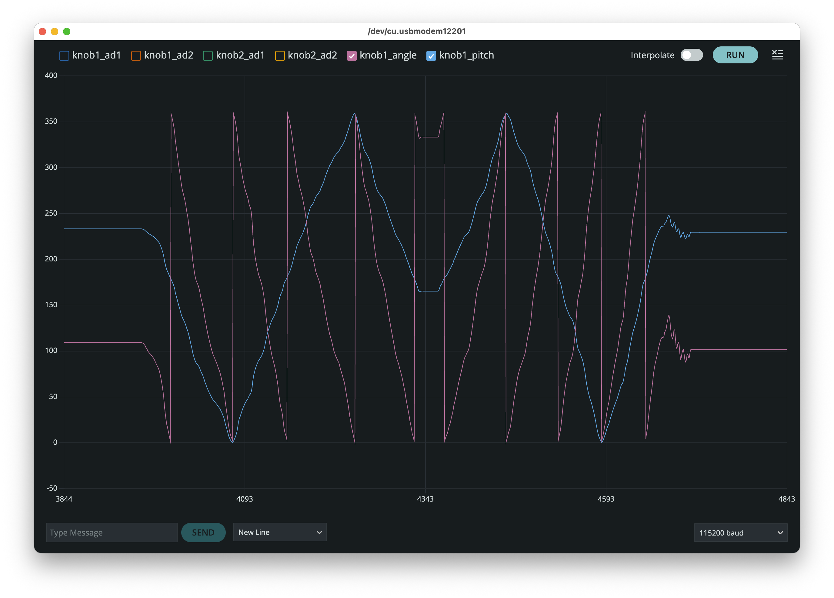

    Our RV112FF library reports the absolute position of these rotary encoders as an angle from 0 to 360 degrees. Sweep past 360 and you're back to 0. But sometimes we might want more degrees than that! Our MultiTurnKnob library built on top of RV112FF lets us count how many degrees the rotor has spun since the count was reset, similar to how Arduino's PJRC Rotary Encoder Library counts turns of a rotary encoder. The accumulated angle is a signed float, where negative values are counter-clockwise. With this, we can map our accumulated angle onto any other parameter. For instance, we can map four complete twists of the knob (pink, above) to an oscillator sweep up and down the audible frequency range (blue).
    (The slight wiggly-ness in this plot is due to slight wiggly-ness in my fingers; it's not due to noise or the components.)
