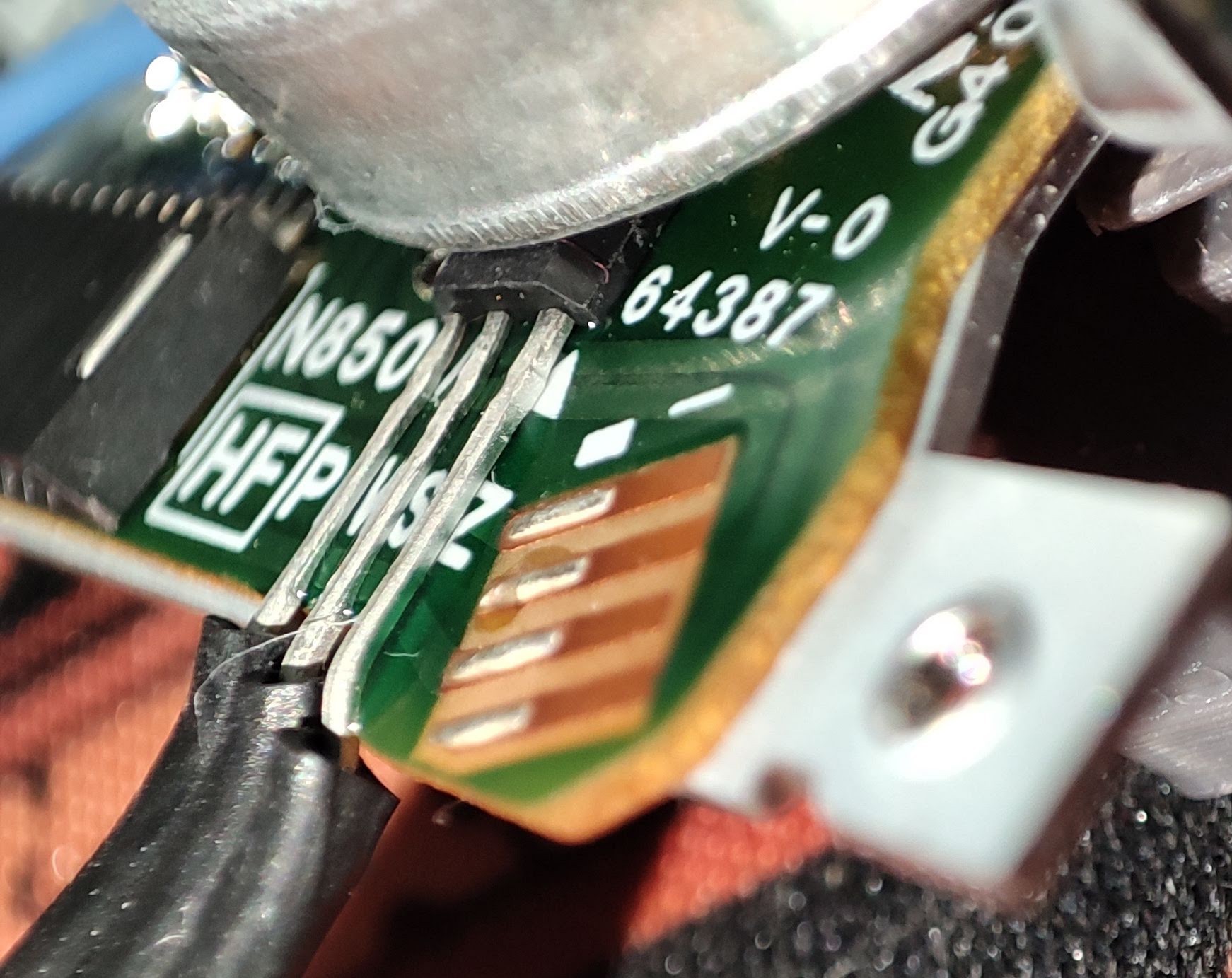

    I have a few 0.03ohm resistors lying around and I could use them for current sensing. But before that I wanted to try something that seemed more simple, adding a single Hall sensor. The DVD motors are fairly small and these A3144 through-hole Hall sensors are relatively thick as it turns out. I remembered how a few years ago some guy from Japan solved a similar problem with a Dremel.
    Said and done! I destroyed 2 or three before I realized that it's safe to grind away the backside, which is just the lead frame, but from the front side you can't take more than maybe 0.5-0.6mm. Fixed it with a drop of CA glue first, then reinforced the pins with UV resin (it's so transparent it's practically invisible in the photo).
