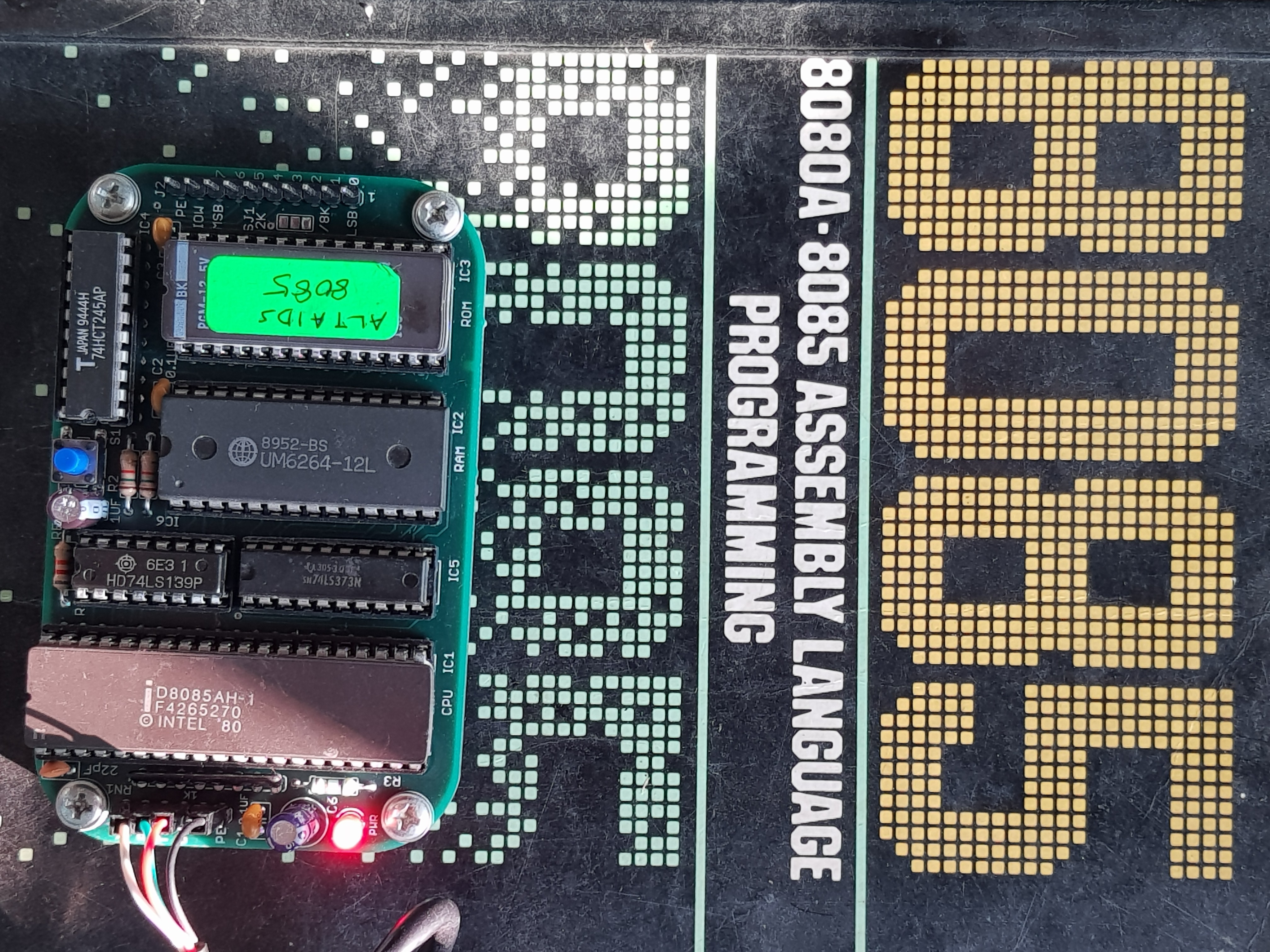

The board having only six ICs. Out of which three are just simple logic ICs.
There are only three main components in the design. Microprocessor, 8kB RAM and 8kB ROM. The computer operates at 4.9152MHz using external crystal. So it is very easy to make.
The good thing about this design is it comes with circuit, layout and monitor program. It fits into a Altoids tin. Due to small available space, the board was designed in four layers. But signals uses only TOP and BOTTOM layers and the inner two layers used as power planes which simplifies easy routing.
The technical article was published in march 2019 Nuts and Volts magazine. The 8085 computer was  sold as a kit and currently not available.
8085 computer - Components
As we see it uses very few components.
The assembled board looks like above picture.

The original design uses 8kB EEPROM 28C64 for ROM space. But I have used 8kB NVRAM DS1225 in initial testing.

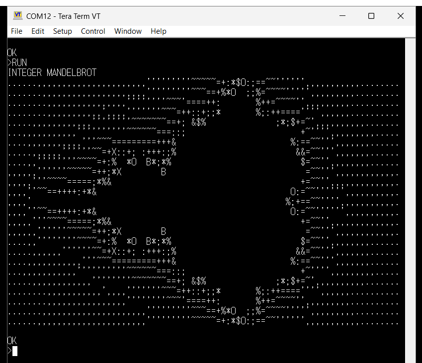

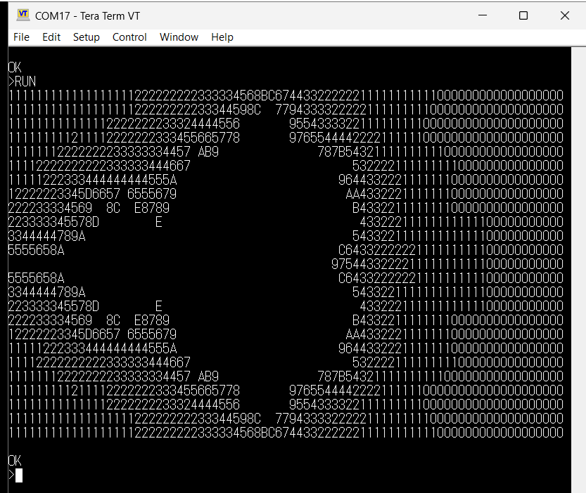

The real test for the computer comes when it performs Mandelbrot Set using tiny BASIC. I have tried 2 different tinyBASIC programs. Both of them took same time to complete the task.
Mandelbrot Set - 8085
Since tinyBASIC can perform only Integer arithmetic, the results are different from the same code used in floating point arithmetic capable BASIC interpreter or processors.

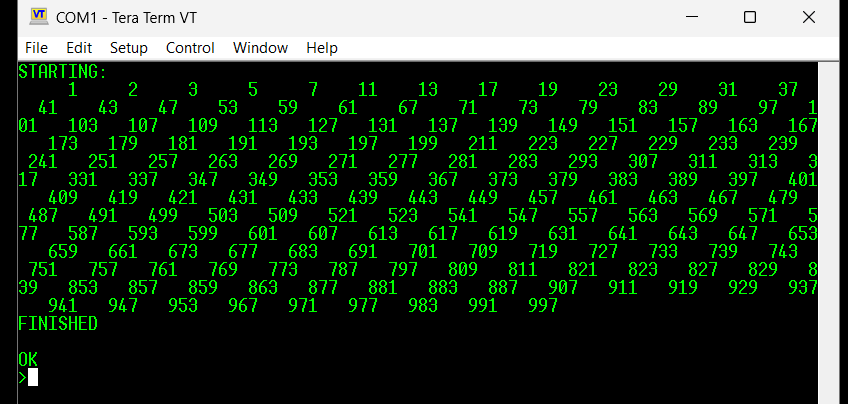

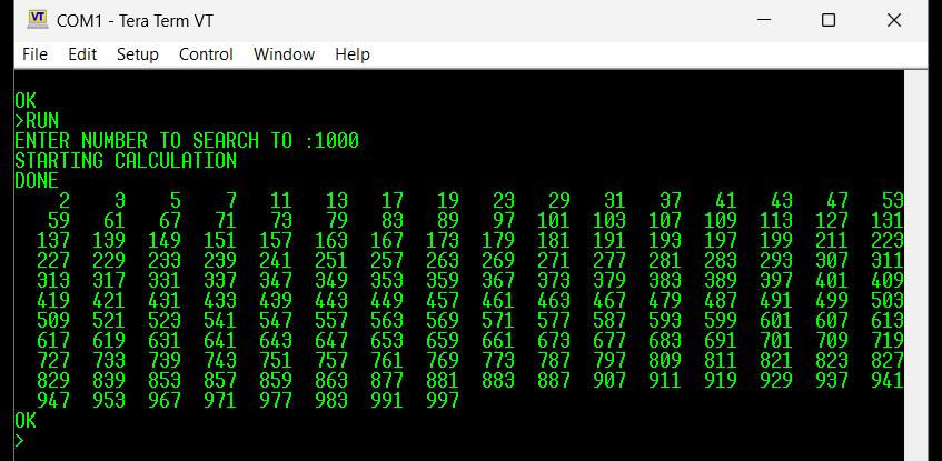

The 80C85 computer also performed good at finding the prime numbers. There are two different methods and time taken differs by algorithm. Below is the results for primes upto 1000.
2nd run with difference algorithm
the above one is much faster than the previous one.

It is a very simple and easy to build 8085 computer board. Both monitor and tinyBASIC are very useful and fun.
8085
8085 book + 8085 kit using PL2303 cable
OK
>RUN
 _____ _             ____    _    ____ ___ ____
|_   _(_)_ __  _   _| __ )  / \  / ___|_ _/ ___|
  | | | | '_ \| | | |  _ \ / _ \ \___ \| | |
  | | | | | | | |_| | |_) / ___ \ ___) | | |___
  |_| |_|_| |_|\__, |____/_/   \_\____/___\____|
               |___/
OK
