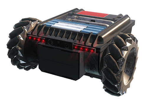

Obviously, the drone is not going to give downloads (because I have not put, things as they are, hehe). The pint that has it physically is this, so that you have an idea of what I want to implement:
| The Drone of Twich "really" |
As you see in the model, the drone is powered by two engines and has wheels that allow it to move sideways. It also has "infrared" leds and a camera system. In my implementation I will not use this type of wheels, because they are very expensive and the idea is that it is cheap to build. On the other hand, we are not going to use the infrared illuminators either (although it would have been easy to have a few LEDs). And of course, it does not give electric shocks.

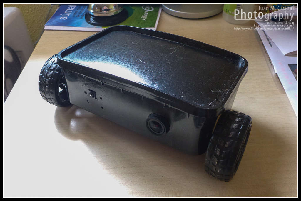

| Our TwichDrone. Close enough! |

You should mount the motors with the right polarity (see photos) and build a custom wiring to power the raspberry. Then, mount everything into the desired platform, connect all the things.
