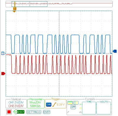

    New Logic program that logs ALL data from scope output with PORTMON
    THESE ARE NOT THE SAME OUTPUTS, JUST SOMETHING TO COMPARE VOLT/LOGIC
    Partial view from Parallax scope app
    Made a couple of basic parameters for the app named, Input Voltage Low (Vil) , Input Voltage High (Vih) , and finally Input Voltage (Vcc) variables. If the 30/70% of Vdd rule is exceeed the value is changed to a 1 or 0 giving a stepped logical view instead of scope type of view with little voltage spikes and dips.

    Here is a SS of the hex --> voltage chart. Simple pattern after the first .07. It is (5) .08 tehn a .07, all the way to the end.
    I am in the processing of putting togethor a simple VB.NET with zedgraph component to read the output from PORTMON and plot it on a graph and if time permits ultimatly automaticall decipher the I2C messages.
    App will be able to read the PORTMON data log file, look for the pattern of 55, data1, data2, AA and if all is valid (not more than 2 data sequences between the 55 and AA) output the data to a graph. The output captured from the scope is 50uS at 5V for both channels. Will also prob add in a logic mode that will use a couple of params at first to determine what is considered "HI" and "LOW" so it's not a voltage reference chart.
