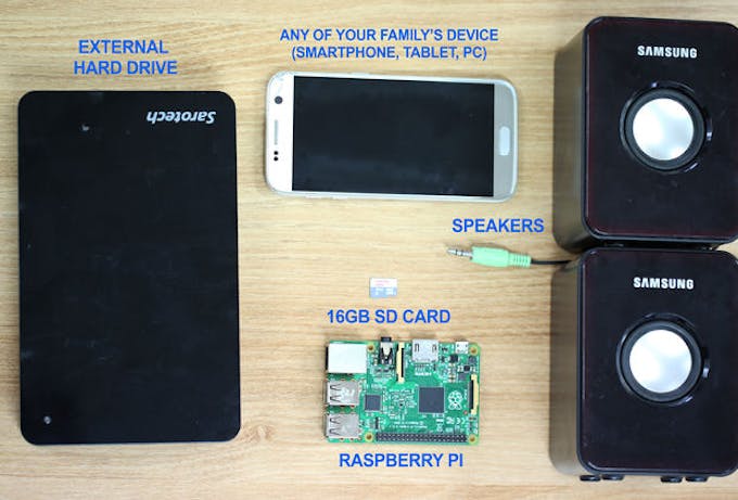

Step 1: NECESSARY COMPONENTS
- Raspberry Pi 2 or 3 // ~$10~$35
- 16 GB SD card // ~$8
- External hard drive
- Audio system with AUX cable
- Any device you might want to use to read your files (TV, tablets, smartphones, PC)
If you already have an audio system and an unused external hard drive (or a USB stick with significant storage space), you only need to buy a Raspberry Pi with a 16GB SD card (total <$40).

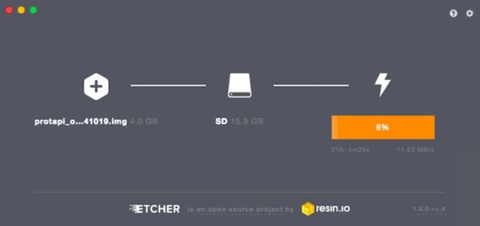

Step 2: SET UP PROTA OS ON YOUR RASPBERRY PI IN 15 MINUTES
Prota OS can be downloaded for free on https://prota.info/prota/pi/. It’s only 3.8GB and easy to burn on a SD card (make sure to use a 16GB card).
Follow the instructions of Raspberry Pi foundation to write the OS image on your SD card. Extract the .img file from the zip folderPlug in your SD cardDownload and open Etcher, select the image and the drive and start the process. That’s it!
Once Prota OS is burned on the SD card, you can follow this simple installation guide to set up your Prota hub (less than 1 minute!). You only need to define its name and password, your time zone and your email address and the rest is completely automatic!

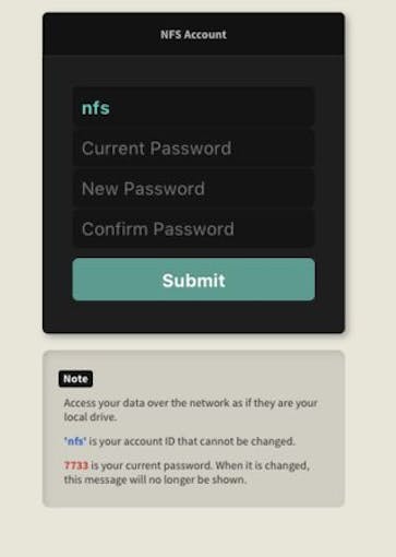

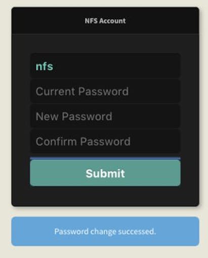

Step 3: USING NFS APP TO SET UP YOUR CLOUD SERVER
You can really easily turn an external hard drive or USB stick into a cloud server (or NAS) using the NFS app.
- Plug-in your storage device in a USB port of your Raspberry Pi
- Go to App Libraries in Prota Space
- Download the NFS app
- Open NFS app and change the password as explained on the interface. The current one is written in red.
- Make sure to note down your ID and password + the IP of your Prota (you can find it in Settings app)

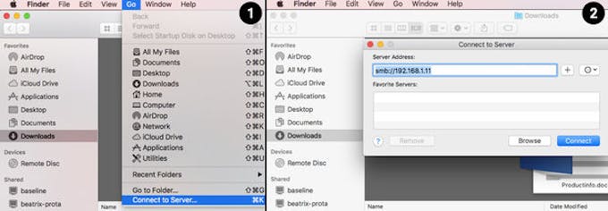

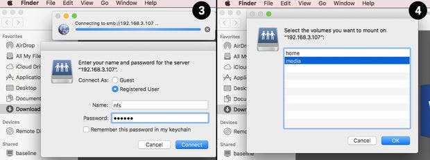

On macOS computers:
- Open Finder and click on Go > Connect to server (in the top bar)
- Type in smb:// + the IP of your Prota (you can find your Prota’s IP in the top left corner of Settings app in Prota Space)
- Select “media”
- Your name will be “nfs” and previously setup password
- Click on “connect”. You can now access the files on your USB stick/hard drive from Finder.

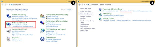

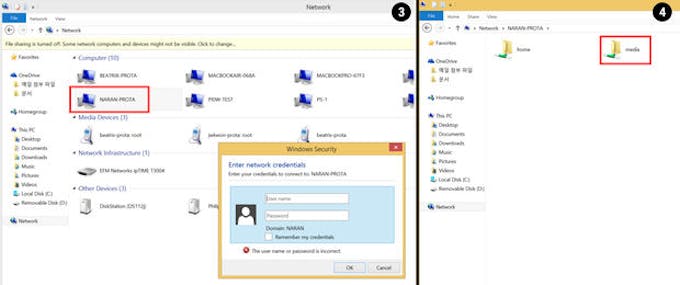

On Windows computers:
- Go to the Network menu of File Explorer
- The neighboring networks will start appearing. You should find in the list the name of your Prota Pi.
- Enter NFS as ID and the password you created on the NFS app
- Click on Media and you will be able to access the files on the USB stick

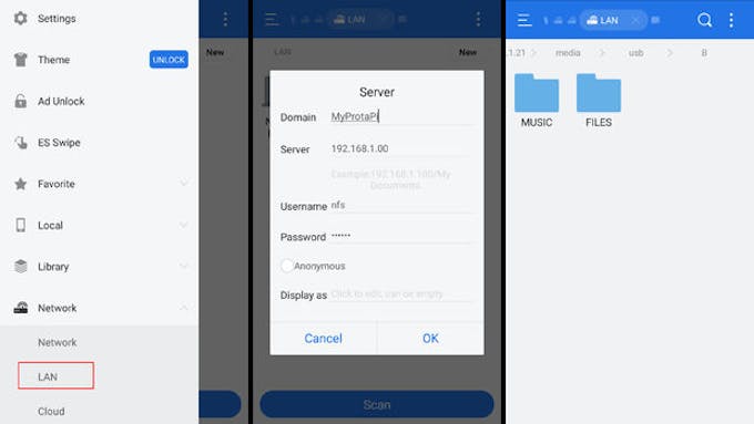

On Android smartphone/tablets:
- Download the app ES File Explorer File Manager
- Go to Network > LAN
- Click on the three dots and New
- Add a name, input the IP address of your Prota (you can find it in the top left corner of Settings app in Prota Space), the ID (“nfs”) and password of your NFS
- Click on OK and you will then have direct access to all your files

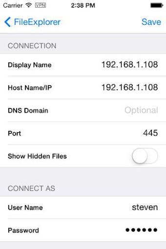

On iPhone/iPad
- Download the app File Explorer
- Tap the "+" button, then select "Computer, NAS" item.
- Input the IP address (you can find it in the top left corner of Settings app in Prota Space) and leave the DNS Domain field blank.
- Input “nfs” as username and the password you set previously.
- Click on Save
Your NFS server is now connected to your device and you can open remotely all your files, copy them or add new ones. It makes it very easy to access this server as the server folder is directly visible on the left side of your computer’s file explorer.

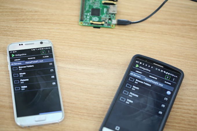

Step 4: USING DLNA TO OPEN AND VIEW FILES
Creating your NFS storage server will allow you to let all your family access the home cloud to open and view any file that you have put on it. It’s a great way to share photos, videos and movies with all the household members.
There are two possible ways for you to view and play those files on everyone’s devices. The first one is through apps like ES File explorer mentioned at the end of the previous step. An alternative is to use DLNA apps that you can easily download on all the devices at home (tablets, smartphones).
DLNA service aims at offering a common connected viewing experience on several devices. To use it on your home devices, follow those steps:
- Download DLNA app on App Libraries
- Download any DLNA app player on your device app store (for instance Ginkgo DLNA Player for Android or C5 for iOS)
- Look for your Prota on the nearby device list (your device need to be connected to the same WiFi network than your Prota Pi)

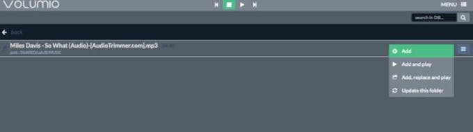

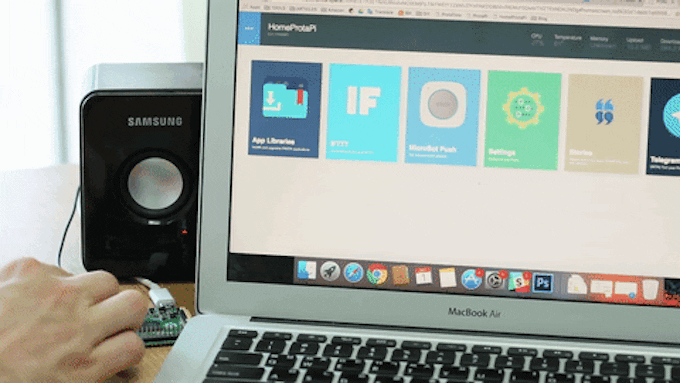

Step 5: CONNECT YOUR AUDIO SYSTEM VIA VOLUMIO
With Prota Pi, you can very easily transform any speaker into smart speakers that can be turned on remotely or play automatically you favorite songs based on pre-programmed playlists. It allows you to simply play all the audio files stored on your external hard drive, so no need to use a mp3 player or you phone and to connect it to your speakers.

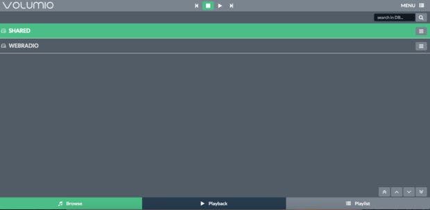

To use Volumio, follow those steps:
- Go to App Libraries and download Volumio app
- Open Volumio
- Click on the bottom left button “Browse”
- There you will be able to select the songs you want to play. Go to Shared, select your storage device, click on right side icon and add them to your playlist.
Now that your speakers are connected, you will be able to automate them depending on your presence at home or the time of the day. We will see that further in step 7.
