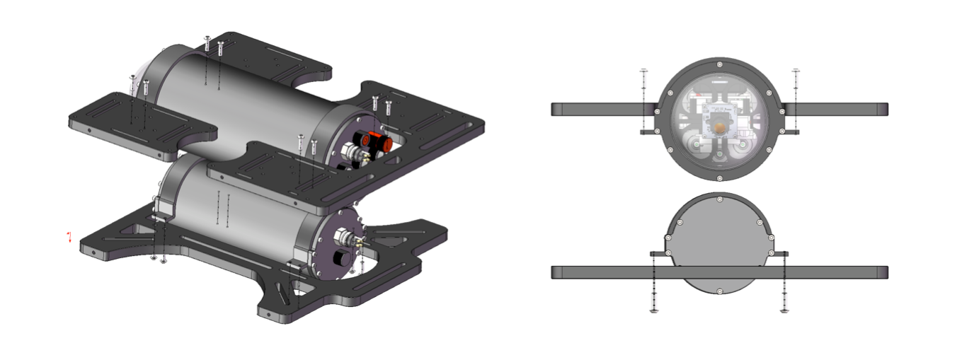

  • Watertight Enclosure
    shikang zhou10/17/2017 at 08:22 0 comments
    The watertight of underwater robots is very important. Tube and watertight enclosure are made of CNC aluminum.
    screws on the tube:
    3d rendering:
    The enclosure is traditional seal structure, it's easy to arrange the internal components. Edge has two enclosure, one for battery the other for electronic.
     SIZE: (Outer diameter x length ) 110x250 and 90x200mm.

    The Raspberry pi and pixhawk can be easily put in. We built an NI myRIO edition and an Intel Edison edition.
    looks like this:
     This image is the layout of another ROV we built.
    Dom end cap:
    enclosure clamp:
  • HDPE Frame
    shikang zhou10/17/2017 at 05:12 0 comments
    HDPE Frame
    After confirm the thruster's layout -- six thruster , vector arrangement , two for vertical ,four for plane , the overall structure is more obvious. The whole size is about 430x390x220mm.
    Frame includes 4 CNC parts to install watertight enclosure.
    The thickness of the plate is 12mm, it's strong and  suitable for underwater.
    photos:
