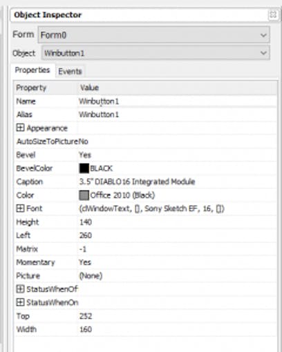

- You can edit the widgets in each form by using the Object Inspector.

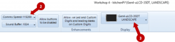

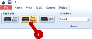

3Check the Project Settings
- After opening the project file, go to the Project menu and make sure that the Comms Speed and Display parameters are correct as shown below.

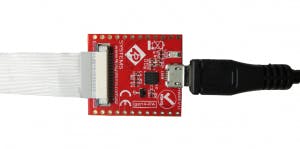

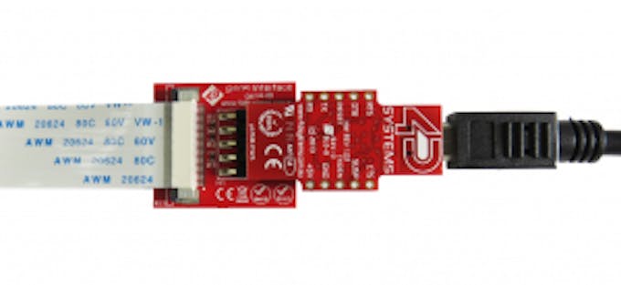

Connect gen4-uLCD-35DT to the PC
- Use gen4-interface board and uUSB PA-5 to connect the display to the PC as shown in the image below.
- Or if you have gen4-PA board, connect the display to the PC as shown in the image below. You can also use the gen4-PA board if you want to use its GPIO pins.

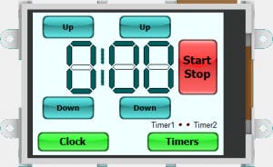

5Test the Visi-Genie Program
- Now unmount the uSD card from the PC and mount it to the uSD card slot of the gen4-uLCD-35DT. Winbutton widget should now appear on the display. It is now ready to receive commands from a host.

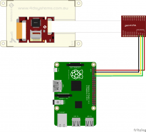

6Connect the Raspberry Pi to the uLCD-220RD
- Connect the 4D-Serial-Pi Adaptor to the Raspberry Pi, then connect the 5-way cable to the 4D-Serial-Pi Adaptor. Lastly, connect the other end of the 5-way cable to the gen4-IB of the gen4 module.
- Or you can interface gen4 module and Raspberry Pi with the gen4-PA using the image below.
