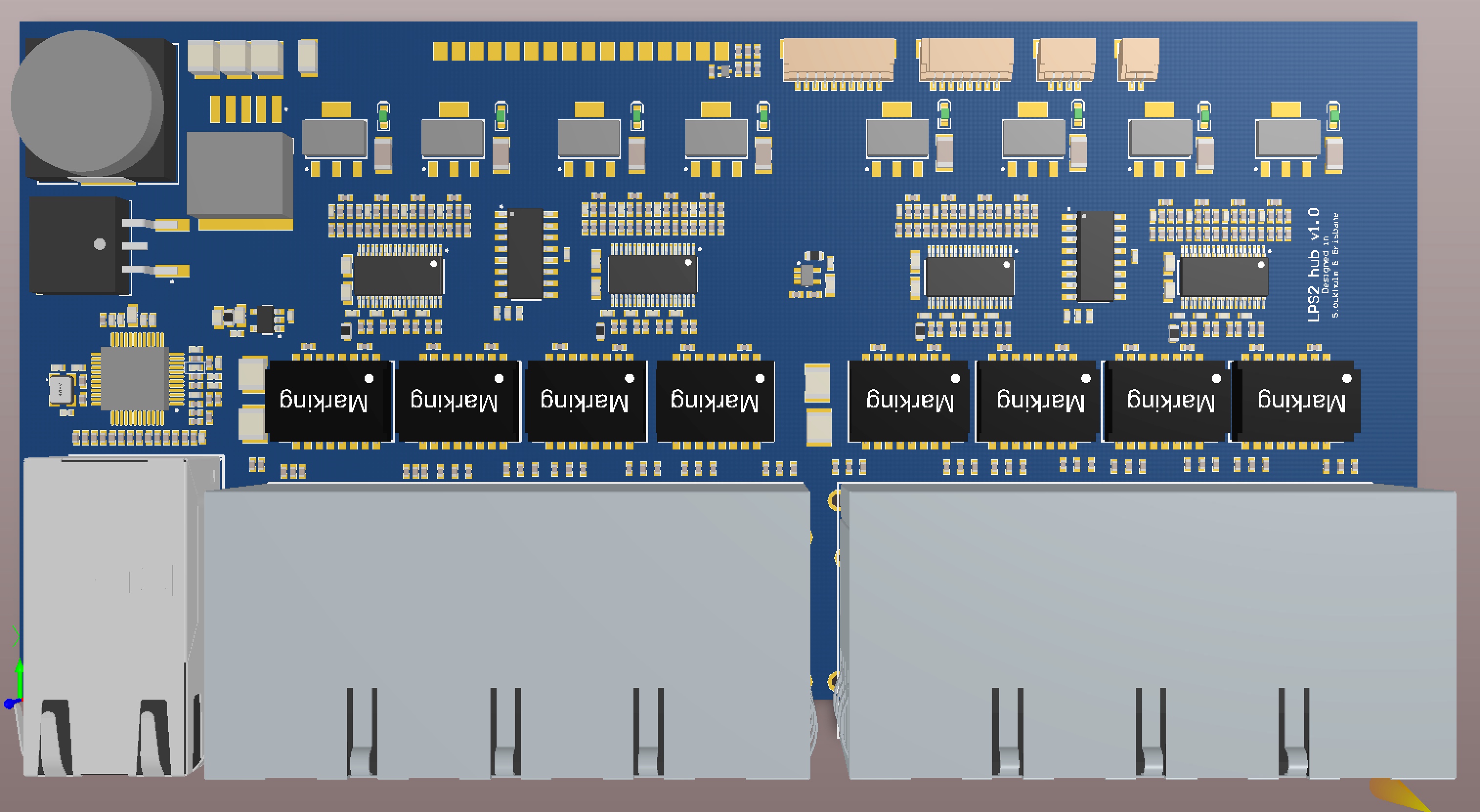

Wireless clock and sync distribution is very practical, but suffers from a time uncertainty on top of the location uncertainty (time and distance are just two sides of the same coin). This adds up to a 20 cm uncertainty, instead of the 10 cm achievable with TWR. This is good enough for many applications, but wired clock and sync distribution is needed in TDoA/RTDoA applications to get highest possible performance. We are working on a board called LPS2 HUB to inject clock, sync and PoE via pair 3 and 4 in up to eight CAT5 or CAT6 cables, while using pair 1 and 2 for 10/100 Mbit ethernet. Several LPS2 HUB boards can be connected to form large clock/sync distribution networks. Currently LPS2 HUB only exist in the CAD program, but we are working hard on producing the first prototypes:![]()
In the receiving CAT 5/6 cable end a board called LPS2 PCS (as in Power Clock and Sync) translates and provides our upcoming anchor LPS2 with ethernet, jitter cleaned clock, sync and PoE. LPS2 PCS has left the CAD stadium and exists as prototypes:![]()
LPS2 itself has left its prototype stage and is currently being produced.

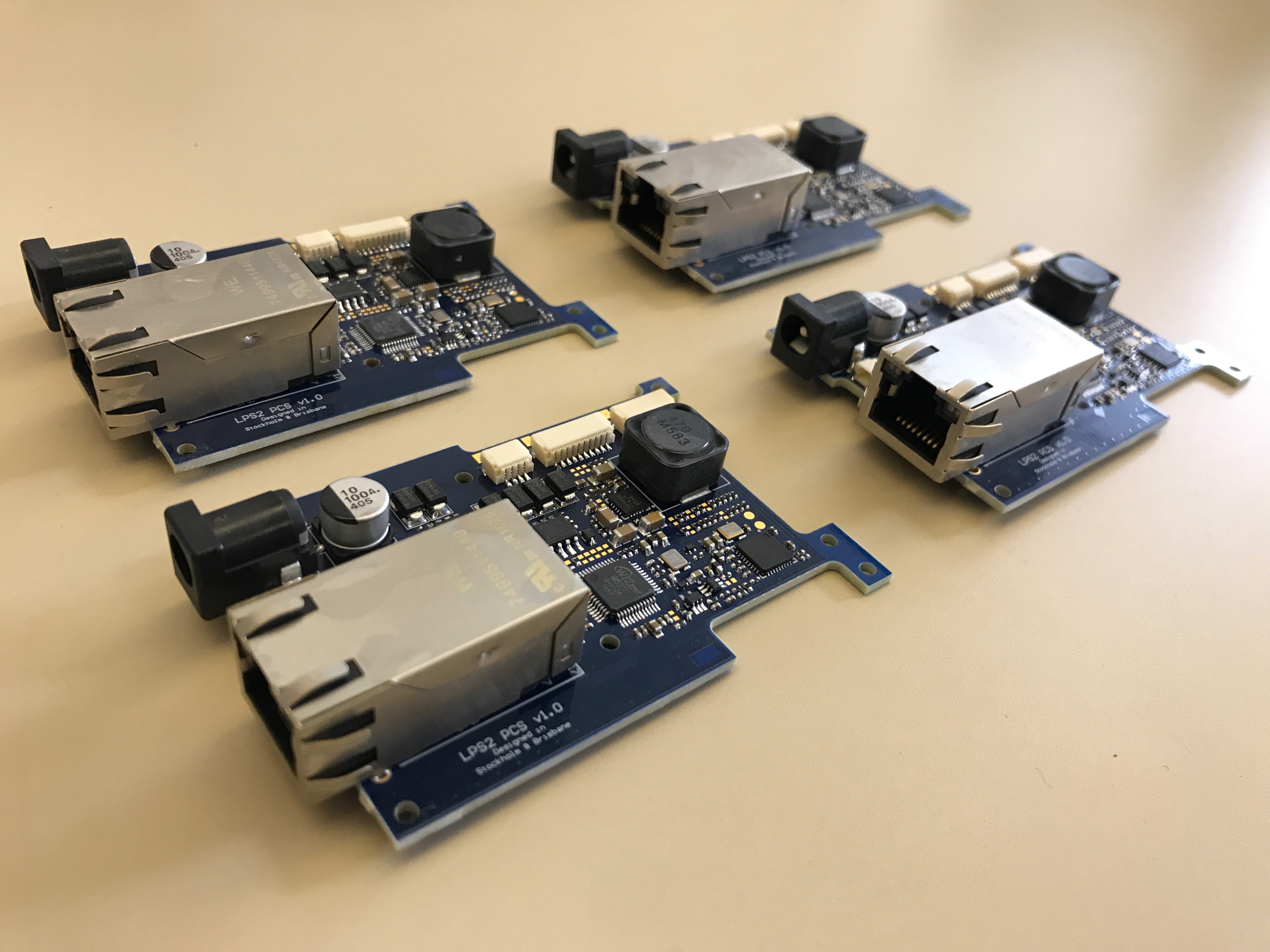

LPS2 PCS in production!
04/11/2017 at 08:09 • 0 commentsThis is how LPS2 PCS turned out:
http://www.loligo.se/LPS2_PCS.wmv
Here in red together with LPS2:
http://www.loligo.se/LPS2_PCS_with_LPS2.wmv
The first hand built prototypes will be ready in 1-2 weeks. Next up is designing HW for the clock and sync distribution network. LPS2 PCS is just the endpoint.
LPS2 PCS preview
04/03/2017 at 12:12 • 0 commentsHere is a preview of our upcoming LPS2 PCS board (PowerClockSync). It is intended as an add-on to LPS2 with the following features:
* Power supply via PoE or wall adapter.
* Ethernet (10/100 Mbps) as a complement to the optional WiFi on LPS2.
* Receiver for clock and sync via spare twisted pairs in the ethernet cable.
* Jitter cleaner for received clock.
