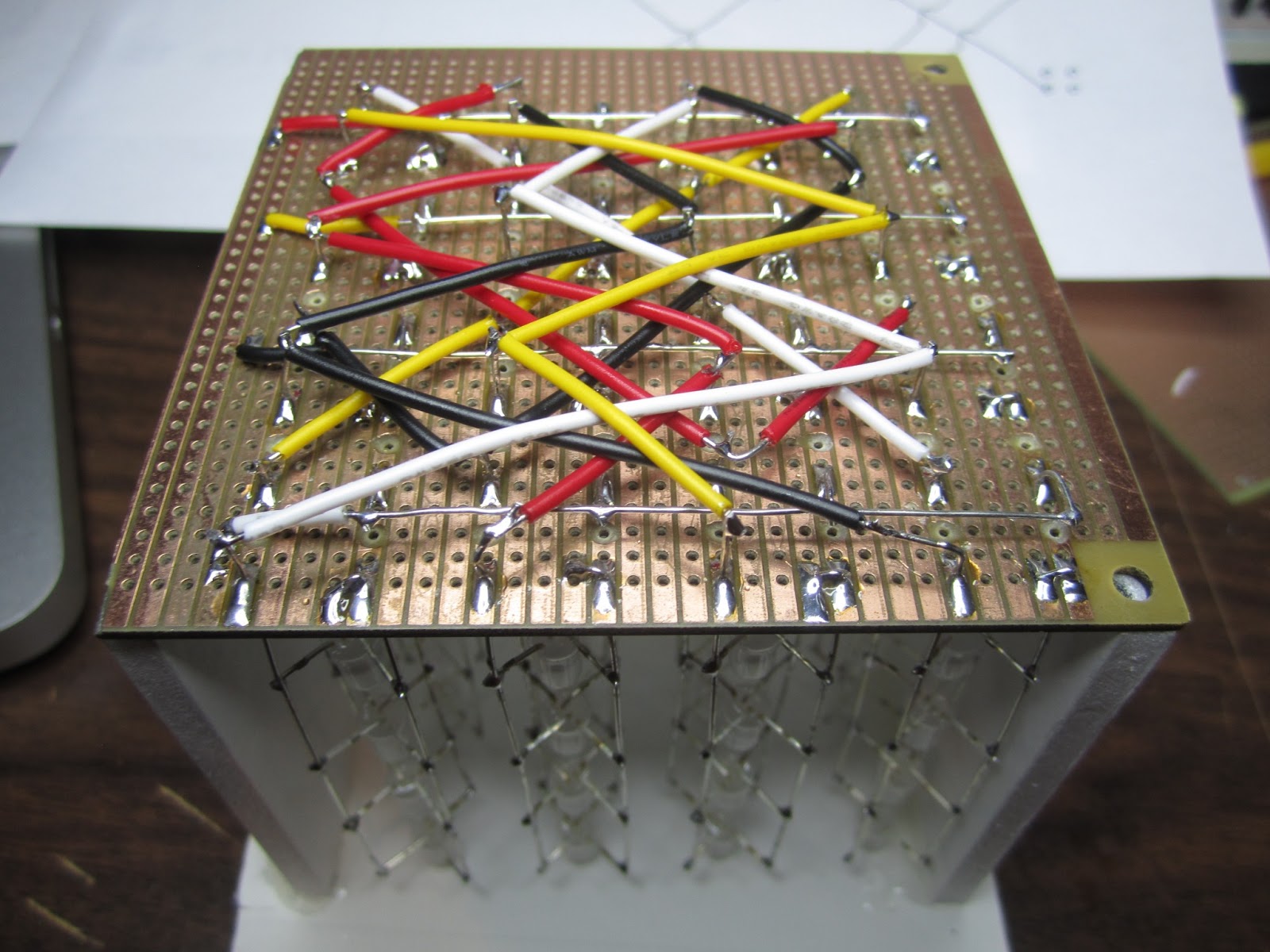

After countless iterations... ok 15 :-) I finally decided that it was time to send in the custom PCB file to be actually manufactured.
Ironically, I ended up relying on the Autorouter to complete about half of the routing.
Although I've played with EagleCAD before, this is my first serious attempt to master it. After many days, it no longer feels like I'm holding a paintbrush with boxing gloves. But I'm far from having a direct connection between my brain and the canvas. If you have tips for me, I'm all ears.
The cube is connected to the Arduino via 16 I/O pins. Although I would like to design ONE multi layer PCB, the free version of EagleCAD only allows for two copper layers (top and bottom). Furthermore, because everything is so small, I only have room for one via or two traces between the LED pillar leads.
I was able to put the first eight wires on one PCB:
The next four wires on a second PCB:
And finally the last four wires are on a third PCB:

I saw that you've built a Charliecube as well. I'm still amazed how a it's all done without shift registers!
Cool enough to make me get off my butt and get on hackaday . Seriously small solder work there man . Looks like you laser cut the solder jig too . Nice.
Thanks Scott. It is crazy small. I've gone through several iterations of laser cut jigs. I'll share more when I make a video. I've proven that I can make the LED pillars. The next challenge is how to wire the charlieplexing under the PCB. It was a nightmare at normal scale... After brainstorming at my local makerspace, we came up with two possible solutions: 1. Custom multi-layer PCB. 2. multiple layers of lasercut "plates" with holes to thread the wires.
