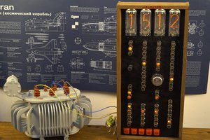

To modify the meters for 3.3 Volts, I unscrewed the case and found a fixed resistor and a POT in series with the input terminal.
Since the meters were build for 10 Volts full-scale deflection, I used a fixed resistor value approximately 1/3 of the original one.
Then I connected a DC voltage source set to 3.3 Volts and adjusted the POT until I had full-scale deflection.
You can get all three boards as a kit here: https://www.tiny-circuits.com/tiny-duino-basic-kit-171.html
Alan Kilian
suedbunker
Charles van Den
Thank you for the code - appreciate it :)
