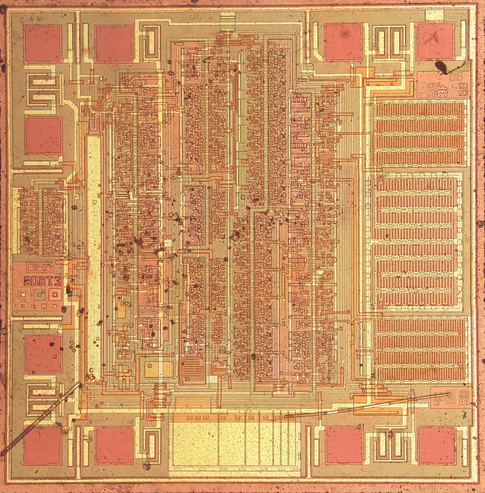

  • Teardown of a real watch
    Yann Guidon / YGDES • 06/07/2018 at 23:28 • 0 comments
