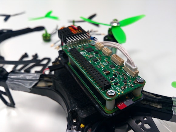

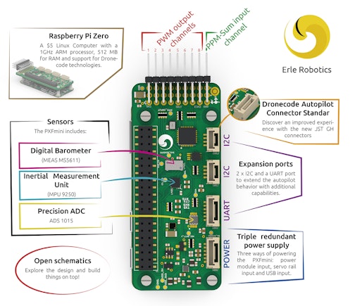

Connect the PXFmini shield on top of the Raspberry Pi Zero as described in the following image:
The PXFmini (stands for PixHawk Fire Cape mini), a 69€ autopilot shield for the Raspberry Pi to build robots and drones.![]()
You're almost done but you still need to get the right software on the Raspberry Pi Zero+PXFmini set. This should include the flight stack, an appropriate kernel, enabled daemons that auto-launch on boot, and additional goodies...
Fortunately, if you purchased the PXFmini from Erle Robotics you'll get access to their Debian images which include all this so just fetch a PXFmini compatible Debian image and flash it into a microSD card.
Step 3: Mount the autopilot
Required time: 5 minutes
PXFmini mounted on top of the Raspberry Pi Zero assembled in the droneMounting the autopilot (Raspberry Pi Zero + PXFmini) in the drone can be done using several methods. Pick yours and connect the JST GH cable from the power module to the PXFmini. This will to power the autopilot when the battery gets connected.
Next is mounting the PWM channels in the autopilot. Get your ESC cables and connect ESC 1 (corresponding with motor 1) to PWM channel 1, ESC 2 to PWM 2 and so on.

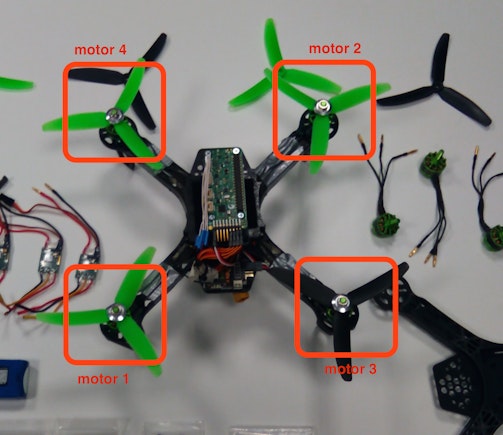

Step 4: Mount the propellers and get it flying!
Required time: 15 minutes
There's two kinds of propellers clockwise (marked with an "R") and counter-clockwise. Place the clockwise propellers in motor 3 and 4 and the counter-clockwise ones in motors 1 and 2.
