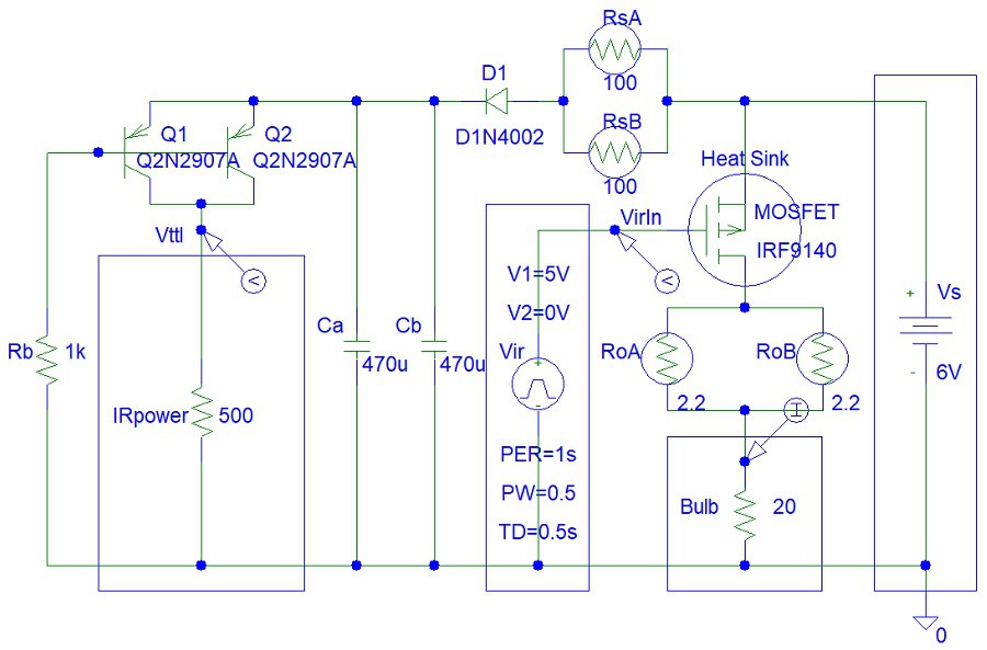

Step 1: Design the Circuit
I used the old PSpice software to quickly draw my circuit:
Nowadays there are IR receivers that can work with a power supply voltage between 2.5 V and 9 V, or even 20 V. Thus the diode and transistor power supply are optional. Also, modern IR receivers have higher bandwidth and can thus receive higher frequency signals.

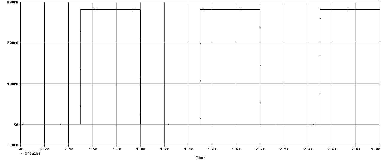

Step 2: Simulations
The TTL power supply:
The light bulb is receiving 300 mA current that it needs:

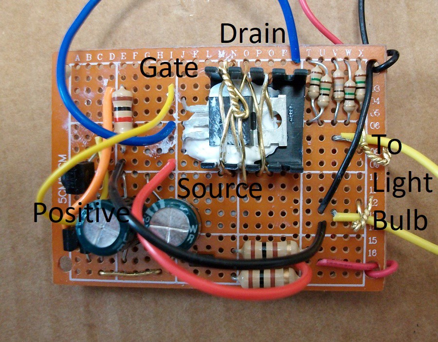

Step 3: Make the Circuit
You can see the big MOSFET transistor with attached heat sink:
I did not have high-power 2.2-ohm high power resistors. Thus I used an alternative. You can replace the 2.2-ohm resistors with a short circuit. However, this will reduce the life time of the MOSFET.
