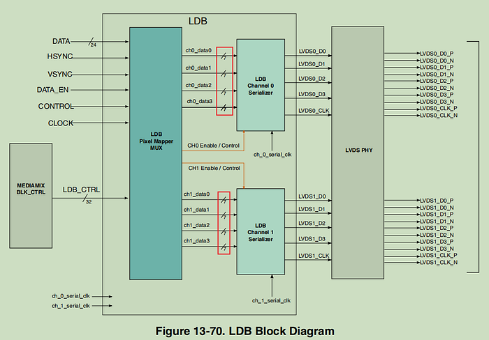

A Porting Solution for a 8-Channel Output LVDS Display on the 8MP Platform with Android 11
08/23/2024 at 03:18 • 0 commentsFor example, porting 8-channel output LVDS display with a resolution of 1024x768, a clock of 65MHz, and a refresh rate of 76.
Kernel Stage Modifications
1. Modify screen parameters in device tree
vi vendor/nxp-opensource/kernel_imx/arch/arm64/boot/dts/freescale/OK8MP-C.dts
Locate the lvds0_panel node and update the screen parameters and clock settings:
These settings include screen resolution, front and back porch, and clock. The system calculates the refresh rate based on these variables, so accuracy is crucial. Small deviations are allowed, but they should not be excessive. The calculation formula is as follows:
clock-frequency= fframe*(hfront+hback+hsync+xres)*(vfront+vback+vsync+yres)
Eg.:65000000=76*(34+20+1024+2)*(4+10+768+5)
2. Remove clock limitations in U-Boot stage
vi vendor/nxp-opensource/kernel_imx/drivers/gpu/drm/imx/imx8mp-ldb.c
Comment out the relevant restriction.
3. Calculate the clock and modify it according to the actual situation of the ported screen
(1) vi vendor/nxp-opensource/kernel_imx/drivers/clk/imx/clk-imx8mp.c
