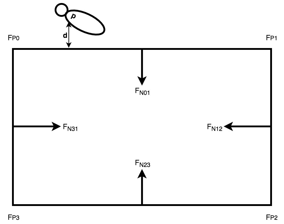

Step 3 - Find which sides of the boundary we are outside:
First we calculate the fence normal vectors (Fn) for each side, such that the normal always points towards the inside of the boundary, and make sure it is unit length by dividing by the magnitude of the vector.double distBehind(struct position p, struct position w, struct position v){ //Returns a negative if outside that boundary. double Fplat =w.lat; double Fplon =w.lon; //Calculate the unit length normal vector: Fn double Fnlat = w.lon-v.lon; // y' double Fnlon = - (w.lat-v.lat); //-x' double mag=sqrt(sqr(Fnlat)+sqr(Fnlon)); Fnlat /= mag; //Unit length Fnlon /= mag; //p-Fp Fplat = p.lat- Fplat; //Reuse variables Fplon = p.lon - Fplon; //Return the dot product return Fplat*Fnlat + Fplon*Fnlon; }
Then we find the vector of the animal p to a point on that side of the fence. We then use the dot product of these two vectors to find the d. This can then be used to determine the approximate distance to each side the collar (p) is by multiplying by 100,000. If the value of d is negative then it is outside that side of the boundary.

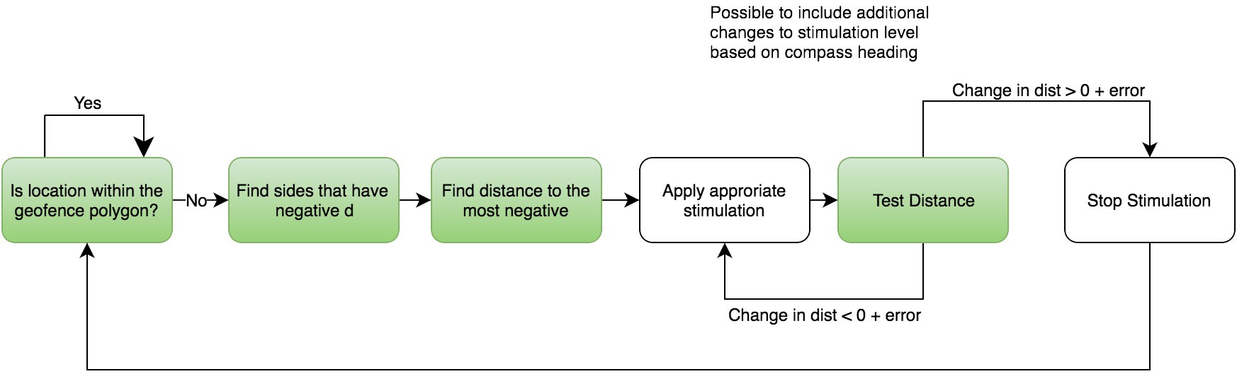

Step 5 - Combine:
Green boxes have been covered in this log and have been tested both on the computer in the attached C code and walking around on an oval with the functions running on an Arduino with GPS. -
