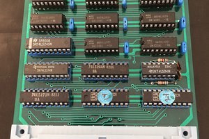

The concept of this project is so simple that I can not imagine why do a similar project haven't appeared in a form of a product during the golden era of Atari, when TTL chips were not so cheap.
Three bankswitch schemes are implemented: F8, F6 and F4 selectable by pins on the output connector. Then a new game is simply a ROM with one or two wire connections to select the proper bankswitching schemes.

By using two configuration pins it is possible to force the levels of address lines 3 and 1 at the input of the bankswitch register in order to select the desired scheme. By forcing A3 and A1 it is possible to use the F8 scheme (8K). For 16K games A1 is kept constant and the bankswitch is the F6. At last, if neither A3 nor A1 is selected the F4 bankswitch enables the use of 32K games.
Schematic:
The schematic of the bankswitch is on the picture below. Notice the delay RC network from the output decoding to the address latch as well as the reset circuit on the /CLR pin of the LS174.
Bankswitched cartridge connector:
The bankswitched cartridge connector inherits the pinout of the original cartridge but has some extra pins for the extra address lines A12~A14 as well as a pre inverted A12 (Chip select). It has also two bankswitch selecting pins.

  • Hand Routed PCB
    danjovic • 09/03/2016 at 19:24 • 0 comments
    I've just routed the PCB for the bankswitch cartridge. The routing was manually done and it took some time to optimize the disposition of the TTLs as well as the pins and gates of the NAND and NOR chips so the board can easilly be built at home (or in cheap PCB manufacturing services). All tracks are 16 mils and no unnecessary via have been used.
    There are still some room for improvement ,though.
