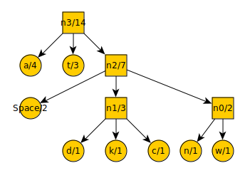

By starting at the top, you can count every leftward motion as a -, each downward motion as a 0, and each rightward motion as a +. This gives you the code-word for each symbol. The symbol “a” is encoded into the code-word “-”. The symbol “n” is encoded into the code-word “++0”.
Let’s say that the message had been “Attack at dawn”. The period at the end is omitted, so now there are an even number of items on the list:
n = 1
w = 1
d = 1
k = 1
c = 1
space = 2
t = 3
a = 4
We would only remove two items from the list, place a new node over them, and add that node to the list. Here is the tree:
And here is the new list:
d = 1
k = 1
c = 1
n0 = 2
space = 2
t = 3
a = 4

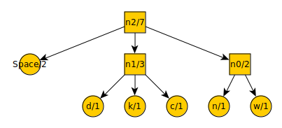

Notice that n0 has a value of only 2 in this instance. In the previous example it had a value of 3.
We now remove the three lowest value items from the list (the removal of two items is only done the first time). Here is the tree:
n0 = 2
space = 2
n1 = 3
t = 3
a = 4
The tree after another iteration:
And the new list:
t = 3
a = 4
n2 = 7
Remove the final items from the list and add them to the tree:
If we assume that each letter took 6 trits (which is just a bit more data than 8 binary digits), the total message would have been 84 trits long. The new compressed message reads as: -00-+++++0+--0+-++--++0++-. This is only 26 trits, a savings of 31%. If the difference between letter frequencies had been more pronounced, the savings would be greater.
