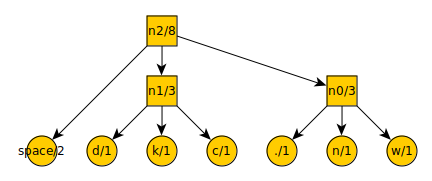

    We repeat the procedure of removing the three lowest value items from the list, placing a new node over them, and putting the new node on the list. Our ternary tree now looks like this:
    And our new list looks like this:
    space = 2
    n0 = 3
    n1 = 3
    t = 3
    a = 4
    After another iteration…
    The list now contains:
    t = 3
    a = 4
    n2 = 8

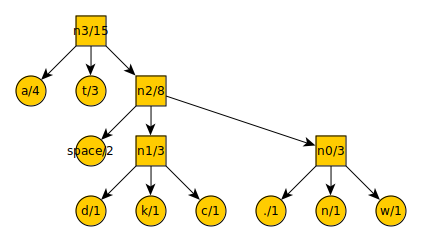

    And finally:
    By starting at the top, you can count every leftward motion as a -, each downward motion as a 0, and each rightward motion as a +. This gives you the code-word for each...
