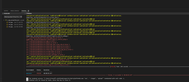

Hello Vitaly. Interested in pash project . I decided to repeat it, but there were difficulties with downloading the firmware of the microcontroller. I used Visual Studio Code when filling it gives the following message.
crazoff8:16 AM
* Executing task: C:\Users\Crazoff\.platformio\penv\Scripts\platformio.exe run --target upload
Warning! `src_build_flags` configuration option in section [env:emulator] is deprecated and will be removed in the next release! Please use `build_src_flags` instead
Warning! `src_filter` configuration option in section [env:emulator] is deprecated and will be removed in the next release! Please use `build_src_filter` instead
Warning! `src_filter` configuration option in section [env:hardware_stlink] is deprecated and will be removed in the next release! Please use `build_src_filter` instead
Processing emulator (platform: native)
Verbose mode can be enabled via `-v, --verbose` option
LDF: Library Dependency Finder -> https://bit.ly/configure-pio-ldf
LDF Modes: Finder ~ chain, Compatibility ~ soft
Library Manager: Installing Embedded Template Library @ ~18.3.2
Warning! Could not find the package with 'Embedded Template Library @ ~18.3.2' requirements for your system 'windows_amd64'
Found 2 compatible libraries
Scanning dependencies...
Dependency Graph
|-- lvgl @ 6.1.1
|-- lv_drivers @ 6.1.1
| |-- lvgl @ 6.1.1
Building in release mode
Compiling .pio\build\emulator\hal\sdl2\app_hal.o
"g++" \xad\xa5 \xef\xa5\xe2\xe1\xef \xa2\xad\xe3\xe2७\xad\xa5\xa9 \xa8\xab\xa8 \xa2\xad\xa5譥\xa9
\xaa\xae\xac\xa0\xad\xa4\xae\xa9, \xa8ᯮ\xab\xad塞\xae\xa9 \xafணࠬ\xac\xae\xa9 \xaa8\xab\xa8 \xaf\xa0\xaa\xa5\xe2\xad\xeb\xac 䠩\xab\xae\xac.
Compiling .pio\build\emulator\src\app.o
Compiling .pio\build\emulator\src\doses.o
Compiling .pio\build\emulator\src\fonts\my_font_icons_18.o
Compiling .pio\build\emulator\src\fonts\my_font_roboto_12.o
"gcc" \xad\xa5 \xef\xa5\xe2\xe1\xef \xa2\xad\xe3\xe2७\xad\xa5\xa9 \xa8\xab\xa8 \xa2\xad\xa5譥\xa9
Compiling .pio\build\emulator\src\fonts\my_font_roboto_14.o
Compiling .pio\build\emulator\src\fonts\my_font_roboto_num_18.o
Compiling .pio\build\emulator\src\screen_dose.o
Compiling .pio\build\emulator\src\screen_flow.o
Compiling .pio\build\emulator\src\screen_settings.o
Compiling .pio\build\emulator\libc67\lvgl\lv_core\lv_debug.o
Compiling .pio\build\emulator\libc67\lvgl\lv_core\lv_disp.o
*** [.pio\build\emulator\hal\sdl2\app_hal.o] Error 1
*** [.pio\build\emulator\src\app.o] Error 1
*** [.pio\build\emulator\src\doses.o] Error 1
*** [.pio\build\emulator\src\fonts\my_font_icons_18.o] Error 1
*** [.pio\build\emulator\src\fonts\my_font_roboto_12.o] Error 1
*** [.pio\build\emulator\src\fonts\my_font_roboto_14.o] Error 1
*** [.pio\build\emulator\src\fonts\my_font_roboto_num_18.o] Error 1
*** [.pio\build\emulator\src\screen_dose.o] Error 1
*** [.pio\build\emulator\src\screen_flow.o] Error 1
*** [.pio\build\emulator\src\screen_settings.o] Error 1
*** [.pio\build\emulator\libc67\lvgl\lv_core\lv_debug.o] Error 1
*** [.pio\build\emulator\libc67\lvgl\lv_core\lv_disp.o] Error 1
========================== [FAILED] Took 4.17 seconds ==========================
Environment Status Duration
emulator FAILED 00:00:04.174
==================== 1 failed, 0 succeeded in 00:00:04.174 ====================
* The terminal process "C:\Users\Crazoff\.platformio\penv\Scripts\platformio.exe 'run', '--target', 'upload'" terminated with exit code: 1. * Terminal will be reused by tasks, press any key to close it.
Dependency Graph
|-- lvgl @ 6.1.1
| |-- lvgl @ 6.1.1
========================== [FAILED] Took 3.06 seconds ==========================
emulator FAILED 00:00:03.063
==================== 1 failed, 0 succeeded in 00:00:03.063 ====================
crazoff8:16 AM
