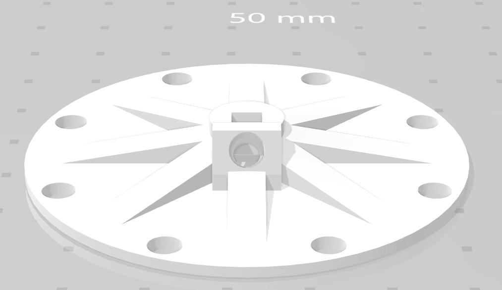

- disk with spokes developed by Lex
- a slightly modified thicker disk that may help prevent warping (noticing warping may be an issue with white resin but may not be an issue with clear resin - testing this again shortly).

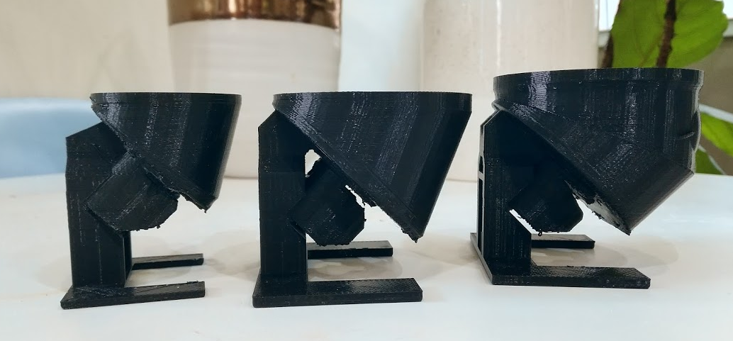

While the foot method works, it can crush pellets and create dust, which leads to pellet jams. The angled approach uses gravity to keep multiple pellets from aligning over the dispensing tube, thereby obviating the need for the foot. It creates much less dust and seems to be more resistant to jamming.
I went through three major revisions of the design, with the first version containing a pellet disk and hopper the same size as FED3. While this worked, the angled disk is less space efficient as it can only be ~1/3 filled with pellets or it risks dispensing multiples. So this design only fit ~150 pellets. I made two adjustments to increase the overall size of the device (version 2), and make it bulge out a bit at the bottom (version 3). Version 3 can fit >500 pellets without dispensing multiples. These are printed in PLA on a Sindoh 3DWox1 printer.
