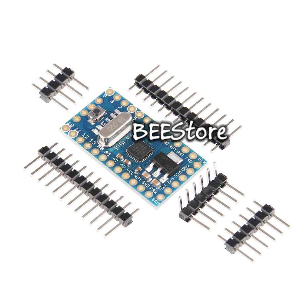

    1. Use an additional breakout board connected to the stack to power both the radio and the Arduino
    2. I found a version of the Arduino Pro Mini that has an LM1117 LDO with 800mA output
    Option 1 is possible because I've created a breakout board, called ProtoQube! I'm even selling it on Tindie. This will let me plug in a breadboard power adapter straight into the power bus of the stack, which will let me run everything.
    Option 2 will need a slightly different arduino adapter, because it seems to be different to the regular Pro Mini, plus they haven't arrived from China yet!

    In order to actually operate the radio, I need to connect it to an Arduino. I've made an adapter board for a 3.3V Arduino Pro Mini, which connects it to the PQ60 format board. I've added a couple of jumpers to select the power source, as the onboard 3.3V regulator won't power the QubeCast Max!
    I'll probably just use a breadboard power supply to feed 3.3V into the Vcc pin or the Arduino, and the 3.3V Bus pins on the PQ60 Connector.
