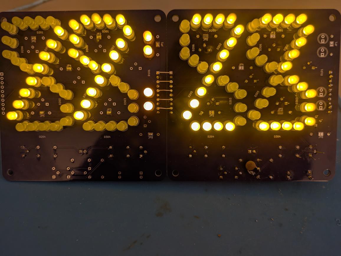

Looking at the board, I realise that pairs of digits are too close. The space between the 2nd and 3rd digit is alright. There are tracks for a colon there, but it doesn't work there.
I don't think this will displace the 7 segment font in use; that ship has already sailed. If anything I think the 14 or 16 segment displays are best and can also display the alphabet, but economics is against them
Another question is since I'm already using 6x4 = 24 LEDs, why not just go to 35 in a 5x7 matrix and then I can have a decent font? Good question. Well 50% more LEDs for one thing, and more drivers for another thing. But controllers are cheap enough to deploy one per array using multiplexing and accept serial input (SPI, I2C, etc), which could be 8 bit characters. Then cascade for more characters. Or just use those off-the-shelf 8x8 LED matrices.
So more than half a century later a very old project completed. 😹 I'll make displays with this font for novelty gifts, because it only takes a moment to grasp, then comes curiosity.
The board design files have been published at https://hackaday.io/project/175397-6-segment-2-digit-led-display-board
I might have a go at the 8 segment font some day.
  • Yet another tweak to the font
    Ken Yap • 02/02/2026 at 08:03 • 0 comments

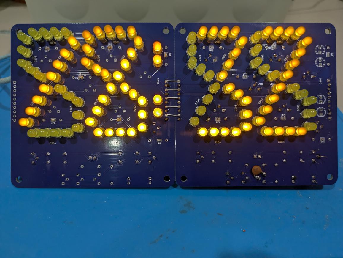

    I keep saying I'm done with this font, but I couldn't resist one more tweak. I added one more LED to make 5 for segments C and F, as the gaps due to the longer length of those segments detracted. This required a constant current circuit for the LED chains so the brightness would be uniform. Sorry about the lack of contrast in the photo, the time is 18:32. I really need to think of tinted perspex windows for the display. Ok, here's another photo with the ambient light dimmed.
    As a matter of interest, I had to use the long exposure feature of my phone as the camera can detect the LED multiplexing.
    There were the usual teething problems: a mistake in the pinout for the TL431, a missing feedback capacitor, one dud high side transistor, several bad solder joints, but I got it working.
    Unfortunately the half-height zero is irremediable. The only mitigation I could apply is to use the upper loop.
